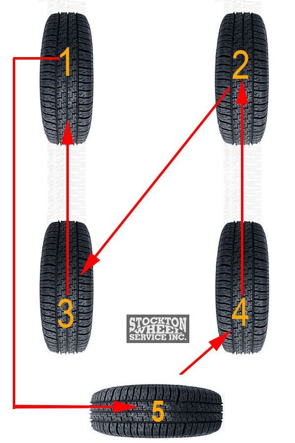

Since this thread is current, would anyone care to weigh in on how to effect a 5-tire rotation? In old school days, it was simple enough to swap any wheel to any position, but with today’s directional tires, and some marked inside/outside, I would like to hear how others are accomplishing this.
For my set of KO2 O follow the pattern for all wheel drive with full sized spare. Most tires are not directional.

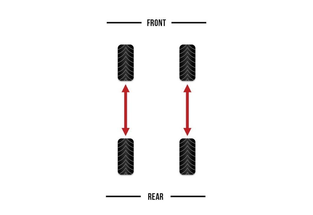

For my directional winter tires it’s just a 4 tire front to back pattern. No switching sides.
I only have 4 winter tires. One goodyear adventure is the spare.

Different strategy for me.
Spare is just that, a spare to get me to point where I fix the original and then spare goes on the back again.
So it stays 'new'. If I have to replace an existing tyre (unrepairable), I buy a new tyre to replace it and then also move the unused (new) spare to the opposite side and that used tyre then goes to spare.
That way I have 2 even used & new tires. And just rotate left to right or front to back but new & used always opposite each other.
