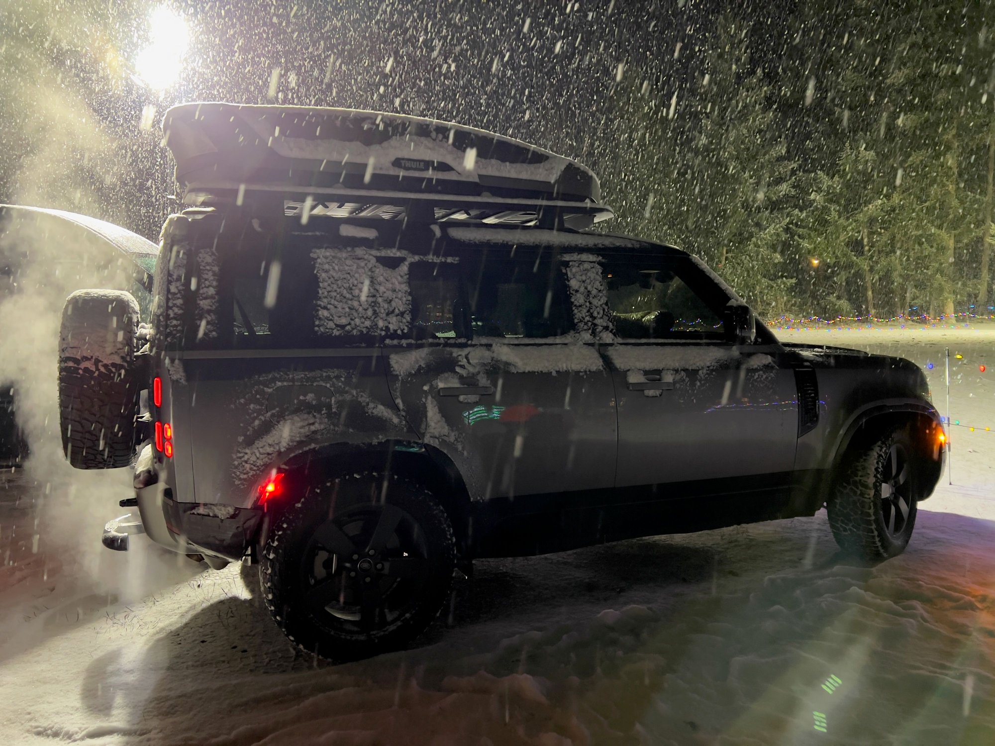

Not invincible but solid for sure, 275/55/20s, AT3W, terrain control on Auto
