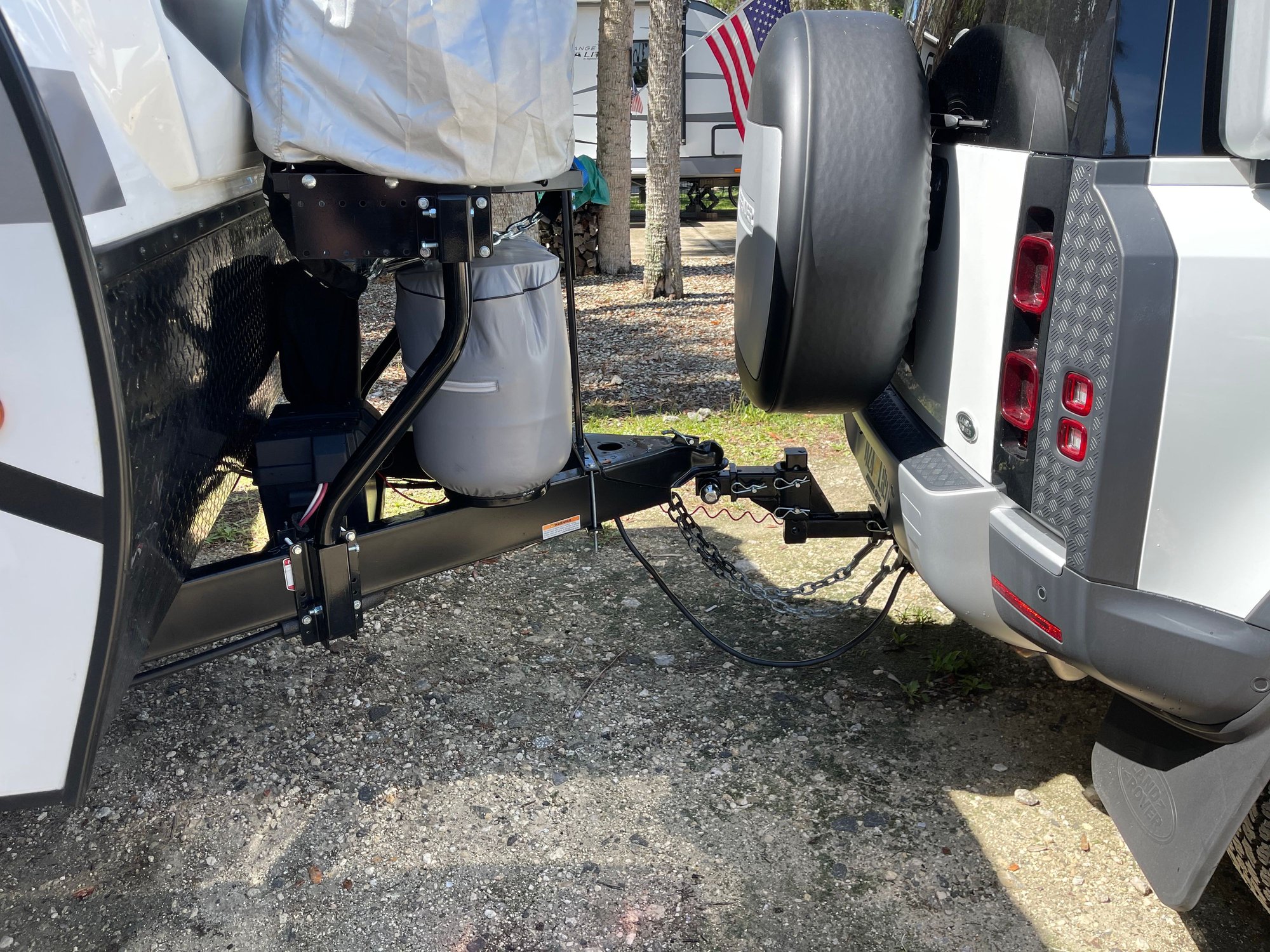

This is an absolute thrill to find out I’m not the only Defender owner towing a vintage trailer. I tow a ‘66 Airstream Safari. 22 foot, 3500 lb dry weight and 350 lb on the ball.
I initially pulled with my spare up top but on our first outing the old original Marvel coupler decided to give up the ghost. So we replaced this:
with this:
We gained four inches of tongue length plus set the jack hole back one inch. Works great with the spare mounted. I can nearly get to a full 90 degree jackknife. Still limited in rear hatch opening though so you have to plan your storage accordingly.

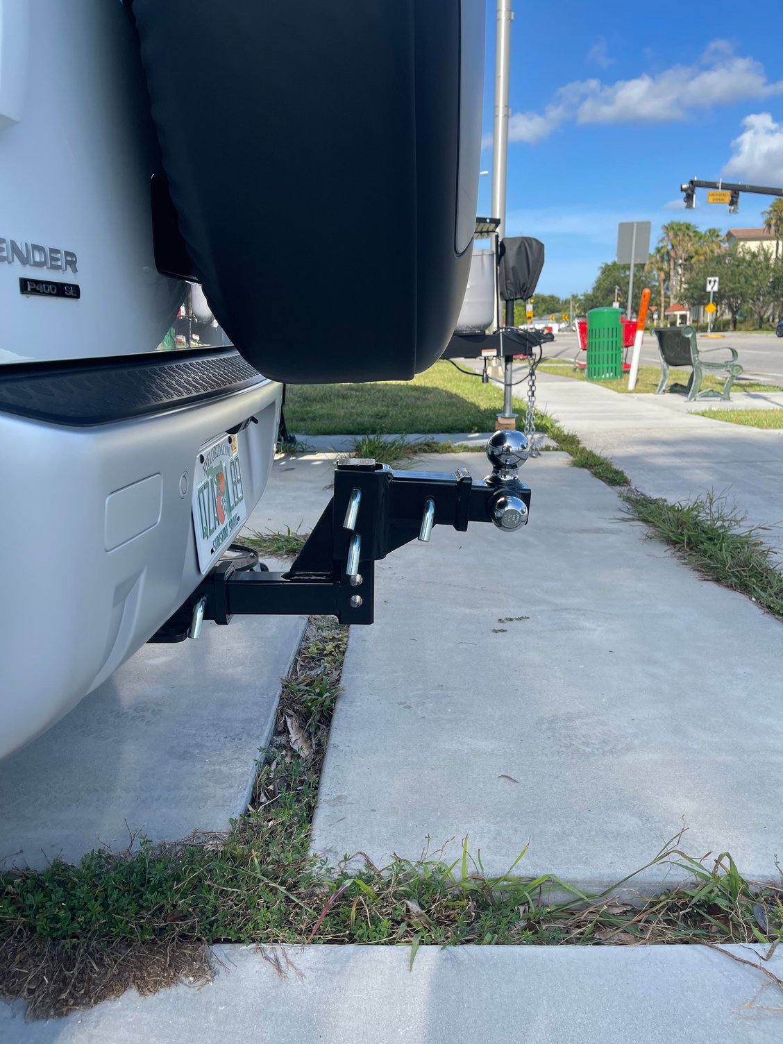

dont' modify your trailer, I use 12" mount but your built-in hitch guidance system will be useless. No problems, no sway, nothing.
Class 3 Ball Mount (2" Shank, 7,500 lbs., 2" Drop, 12-1/4" Long) SKU #45260 for $29.92 by CURT Manufacturing (curtmfg.com)
