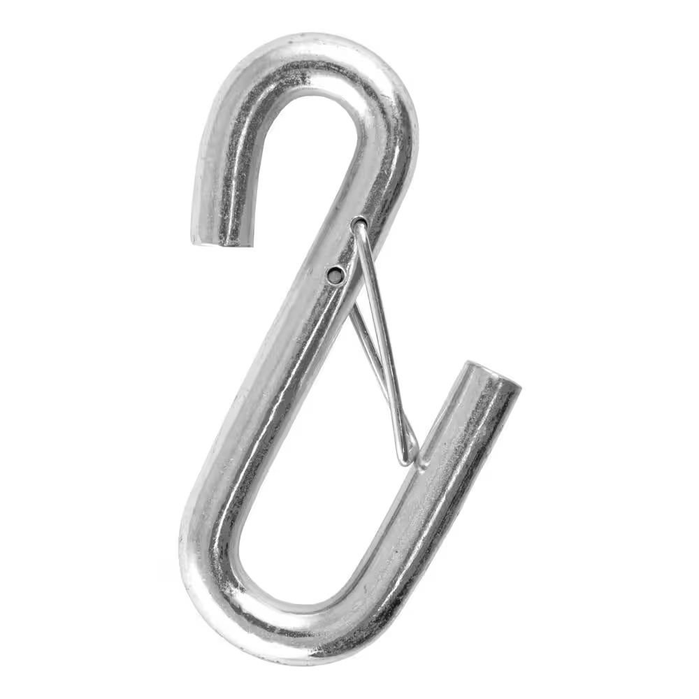

I’ve rented two U-haul trailers recently (and will probably in the future). Their safety chains have large hooks that are too thick to fit through the “holes” in our hitch. How have others dealt with this? Do I simply ream out the holes a little bit so the hooks can pass through?

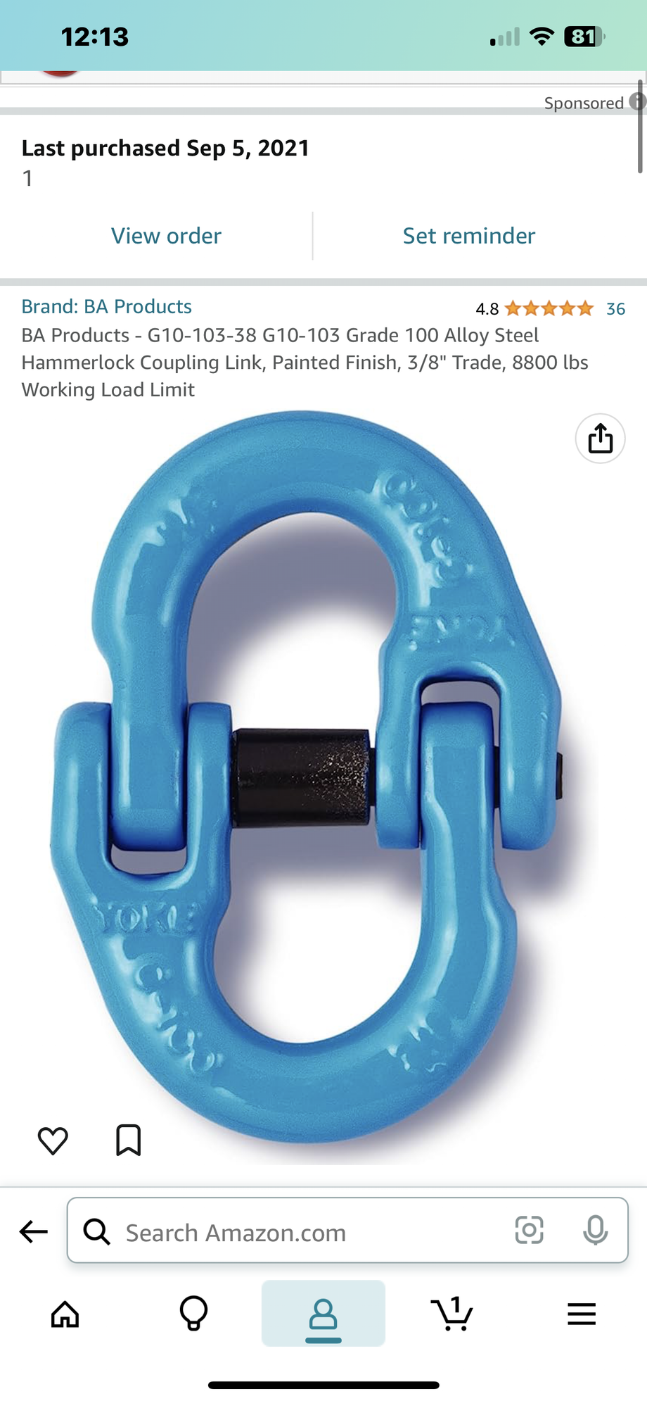

Default Hammer locks
