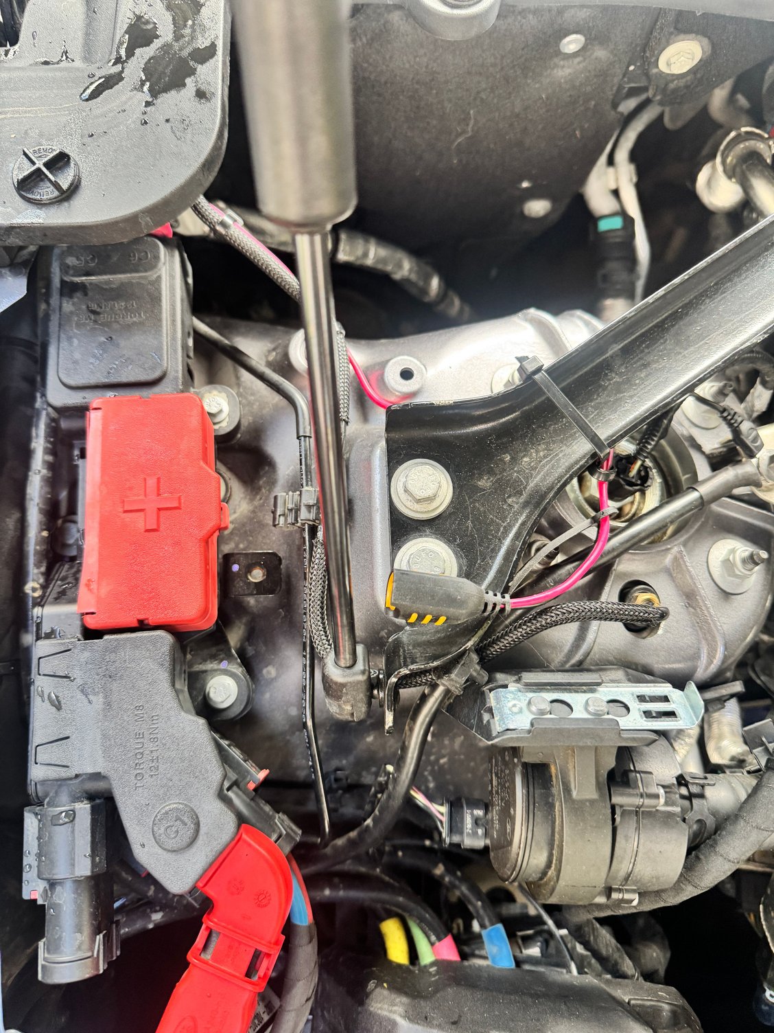

+ connection (I already had the fuse in here from my winch install so it was easy for me...) You really don’t need a fuse for the batt charger, you could just put it on either bolt on the right of this pic in theory, but a fuse is probably a better idea.. now that I think about it.

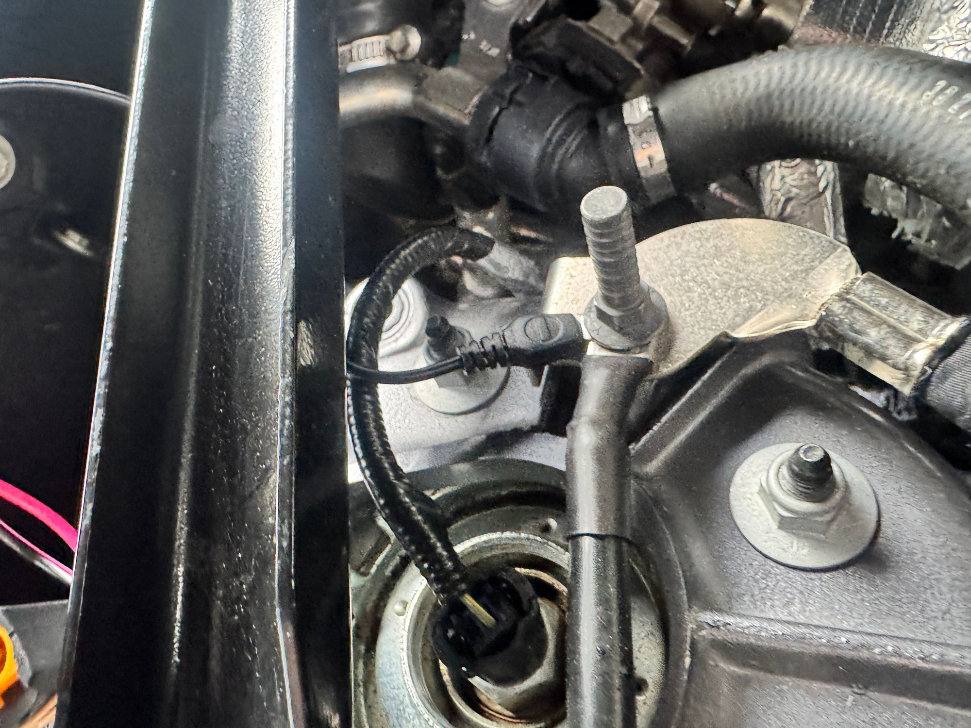

- Connection (at the pole)

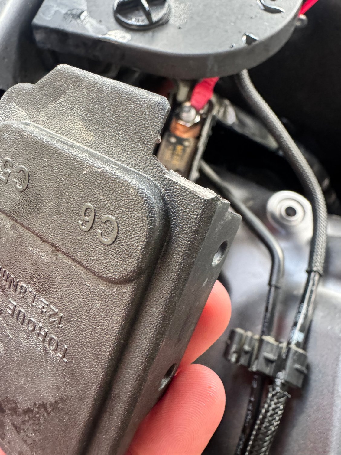

Snipped off the corner of the plastic junction box cover to clear the eyelet, it wouldn’t snap in with 2 connections on it stacked. I guess a cleaner way would be to fuse up the other one and put it there. Not a big deal.

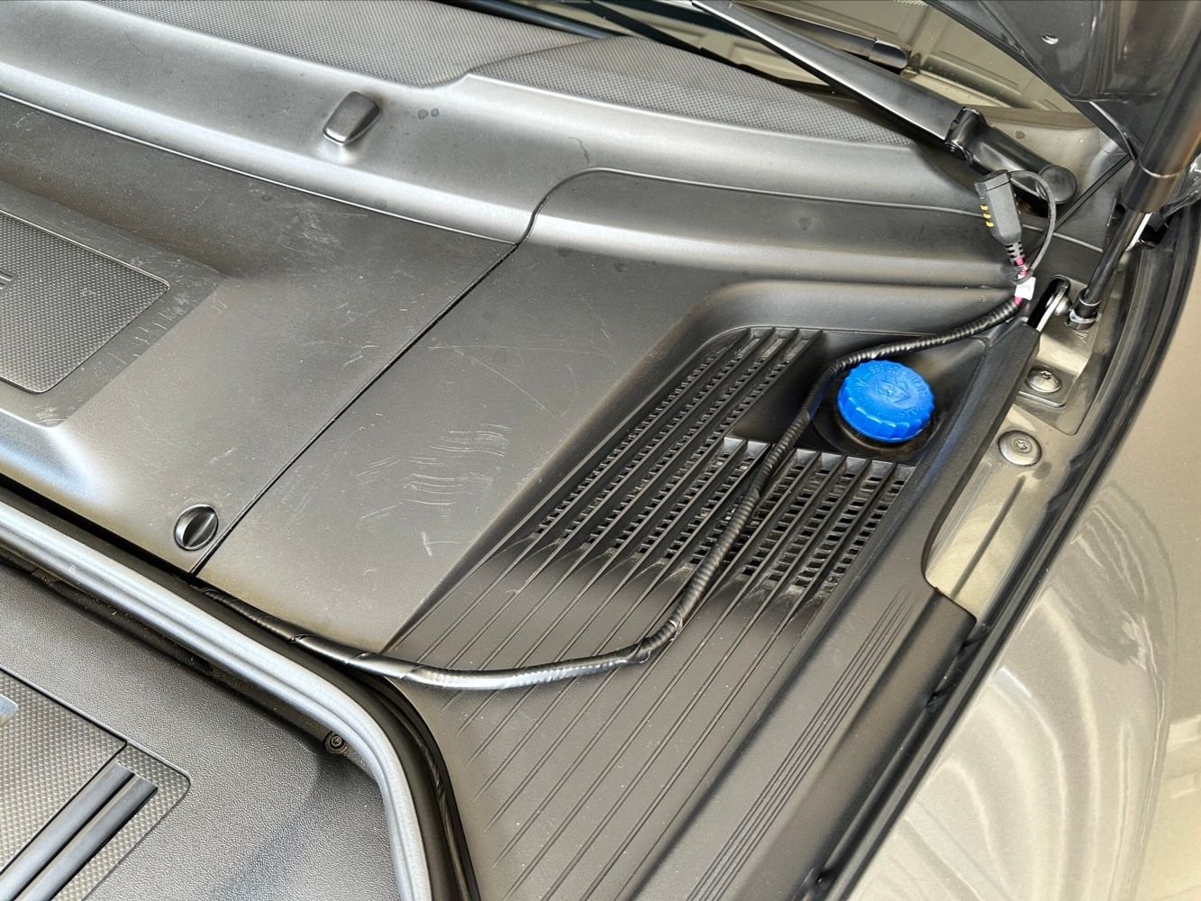

Ready to charge and where I’ll store it. I don’t want it hanging out by the windshield wipers as this thing is parked outside all the time.

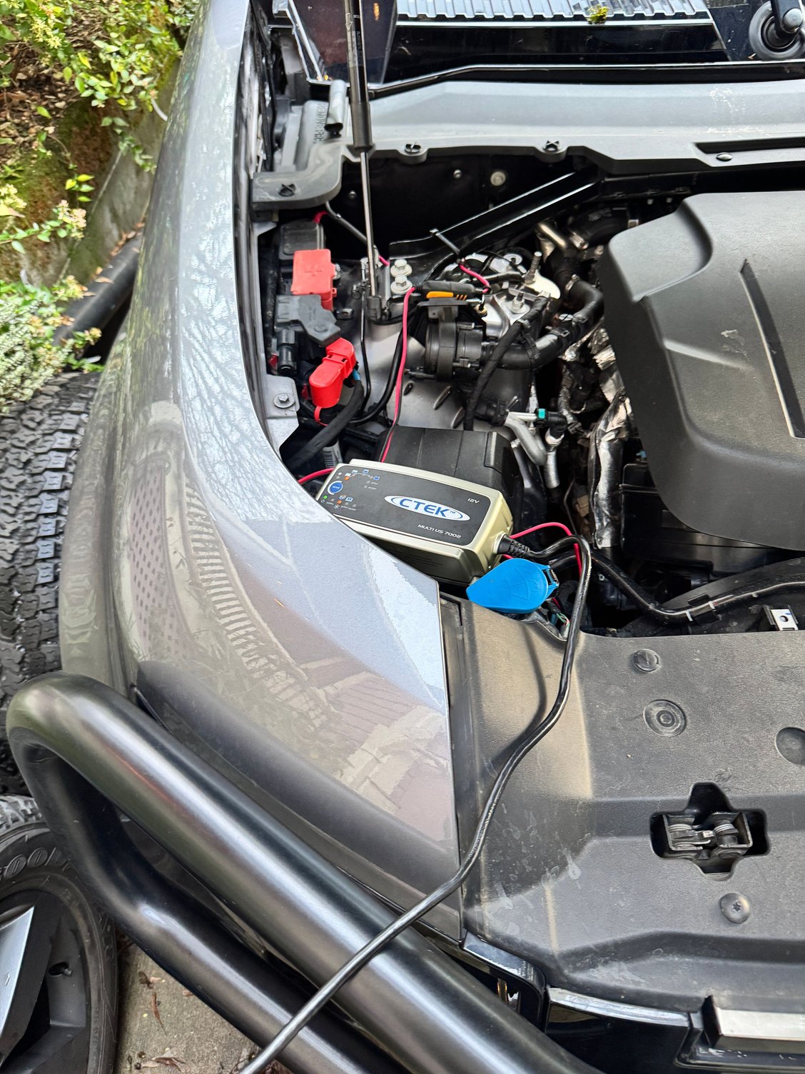

Charging. Confirmed I can lightly close the hood, route the cable generally speaking there,  and lock the car.  I leave the charger underhood because it’s not necessarily waterproof (is it) and it’s outside in this instance.

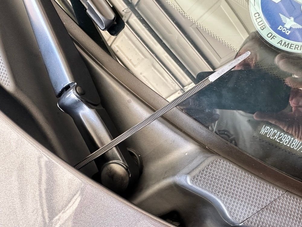

This is my setup for my Boxster. Using a zip-tie attached to the end of the connector, if I push the connector down under the edge of the hood, by feel I can find the end of the zip-tie and extract the connector without opening the hood.
