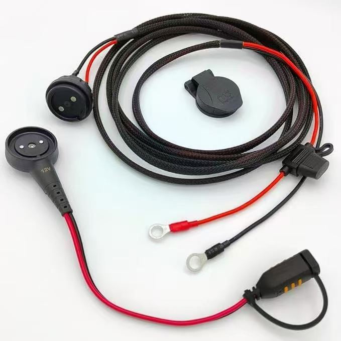

I checked out the link and this seems to be a workaround for providing constant power to the 12V socket in the cargo area, and will allow you to use your cigarette lighter adapter for charging. The suggestion to add a fuse inline is good advice. A simple pinched wire or short can easily cause some damage or even a fire without circuit overload protection. There are plenty of unswitched feeds in that fuse panel, that’s why I’m thinking of tapping one to connect a magnetic charger connector to the rear panel of the Defender for a quick and easy connection for my CTEK. When I added a rear dashcam to the window of the cargo door, and the park-protect harness needed a constant 12V and a switched 12V, I fished the wire through the rubber boot between the door and the vehicle and ran the wire into the rear fuse panel.

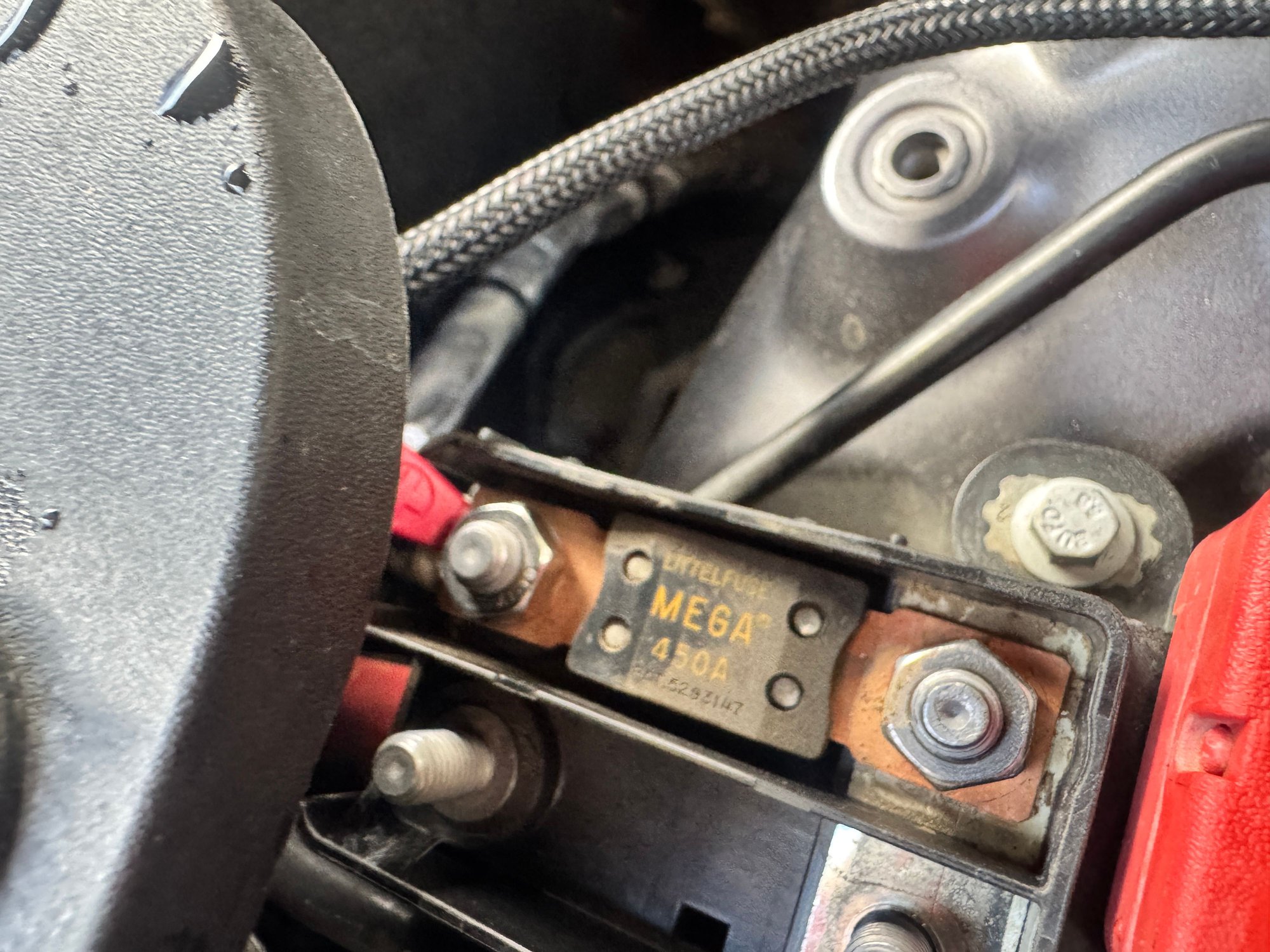

+ connection (I already had the fuse in here from my winch install so it was easy for me...) You really don’t need a fuse for the batt charger, you could just put it on either bolt on the right of this pic in theory, but a fuse is probably a better idea.. now that I think about it.

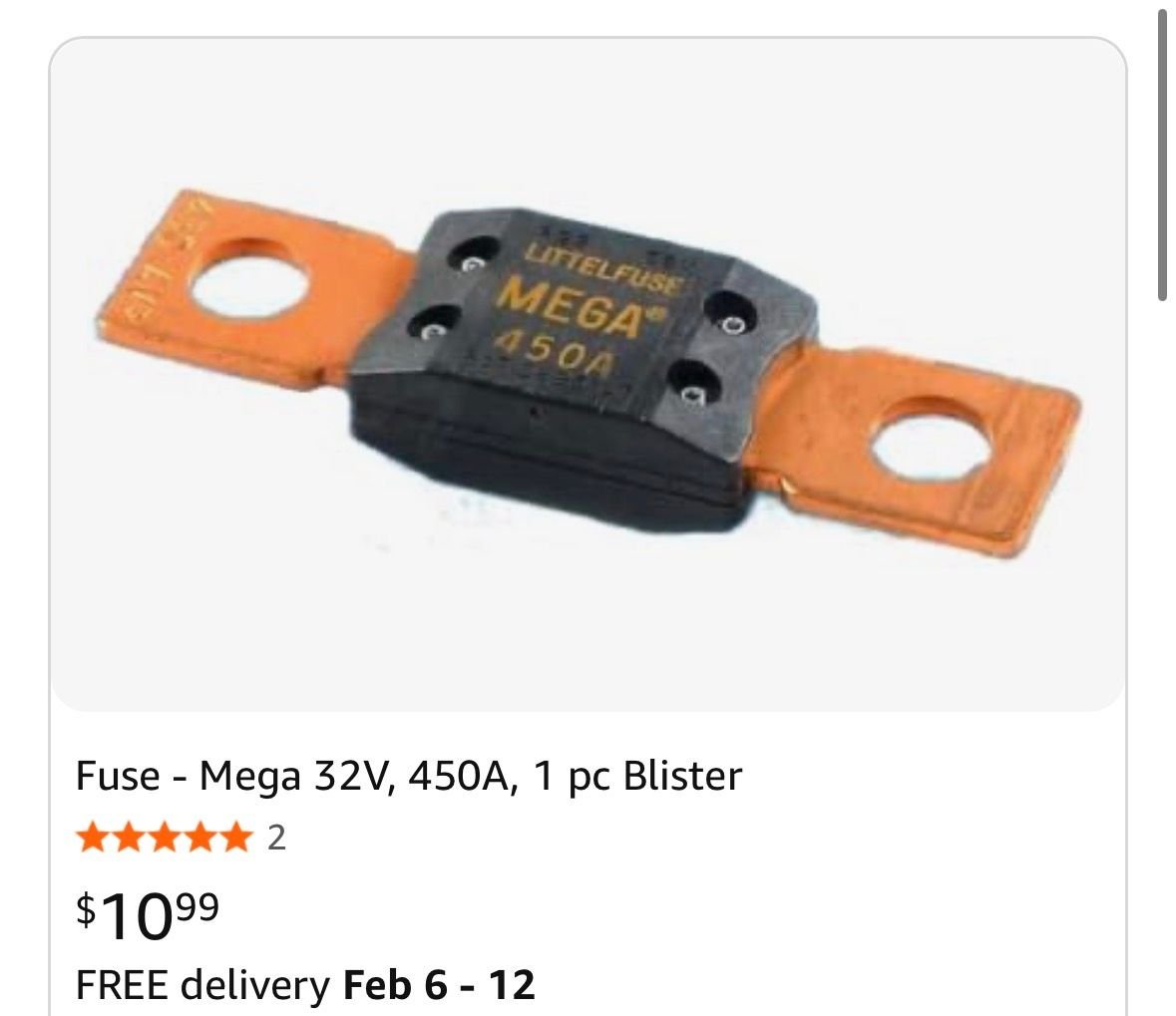

My P300 doesn’t have any fuses in this location and I think you’re right to use a fuse to be safe. I found the ones below on Amazon which look like what you used. Would they work for my car? I don’t know if it’s any different on my non-hybrid.

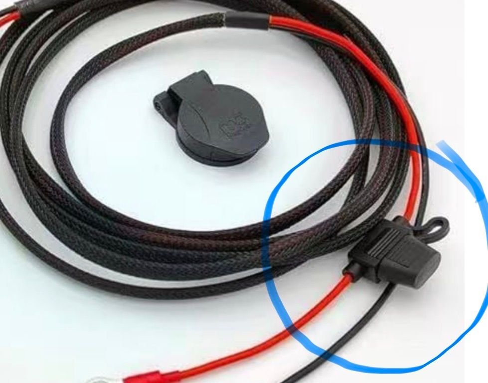

That fuse will not provide protection to the trickle charger as it is rated at 450 amps, (not discounting the fact that it is rated for 32V, not 12V). He tapped that fuse for power but the trickle charger wiring has an inline fuse that is rated to protect the small gauge wiring harness to the charger.
That empty fuse holder can just be tapped on the ‘hot’ side with the eyelets from the wiring provided with the trickle charger, as there is an inline fuse, circled above.
