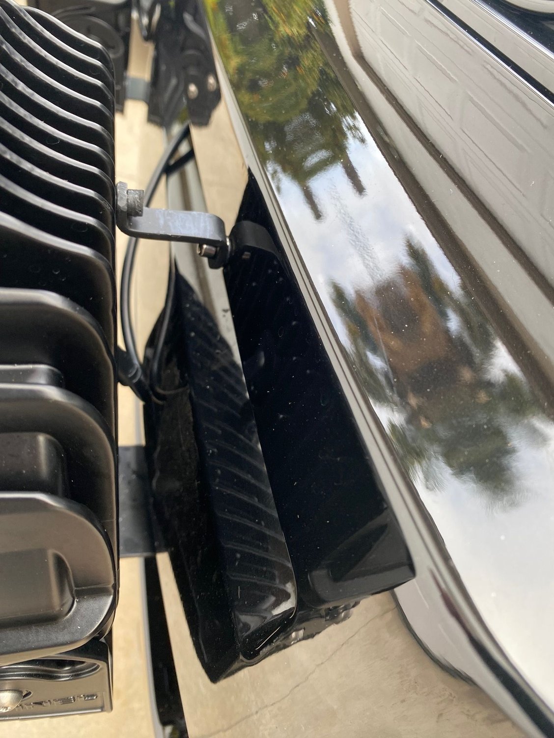

Their two lamp wiring harness, it comes with a rocker switch.. You may want to reconsider the high beam control for the lights, it really comes in handy on the back roads, not having to take a hand off the wheel feeling for the switch...But it can be added later.
I didn't like their lamp support bracket so I added two nut-certs to the bumper for the support bracket I think it needs..zero vibration issues..
