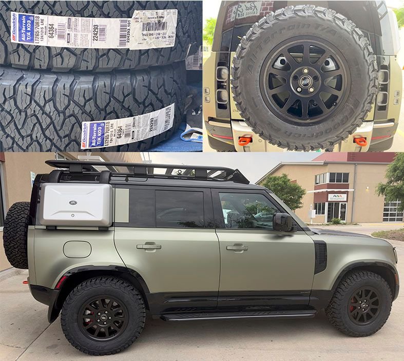

do you have any pictures of the Kimberley and KO3 combo you can share?

Sorry for delayed response - it's been a hectic several weeks of travel. I hope the images below help
Note the rear brakes are missing a part of the red brake mount system (replacement part from Lucky8) and Rhino rock rails installed (also Lucky8)
