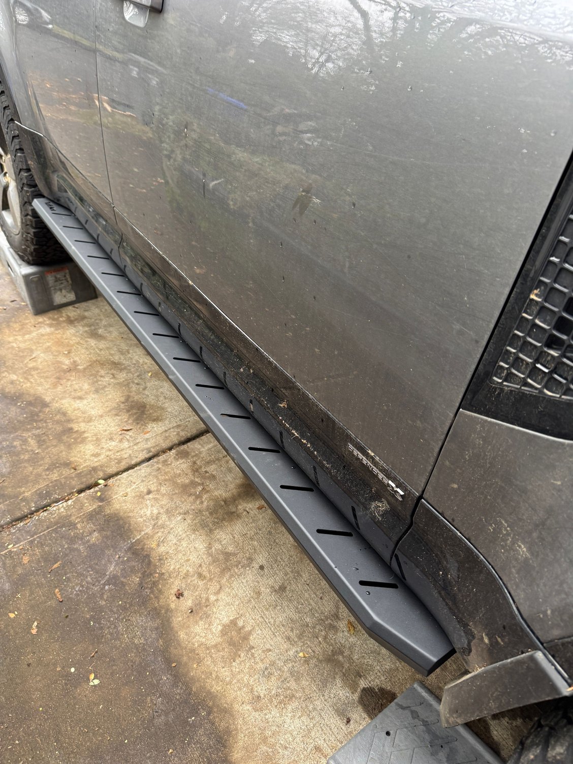

Sliders on their first test run today on a fire road in the forest
Sliders on their first test run today on a fire road in the forest.

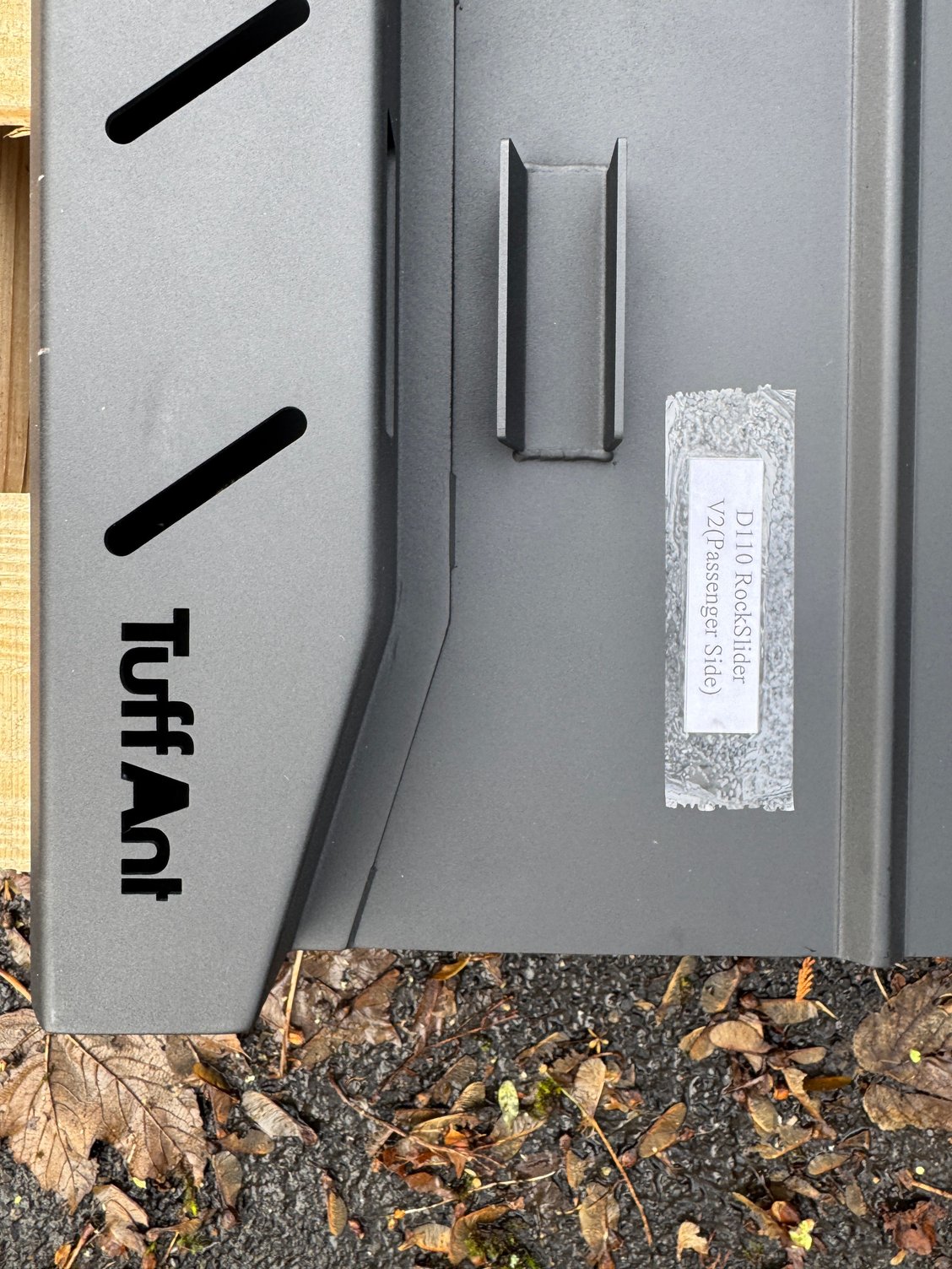

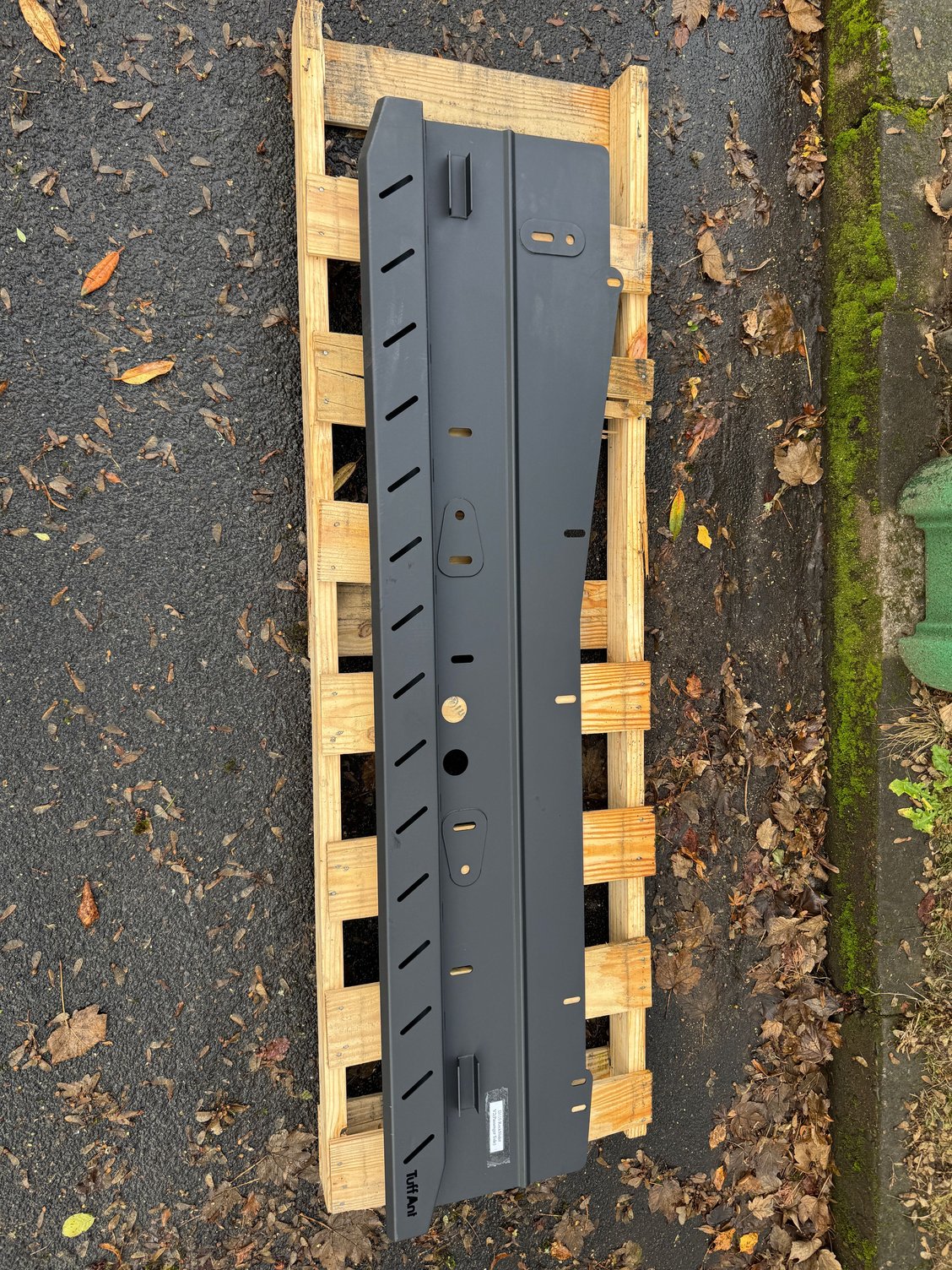

Pre-Install
Pre-Install

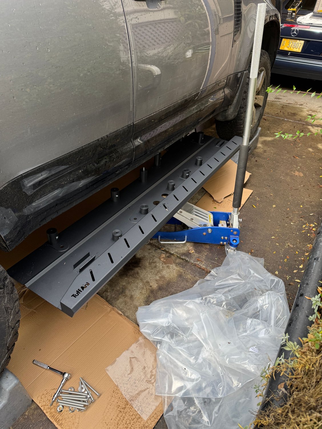

Neat little fitting goes into the jacking point.
Jacking. I put cardboard down. Unsure why since theyre going to get scuffed up.
Jacking. I put cardboard down. Unsure why since they're going to get scuffed up.

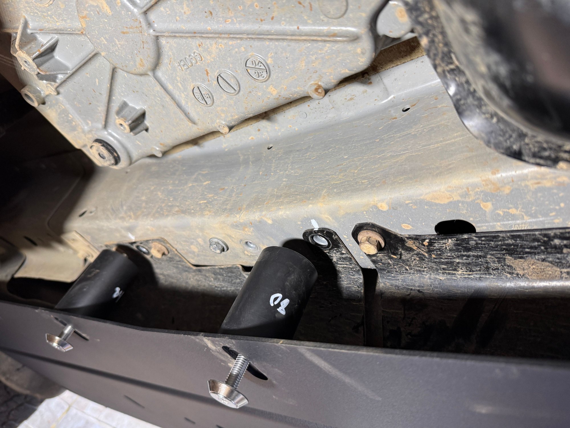

Labelled spacers.. good idea. Do this. You can see here where I did not remove the black guards it said to remove in the instructions. This is something I annotated in the red notes in the instructions, fine to note remove these btw on US models if you just remove the bolts (I marked them with a white dot on the frame of the car, you can see it above the spacers..)
Labelled spacers.. good idea. Do this. You can see here where I did not remove the black guards it said to remove in the instructions. This is something I annotated in the red notes in the instructions: I think it is fine to *not* remove these btw on US models as it says in the instructions -- if you just remove the bolts (I marked the bolts I removed with a white dot on the frame of the car, you can see it above the spacers..) . The small extra space the bracket takes up I don't think matters...

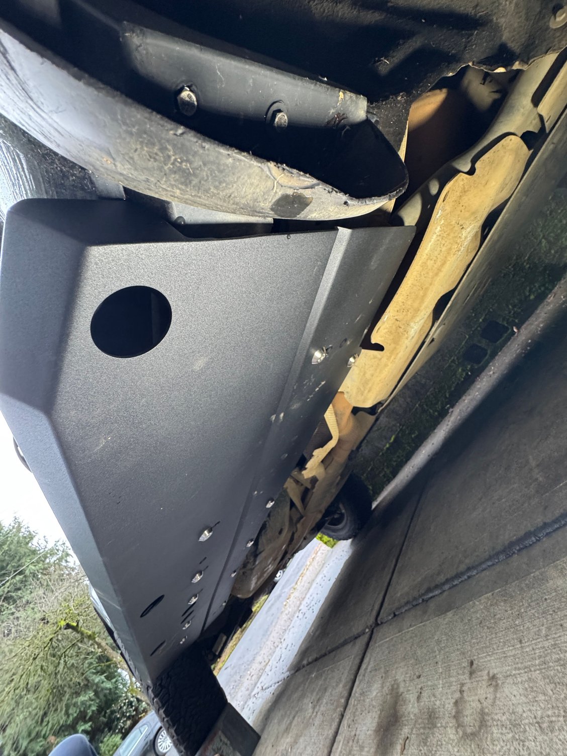

Mid-install picture after snugging up bolts.
An underside view of the bolts snugged up. You can see a couple of the holes they have in here for the
An underside view of the bolts snugged up. You can see a couple of the holes they have in here for the "Tuffant Bottle Jack adapter" which is avail on their website. I'll probably buy that too

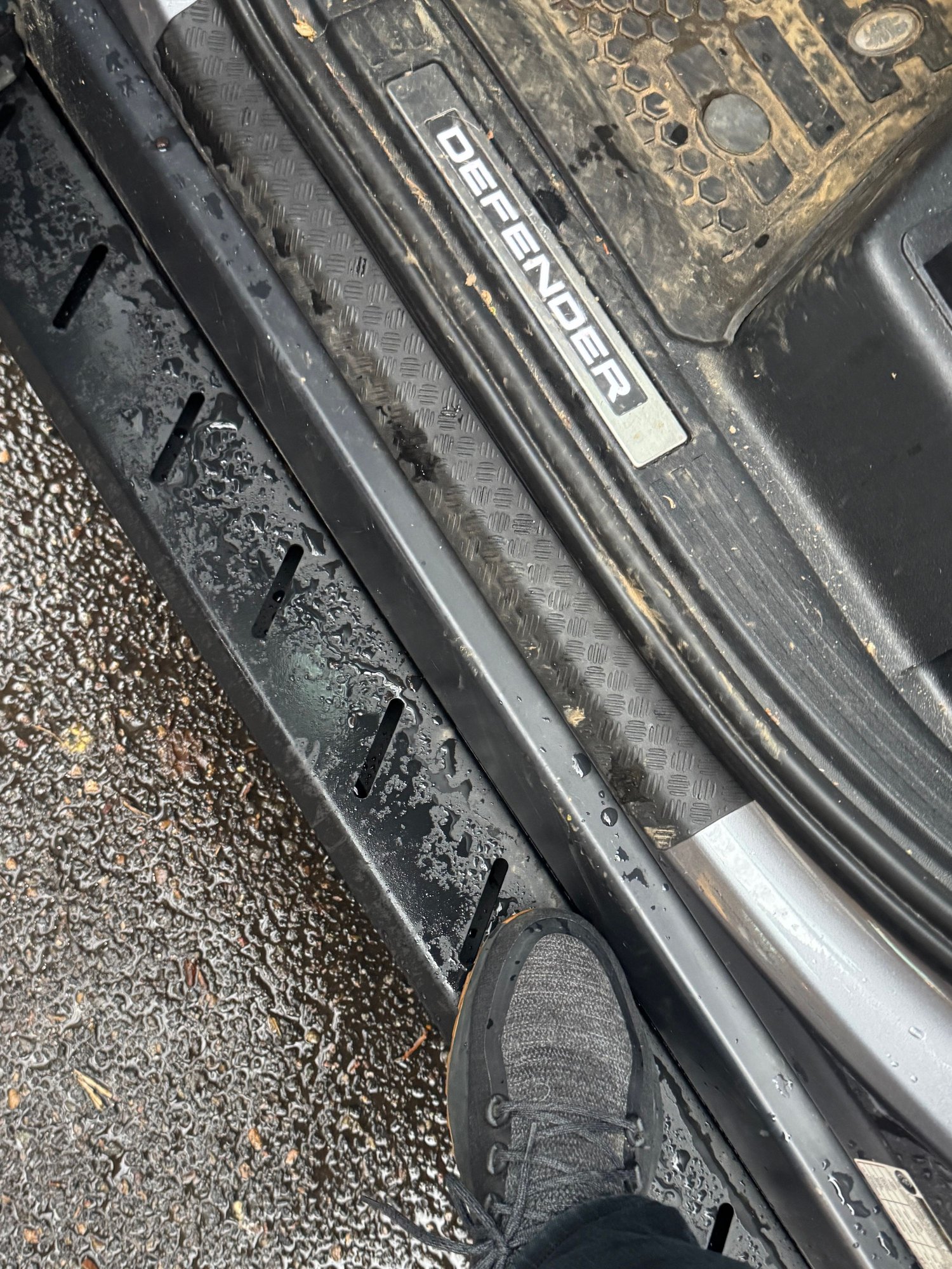

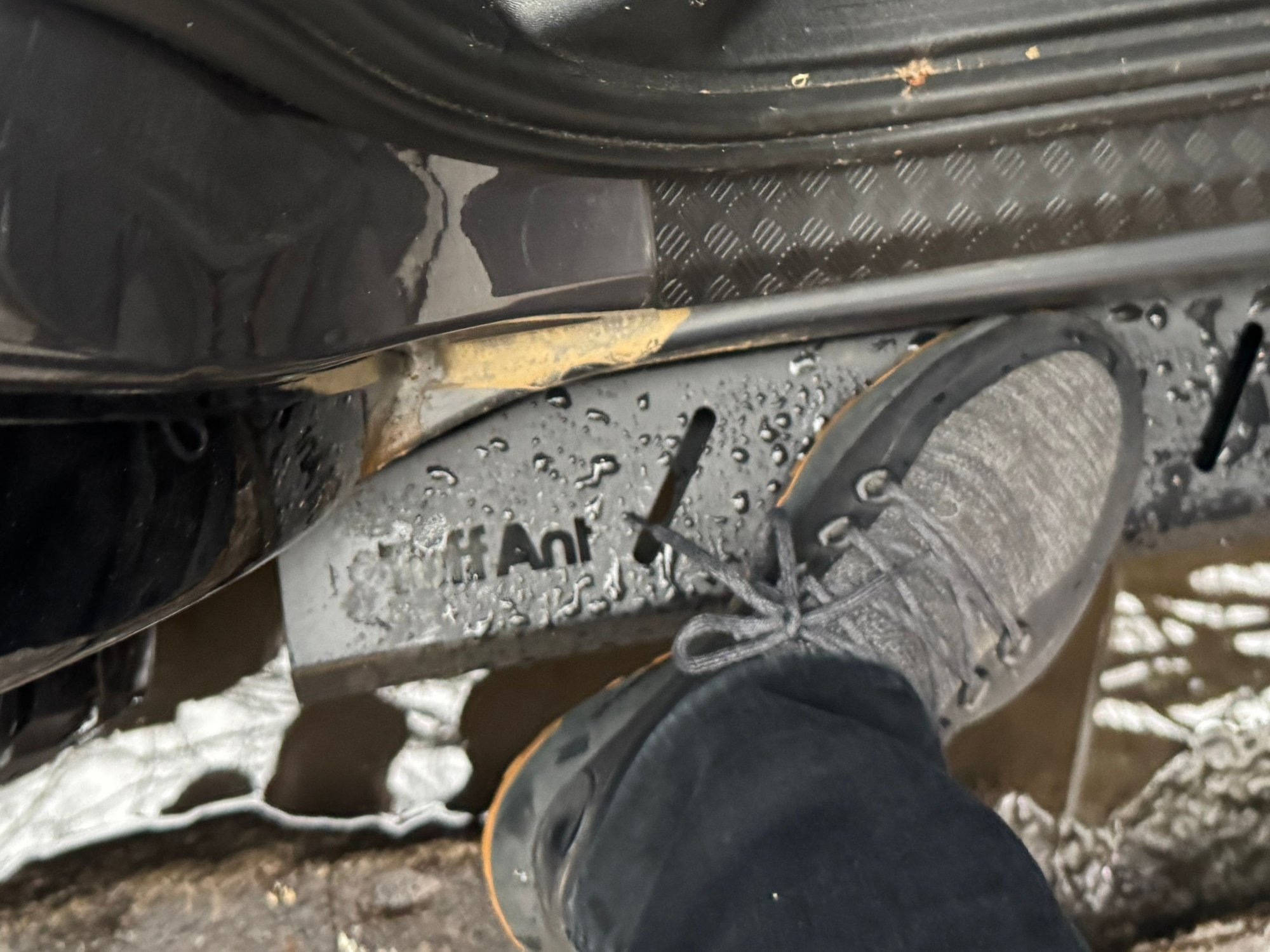

Testing the footing. Turns out they make a handy step - front door view.
And rear door.I was not expecting to actually like using these as
And rear door.I was not expecting to actually like using these as "side steps" too. I'm 6'4" so I don't need them, but for shorter folk, sure...

Q: On the topic of the rock sliders, why does the instruction manual tell you to remove a bunch of the under tray? Also, what’s different about the install for RHD cars?
I bet Tuffant wants you to remove them because they're under the sliders (so serve no purpose) and they need the mounting holes to secure the sliders.
I did not have the current V2 LHD instructions when I was installing, so I winged it. LHD cars in the US market have 2 additional undertrays that AUS RHD cars do not have. I did not yank them to see what they were protecting underneath. You need a few of the mounting hole to mount the sliders. I simply removed the bolts I needed to, left the trays, and mounted the sliders over the trays—it worked fine. That said, the sliders themselves are identical for LHD and RHD cars—I can confirm this.
This a pic of the parts in question:
And in this picture, you can see I left them..
This is 2mm thick steel plate protecting the A/C components. It's redundant with sliders in place. I removed mine for the Voyager slider installation. Different design. No spacers. They can't be fitted without removing these. The sliders protect all that stuff once installed.
I think leaving them in place is not a good idea, The extra 2mm of steel will keep the full diameter of the spacer from supporting the slider. Probably me being a dumbass but I'd take them off.
