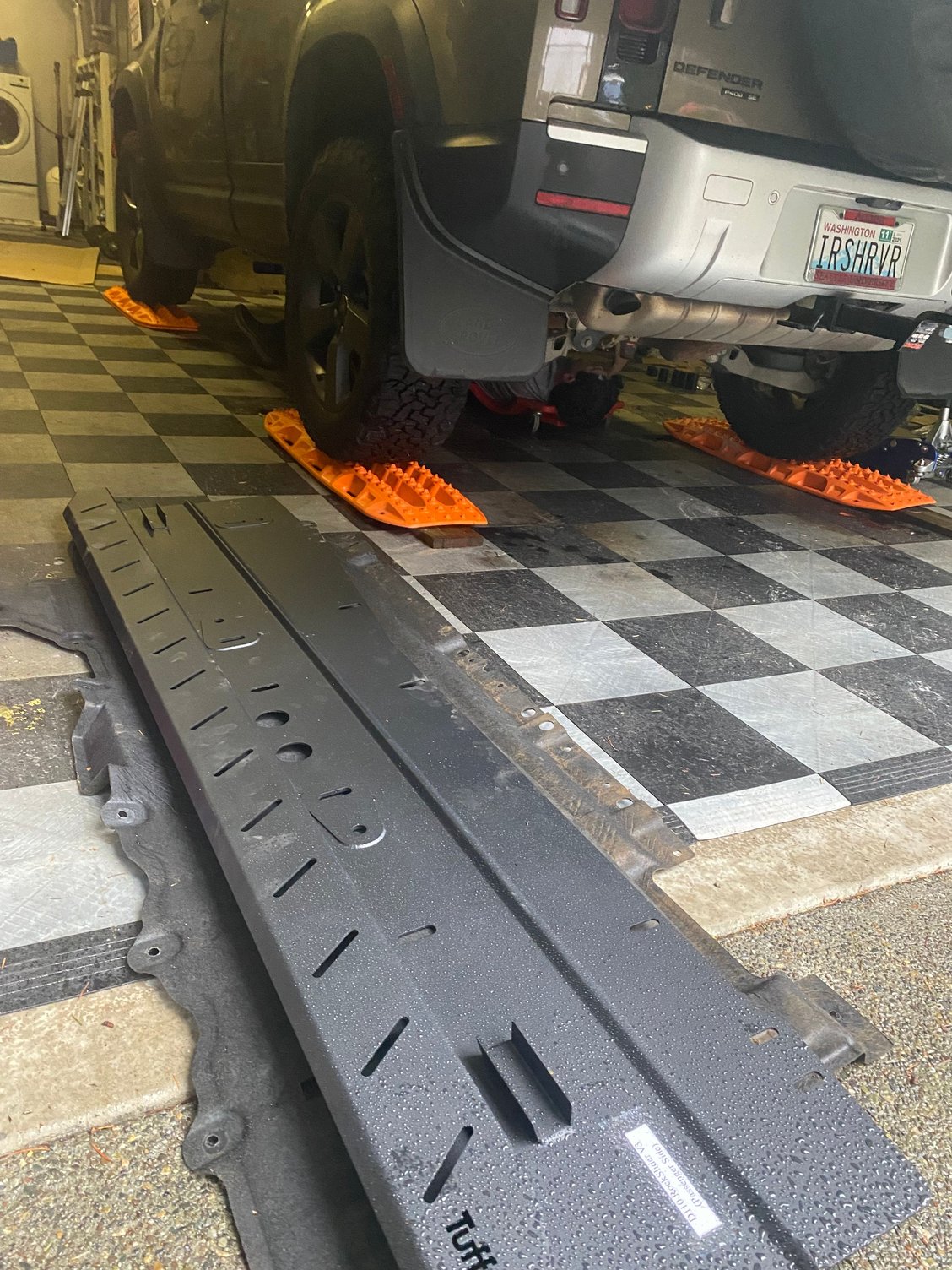

One follow up question I had was on the torque settings for the Tuffant bolts. (20 M8s and 2 M6s) No info in the instructions.
I guess it's not crucial given the enormously long thread (2" almost) that engages the vehicle's metal.
I'd recommend doing a torque check after 1000miles or so. Make sure there's no play in the spacers. All are accessible to inspect from the underside.
I would recommend removing all the metal armor on both sides listed in the Tuffant instructions. Takes just a few extra minutes. No downside.
The spacers come in very precise sizes 84mm 80mm 65mm, 50mm 45 mm etc. having an extra 2-3mm of metal between spacer and body of vehicle will have an impact. Minor most probably but definitely counter to the precision of the Tuffant design.
The sliders could be removed and repositioned in under an hour if needed.
One bolt on each side engages the armor over the transmission. That will need to come out when the front diff and transmission are being serviced. Something to note for whoever is servicing these in the future.

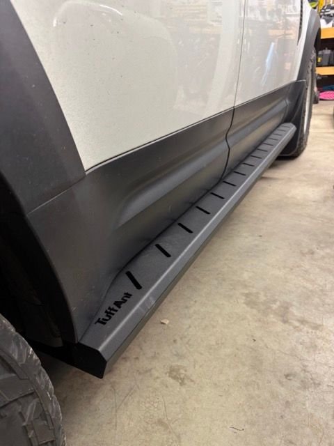

I'm really happy with my freshly installed TuffAnt sliders. They look great, offer a bit of step functionality (although not as good as the side steps), and more importantly, give me some off-road protection. Next step is to buy a bottle jack and find some rocks to slide on!
This thread has been super helpful. Thank you. Half my time was spent uninstalling the OEM side steps, requiring the removal of the plastic molding along the bottom sides of the rig and replacement of 30 one-time use clips (LR112137). I learned that I didn't need to remove the front mudflaps just to remove this molding.
