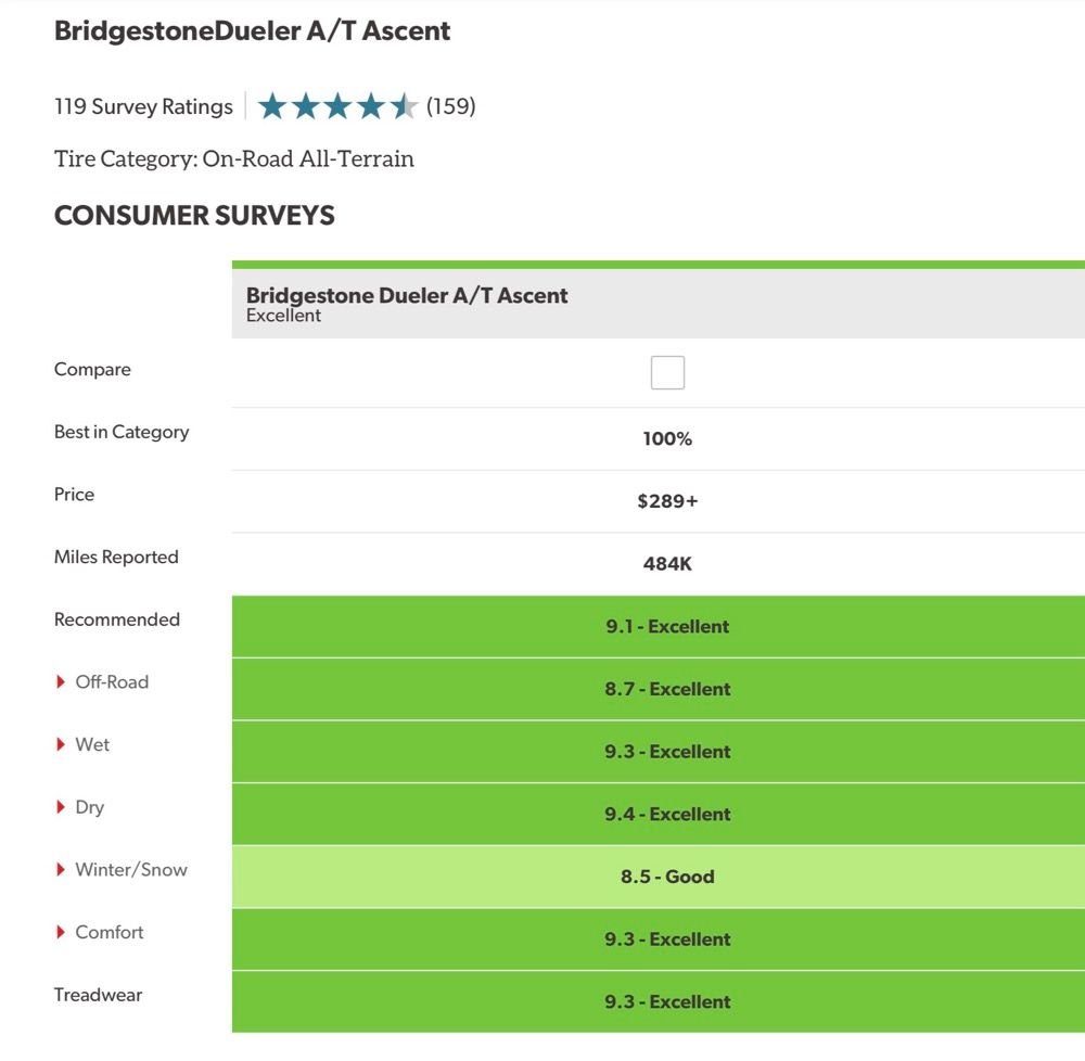

Have been doing lots of research on replacement tires for my 2022 Defender 110 and narrowed the choices by personal preferences of Load Rating, Speed Rating and ratings charts, which I have included one below for the Bridgestone Dueler A/T Ascent.
Love all of those ‘Excellent’ ratings. I have narrowed my short list of tires to the Bridgestone Duelers, Cooper Discoverer Road+Trail AT, and the Nitto Terra Grappler G3. All have top ratings, and the Coopers and Nittos have an XL load rating, while the Bridgestones have an SL load rating. Close race as of now but I’m leaning ever so slightly toward the Nittos. One reason being is that observations by tire shop owners and the guys doing the mounting and balancing, indicate that with these larger, clunkier tires the Nittos, in their finding, come from the factory needing very few wheel weights when balancing, while some tires in this category of On Road All Terrain require several to numerous ounces of wheel weights to achieve balance. Also highly recommend is having the tires balanced using a ‘road force balancing’ machine. Another factor which influences my decision is road noise, for which the Nitto gets the thumbs up in that department. If I’m on a long highway road trip, the last thing I want is an annoying drone that will drive me bonkers after a few hours.
Avoid anything SL on the Defender. You want a minimum XL to match OE load requirements.
I was going to go with that Cooper tire until Michelin released Defender in 285/45/22 size. Have not read anything bad on the Nittos plus look more aggressive (but are more $).
