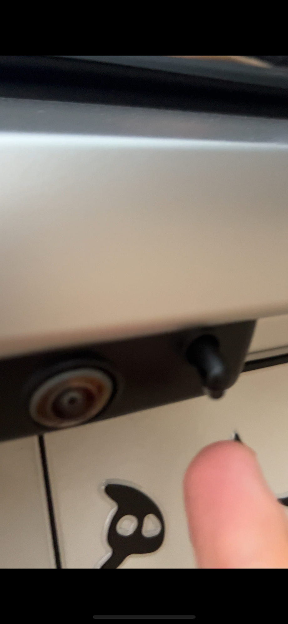

Hello everyone,
I'm experiencing a problem with my 2024 Land Rover Defender. The rear camera washer is leaking water, and I'm not sure why this is happening. Before taking it to the service center, I wanted to see if anyone else has faced this issue and found a solution.
Here's a bit more detail on the problem:
- Water drips from the rear camera washer.
- The issue persists even after ensuring the washer system is properly filled.
Has anyone else dealt with this? What could be causing the water leakage, and what steps can I take to fix it?
Any advice would be greatly appreciated!
