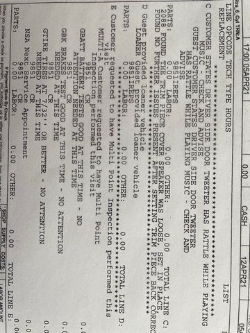

I had the same speaker sound and the dealership fixed it last week. Said the speaker bolts weren't tightened correctly.
Could you post a picture of the service record description? I have this too and just figured it was an unfortunate characteristic of the system. Usually only hear it with poorly recorded podcasts that require a lot of volume so not that big of an issue but if fixable that would be a bonus.
The actual invoice explanation differs slightly from what I was told verbally. I was told it was bolts that hold the speaker, not the trim. Either way it seems to have fixed the problem. Service record section attached.

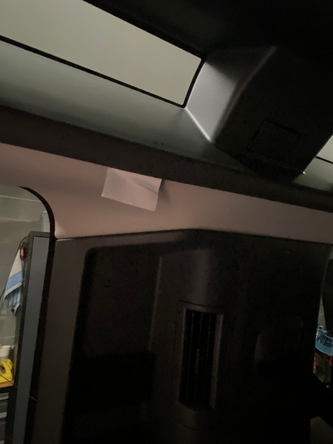

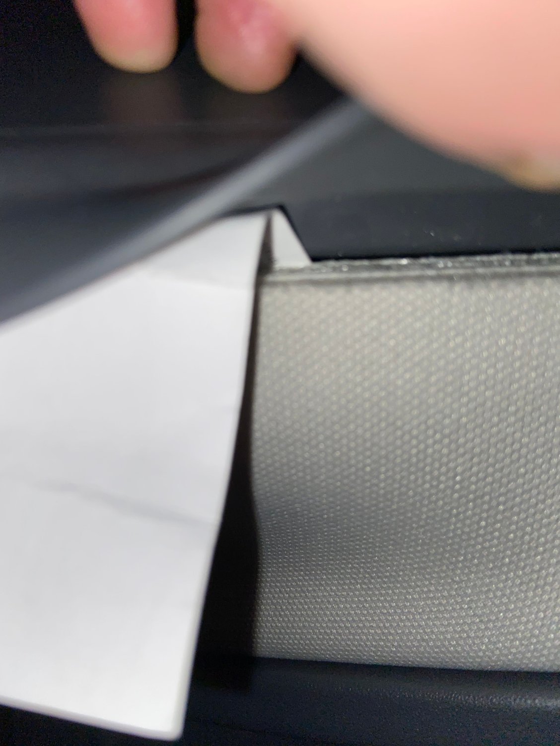

Where do you put the business card, would you post a pic? Thanks

will do although it is not a perfect fix!

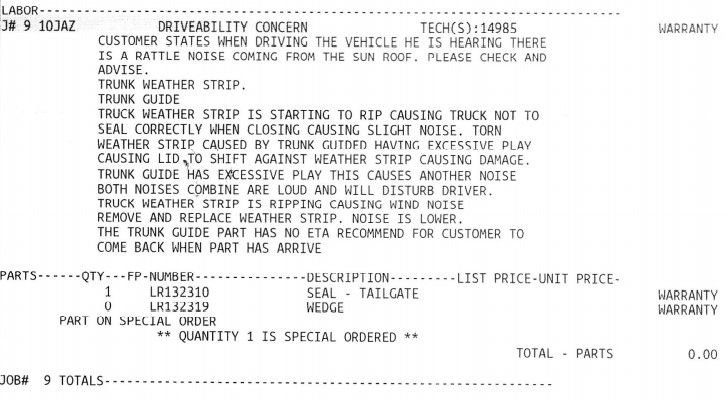

I was hearing a rattle that was behind me and during my first scheduled service (the 21,000 mile service) they fixed it. Attached below as a photo is a description of the repair. Rattle now gone.
Difficult to show on pic but this is just behind C pillar under the safari window.
