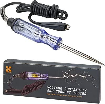

I would give Lucky8 a call and ask them the question. I have heard that Lucky8 is great to work with support wise. Or you could try another open slot. 1, 4 , 5 should all be an option. Test them with a tester first to see if they always have power or are they switched power ( like when the engine or headlights or fog lights are turned on). you need to test them with a tester to see if or when the fuse socket powers up. Also maybe the fuse end adapter of the red wire might have a bad crimp or something. Be careful of tapping into a random hot wire to feed power. New defender are CAN BUS and if you pick the wrong wire all sorts of error lights will light up your dash.
Fuse socket tester. the clamp side goes to ground.
