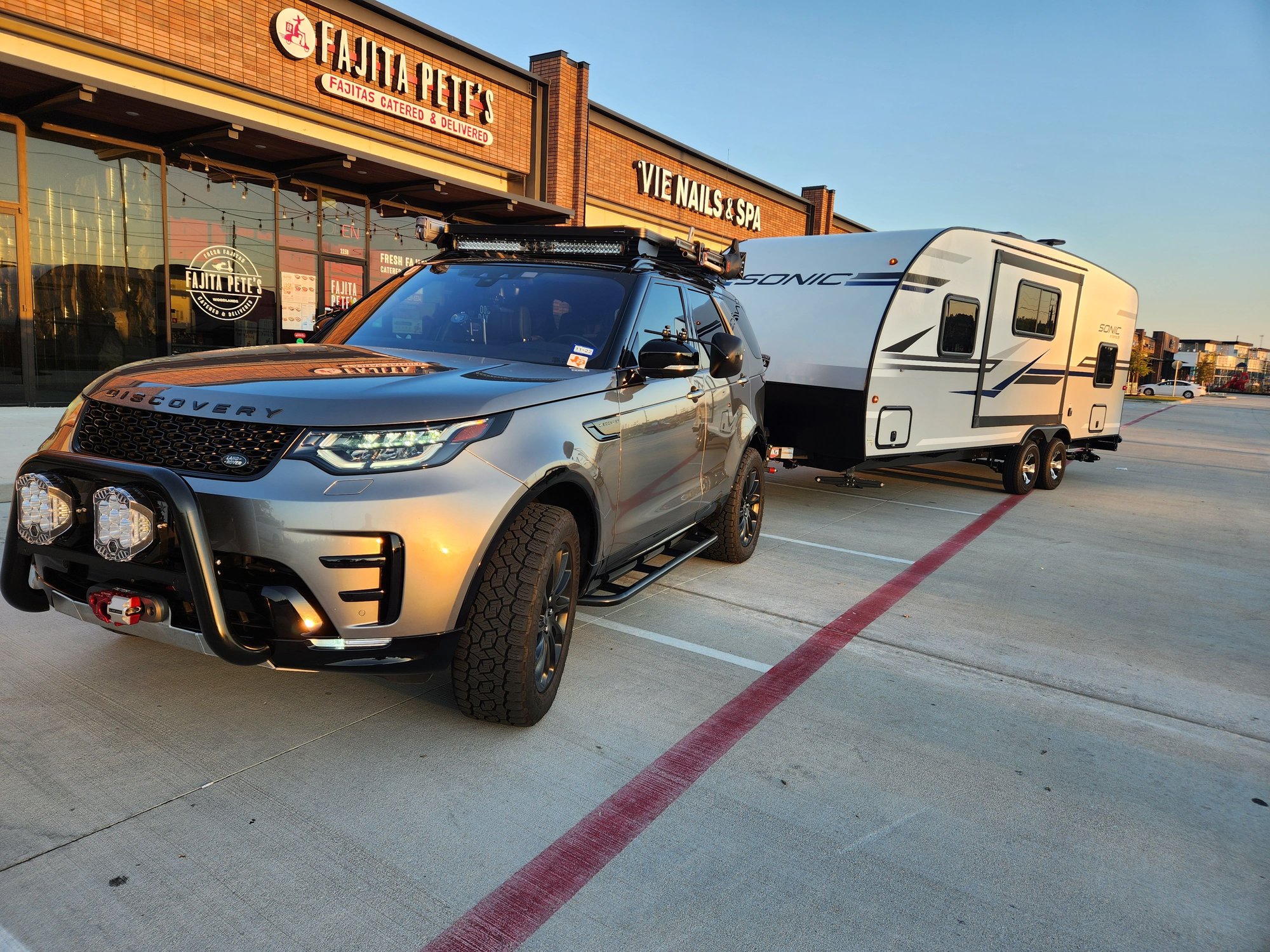

I originally went with the Lucky8 grill mount for my lights but they would not work without cutting into the dynamic grill that I have. Decided to return it and just go with the A bar. Mounted some Baja Designs lp9 pros there. On my FR rack I was looking at the Baja Designs XL linkable lights but did not like that way it would mount so I just went with a Auxtel 43" light bar pro that mounts to the underside of the roof rack. As for a backup light I found a single row blacked out 1000w light bar that fit perfectly and is somewhat hidden. All this is controlled via a Auxtel control pod that has a ribbon cable on it mounted to the left side of the instrument cluster. The ribbon cable I was able to pass through the door jam and into the engine bay. The electric block there has 6 connections and all relays needed to control accessories. Perfect fit inside and looks stock.

Great looking rig...AND....you're at Fajita Pete's!!!
Outstanding!
Old Nov 15, 2022 | 12:04 PM
Donc98's Avatar
Joined: Dec 2021
Posts: 121
Likes: 61
From: Texas
Oh you know that has to be a stop since it is along the way when we were heading to the Hill Country Rally. Besides the Shipleys is right there as well and the kids love that.
