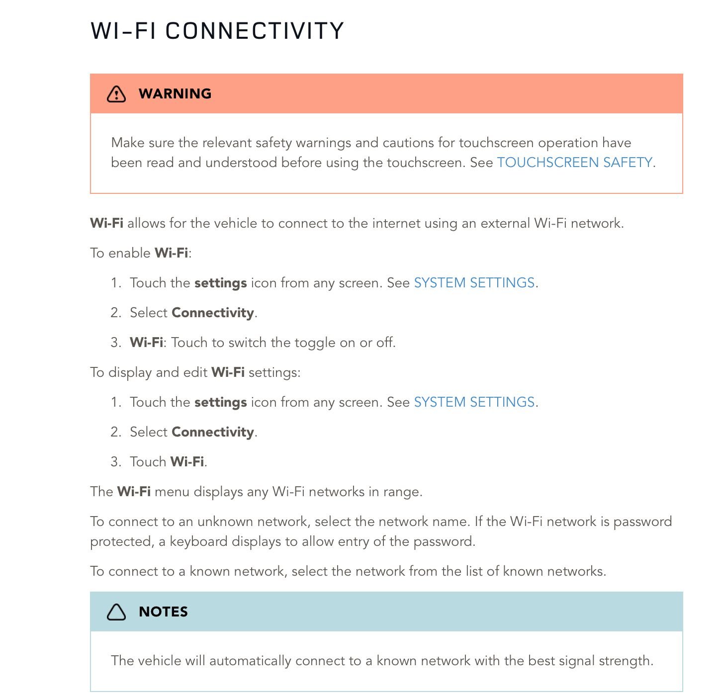

I did read through that thread, thanks for posting. It seems I am 4 'versions' behind. My cell coverage in the area where I live is a bit weak but the car moves in and out of areas with good coverage all the time. I have pretty good WiFi at the house and WiFi is 'enabled' in the Defender's setting s menu but it never asks me to select a network much less enter the password for it. My phone will pick up multiple WiFi networks at once.

Even though you enabled WiFi in settings, I remember going through a few more steps, where I selected my network from a list of detected networks, then entered my password. After the system accepted the password, it gave indication that I was connected to my WiFi network. I believe you still need to complete a few more steps before you are actually connected to WiFi.
