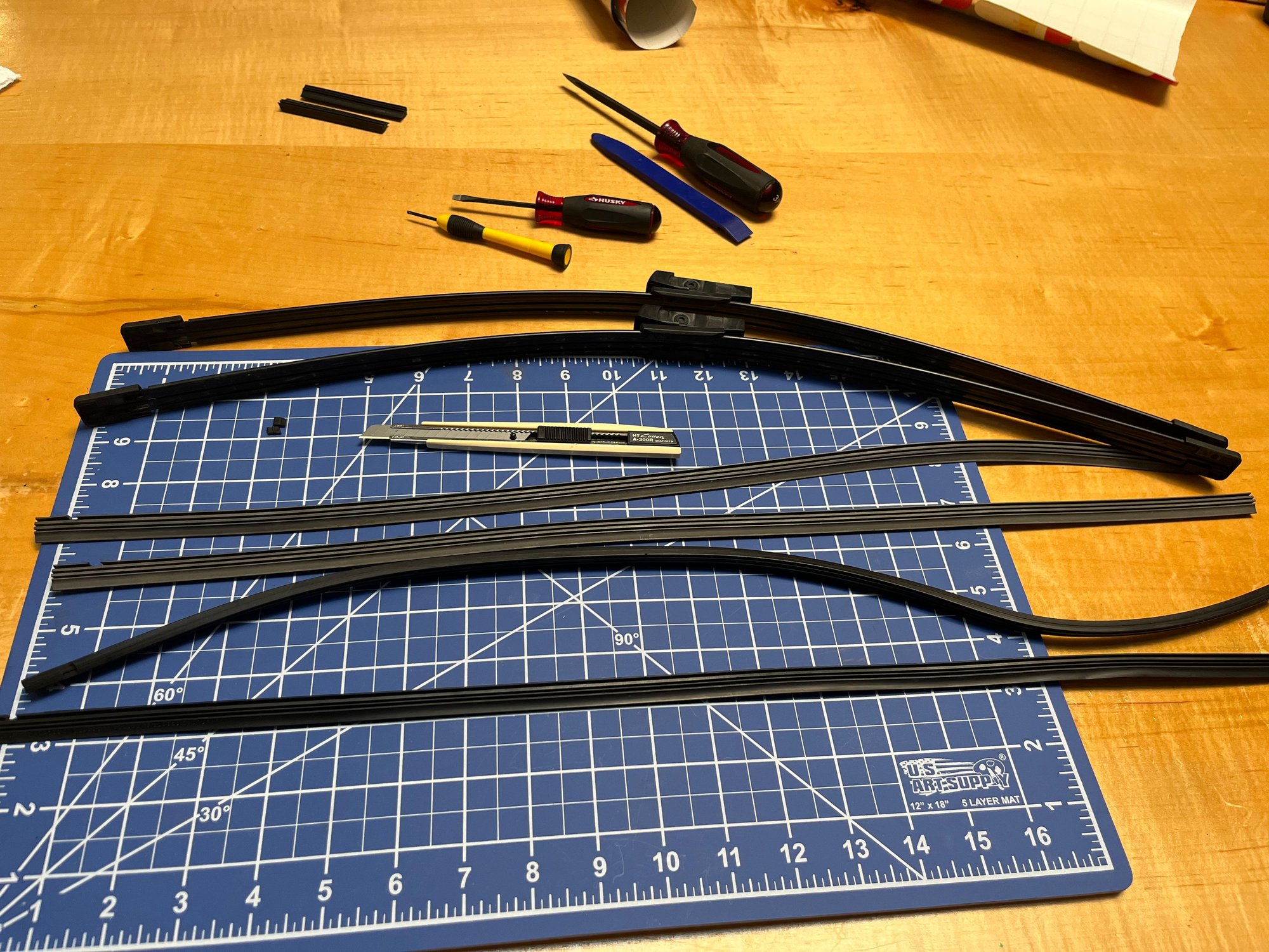

Just did another front wiper replacement @GrouseK9
$6 for 4 blades so a $3 DIY for new wipers. Two left over for next time.

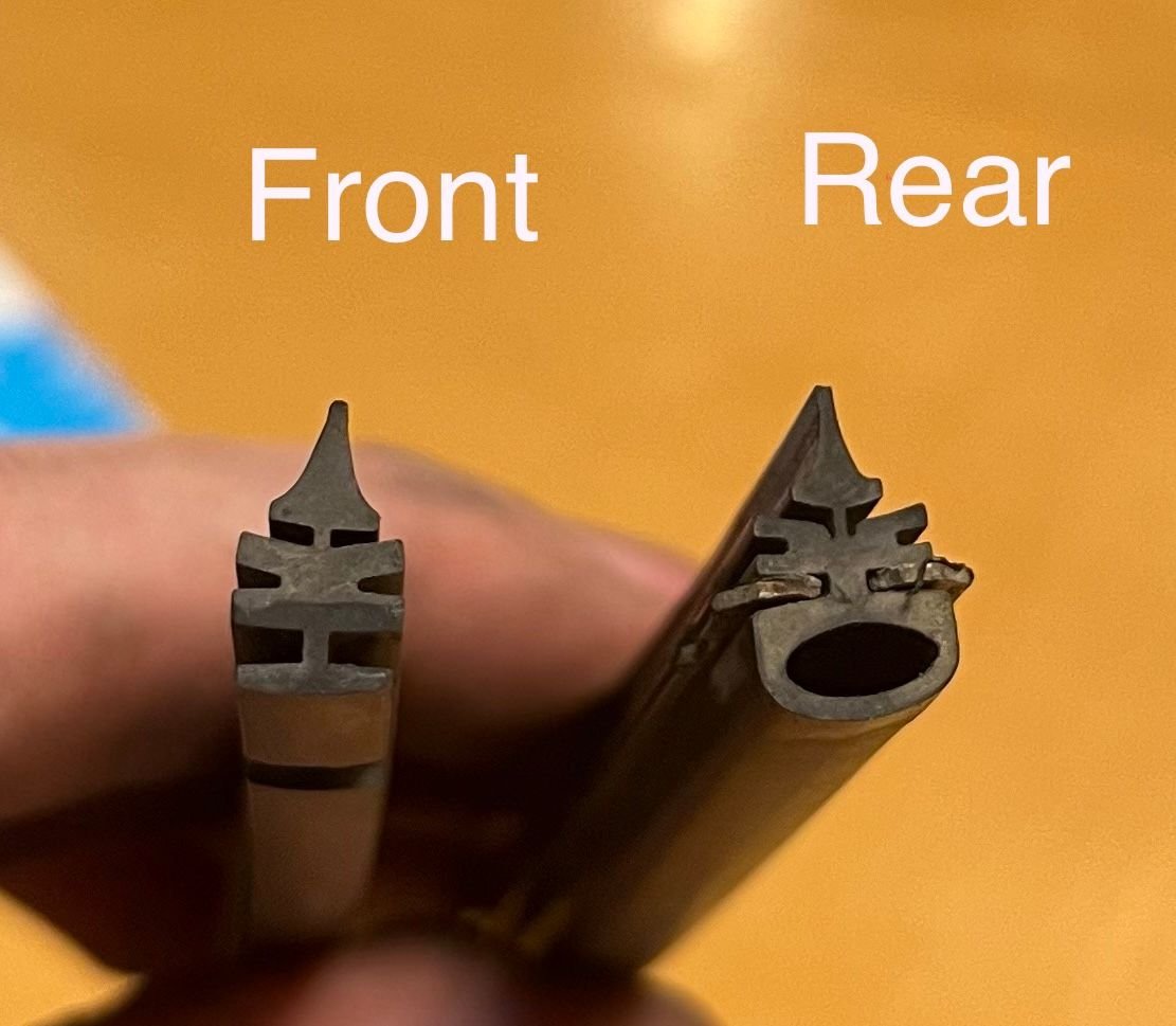

The rear wiper is not amenable to replacement with these as the rubber has a tubular cross section. It serves as it’s own washer jets.
You can see where the washing fluids go in the ovoid channel.
A few minutes of trimming like before.

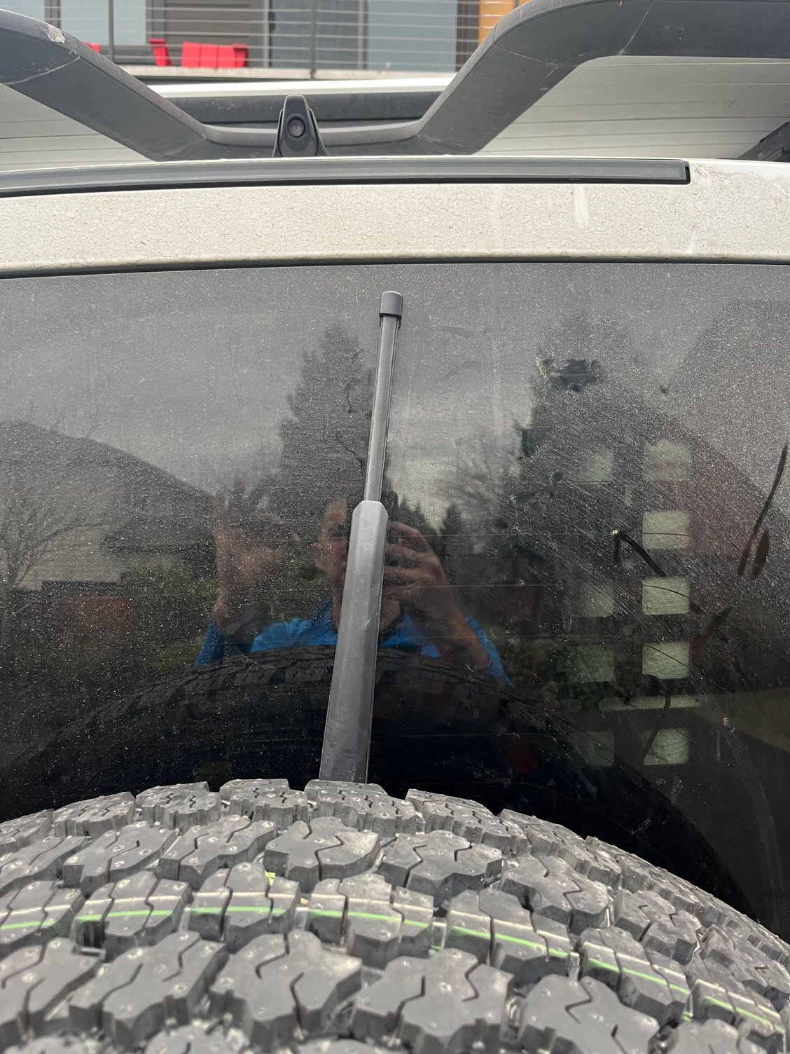

Service position for wipers.

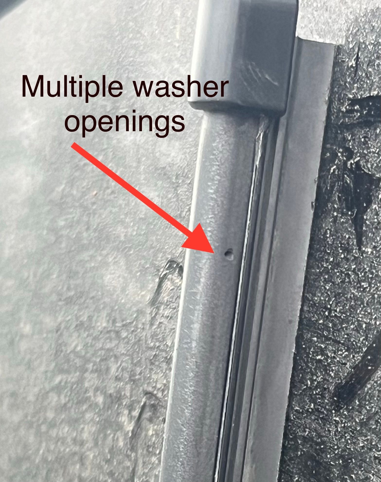

A close up of one of the pores on the rear wiper. There are many. Clever design.
A close up of one of the pores on the rear wiper. There are many. Clever design which AFAIK has since been superseded by LR
