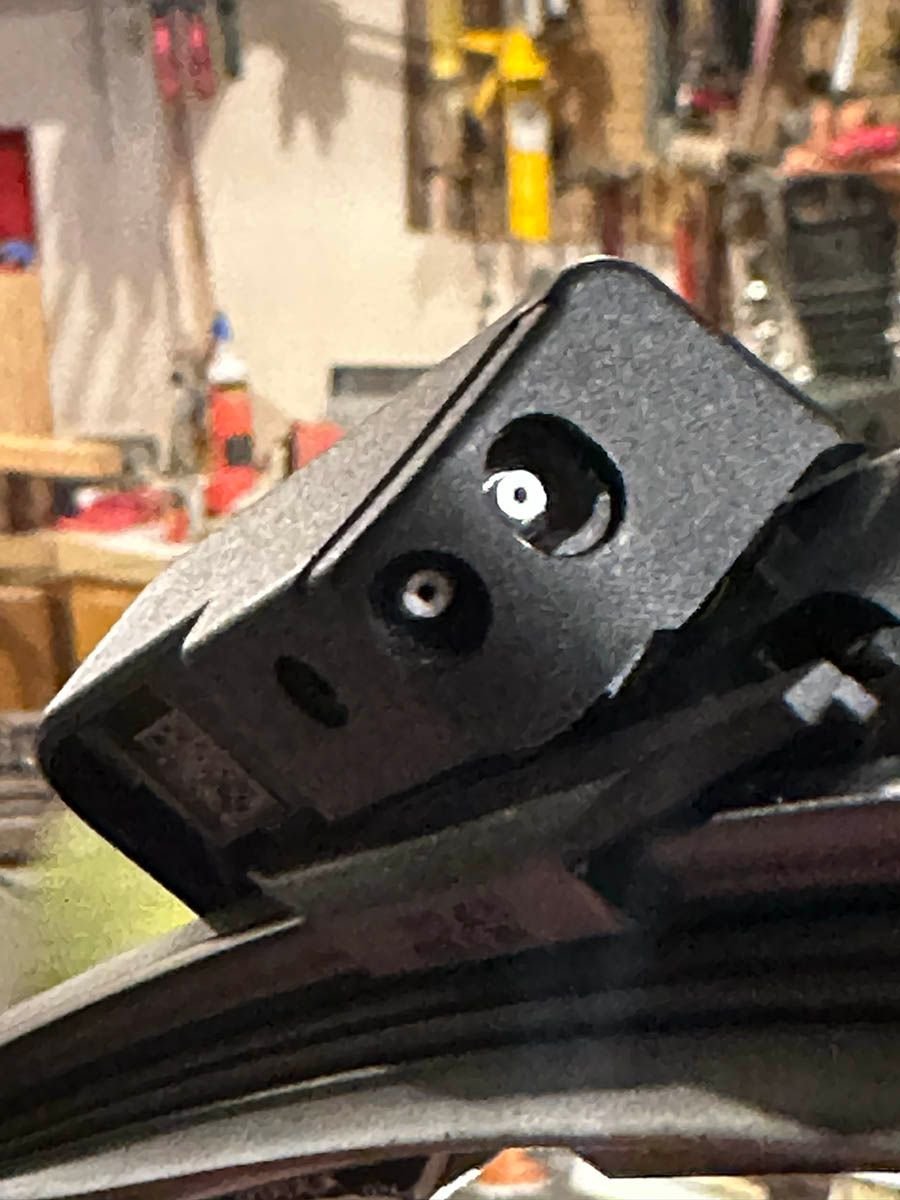

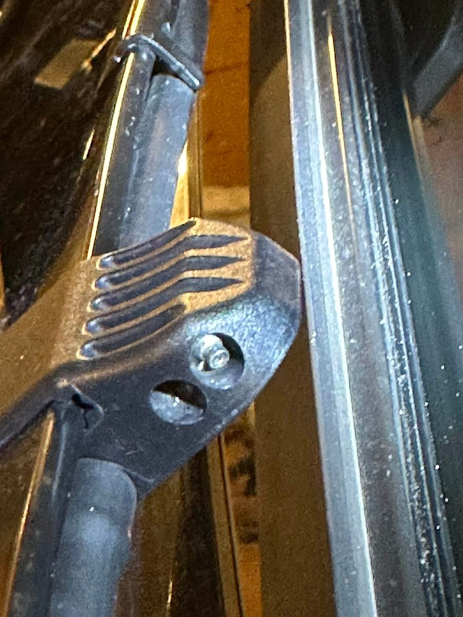

The ports sending out the fluid are small ball and port assemblies. Since the beginning of windshield washer squirt systems, they need adjustment from time to time or, from the very beginning of their service. If yours look like mine, you stick a pin in the hole and re-aim them. Moving the ball a small amount each time. It takes patience and you do not want to exert too much force on it.
I have had to do this to virtually every car I have owned from Porsche to Beetle.

That one lower one on the outer assembly may just be more of a flooding nozzle, as it does not appear to have an adjustable ball. If you cannot get it to move without too much effort, best live with it. You can wallow out the hole in the nozzle and that makes it less of a stream. Nearly every car I have done this to has been slightly different. So far I have been lucky, my Defender's ones are right on the cusp of needing adjustment. Sometimes things are best left alone. At least these work, the last Defender, the 97 ST they where more decretive than effective.
