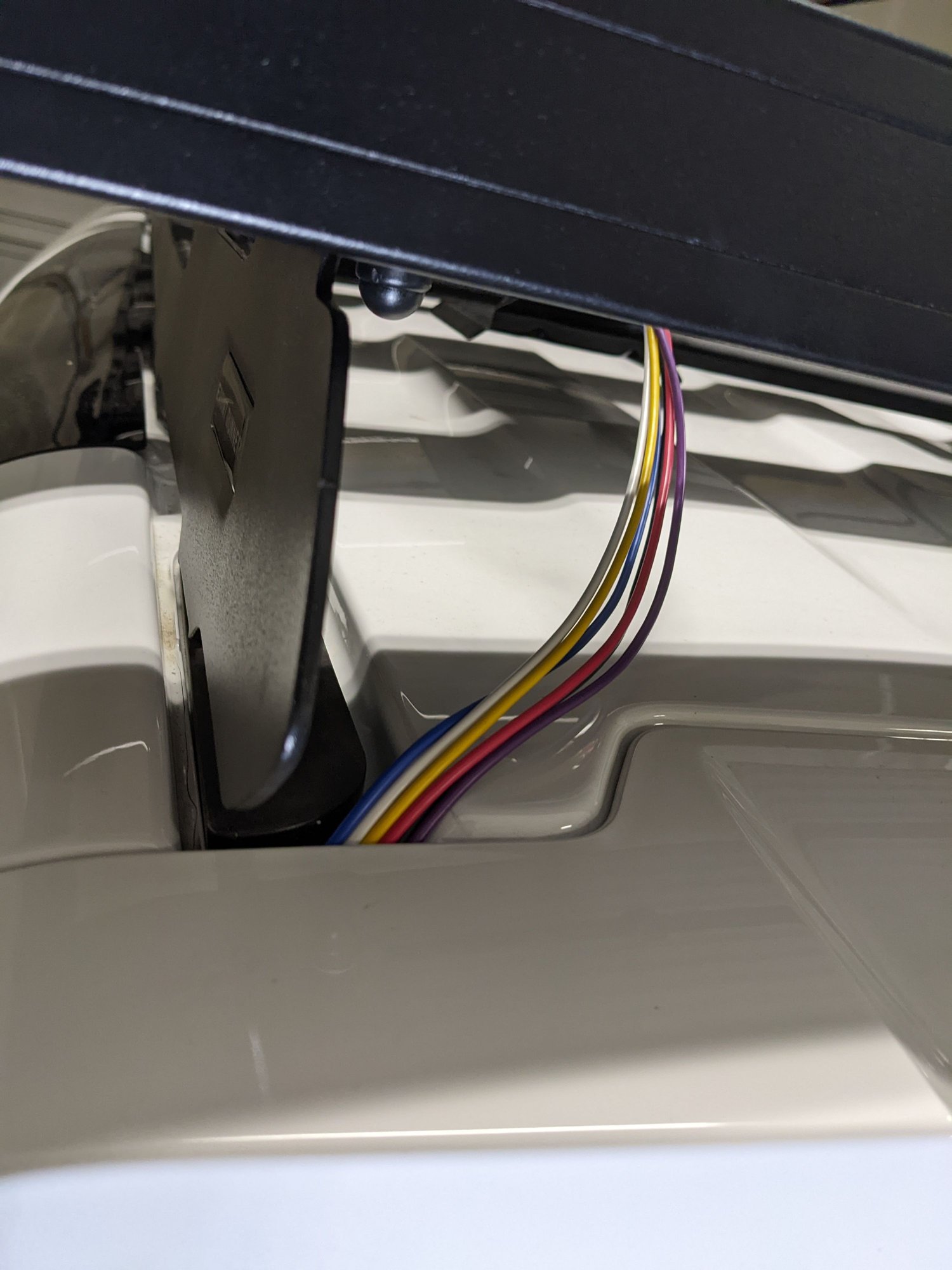

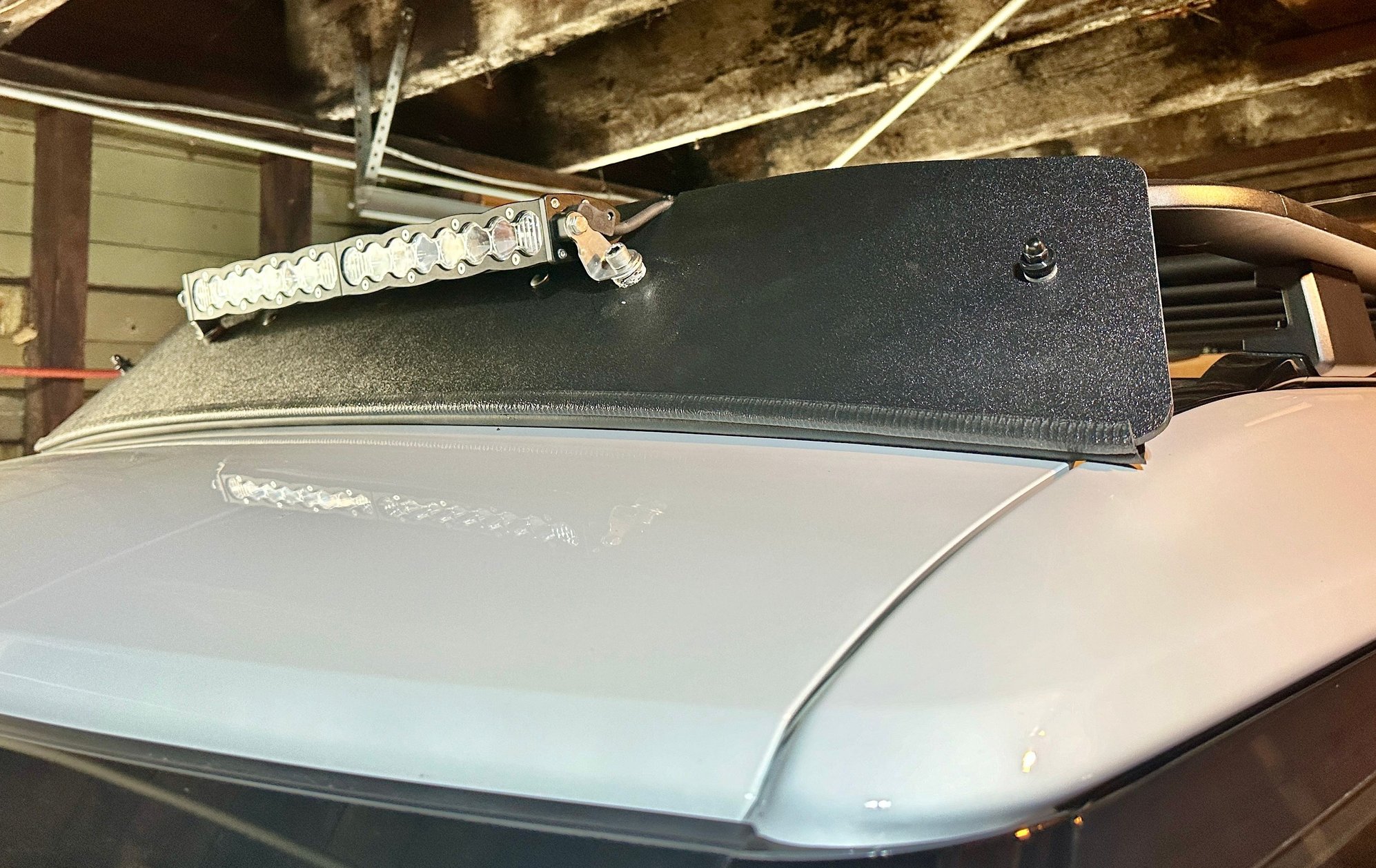

I’m looking for the best way to wire the harness. The cable is pretty heavy, like about 5mm dia. I think it will run down the gutter seam and into the front left pilar behind trim cover. Once into the engine compartment I don’t see a simple for for the switch cable to get in behind dash. Some have suggested the steering boot but tat is very low inside seems impossible to reach much less to drill a hole. Any simple suggestions before I drive myself crazy? Sorry for the crap photo.

Have a look at this system by Trigger:
https://triggercontroller.com
The control module can be mounted in the engine compartment and wired to the power take off's that LR kindly provided under the hood by the right front area (there is a good ground connection near by too). The switch box/control is wireless/RF and can be placed anyplace inside the cabin you want it and IIRC can be powered via USB as well.
Powerful UK carries a similar system that uses bluetooth for communications between the switch/power box and the control button panel:
https://www.powerfuluk.com/collectio...mote-bluetooth
There are cheaper wired switching systems, but you know for the money, NOT having to run wire over to the steering column boot and not having to punch a hole through said boot, and then trying to seal it up around a wire afterwards might be worth the added cost of a wireless system over a wired system.

There are a few examples of using a swichpro and going through the steering column boot on here.
However I've been considering going all the way to the back, there looks to be a couple of grommets there. Check out this video from @PowerfulUK

Going through the boot is pretty easy, once you take off the cover under the windshield wipers under the hood you can see it right there. There are many sources for these instructions. I think one of the light bar’s sold has a complete set of online instructions. I just can’t recall which company had the instructions. Was it Lucky8? Someone else will recall. I posted some photos as well, maybe later I can find the link,
For me I put the switch pro unit under the hood and ran one control cable into the cabin. Now I can hook up to 8 things under the hood.

I ran all my electrical to the back. There are a couple of easy to get to grommets. My main relay box is under the floor in the back. I then ran one control cable to the front for the controller. That wire is shoved under the door sills. I use AUXbeam as my controller.
