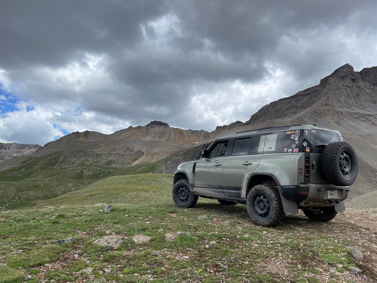

If anyone is interested, I went with Cooper Discoverer Rugged Trek (RT) in 255/70-18. It's also available in 265/65-18, as well as 275/55-20.
The RT is a XL rated tire with a 116T (18") or 117T (20") load rating. I use this as my off-road wheel/tire setup, keeping the 20" OEM Goodyears for street use. I have one long trip out west with a lot of off-roading in the San Juans and was very pleased with the performance. It's louder than the OEM so I keep them for street use (because wife), but compared to what I was used to in my Wrangler before, they are whisper quiet. If you're not familiar with the RT designation it slots in between AT and MT in "ruggedness." A good compromise for this truck, IMO.
