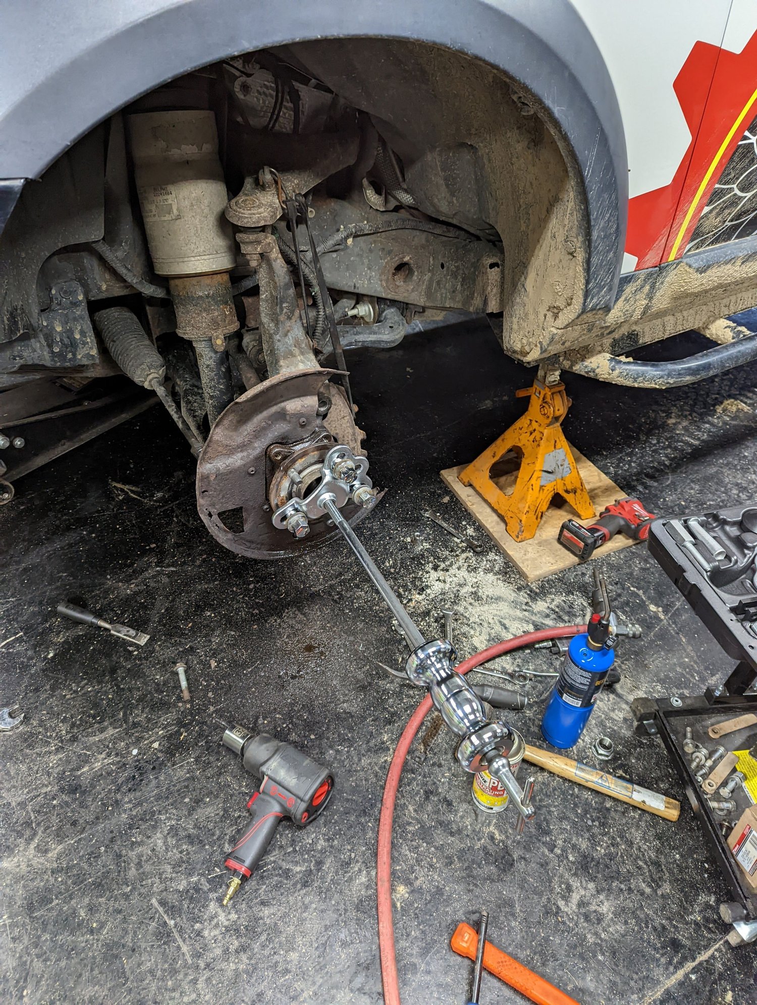

So today was going to be easy.... Those hubs pop right out.... I have a 5 lb slide hammer and adapter....
I tried pleading, asking, cussing and hitting it like I thought I was Thor....
and it continued to laugh at me... I laughed last and took the nuclear option..
I'll just swap the whole assembly to a nice rust free unit from one of the LR3's I'm parting out. Problem solved.

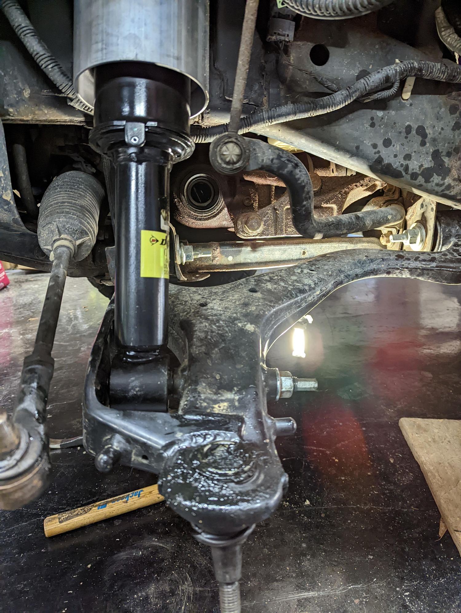

While it's apart that is the perfect time to add a set of SYA spacers and new front struts/springs. I'll also be rebuilding the front valve block.

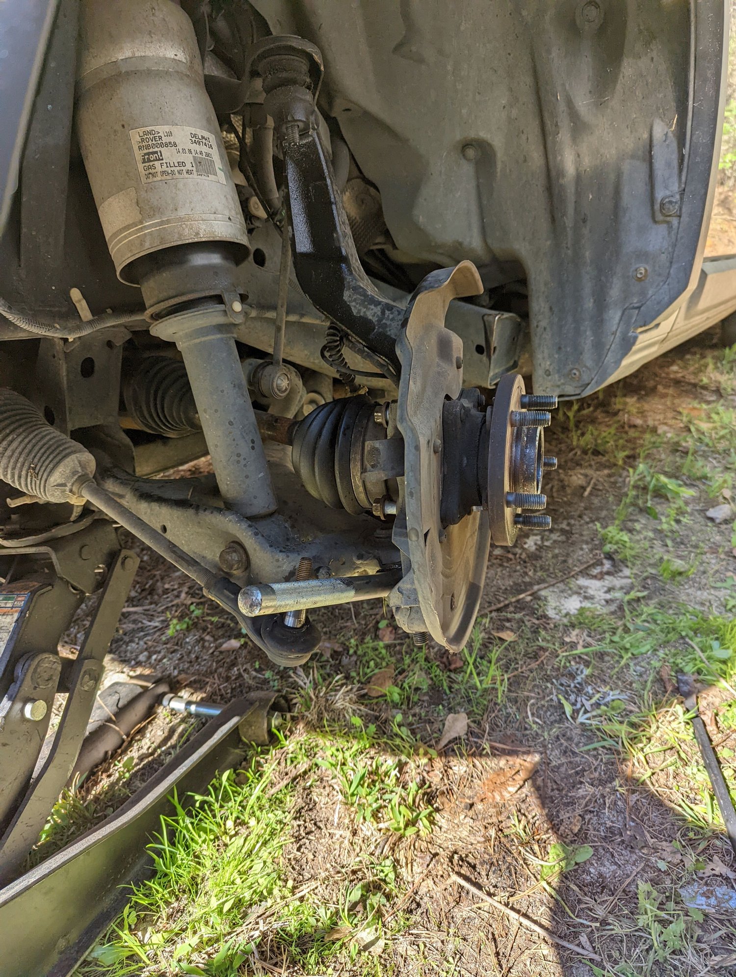

Spoke to soon the left front CV shaft is flinging grease everywhere....

Went in early and got it torn down.
It put up a bit of a fight coming out of the diff, but the right pry bar and a couple whacks with a 3 lb sledge and winning was the way.
I am still legitimately stunned AutoZone had that CV Shaft in stock. It does convert you to the 36mm nut so keep that in mind. So I put the last of the new wheels and skid plate on. Then loaded the trailer with a bunch of spares and a few cool things.
