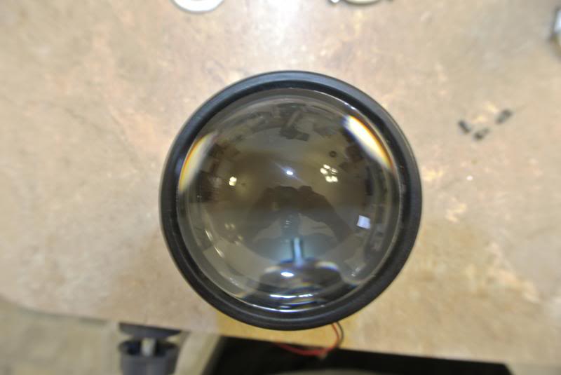

First you’ll need to get your parts that you want to use for your retrofit. The Morimoto Mini H1 6.0 is a great option because you don't have to cut too much and it is a direct fit for the Disco headlights. Shrouds you decide what you think looks best you can even make your own out of stuff from the hardware store. Bulbs and ballasts are the big thing people don't understand. You'll want to get a 4300-5000k bulb for the brightest output. I'd suggest DDM 35w kit or bulbs and ballasts from The Retrofit Source The higher Kelvin (K) bulb you go the lower the output in terms of luminosity. The projectors flicker is what makes your headlights look blue/purple from a distance not the bulb. Although if you buy 8000k+ bulbs everything just turns blue/purple including your light output and you might as well stick with halogens at that point because you won't light up anything in all honesty. Also you may ask why should I spend the extra money on projectors instead of running a plug n play kit? The projector focuses the beam giving you a nice uniform output that won't blind others when you're driving and is 3 times as bright as halogen set ups. You could use other OEM projectors they require more cutting and customization work I wanted something quick and easy for now because I hate halogen lighting.
The projector I used for my retrofit with the shroud that comes with the kit. Ignore the sharpie on the top I was sorting the 2 sets by color flicker. I didn’t use the shroud obviously.

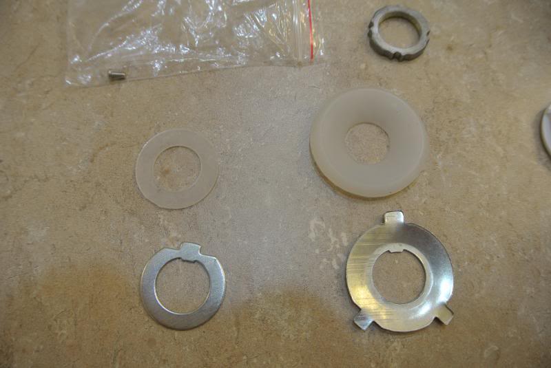

Mounting hardware that comes with it. The ring on the left and the rubber silicone washer are for H7 headlights the hardware on the right is for H4 headlights. Using the H7 mounting hardware on the projector you shouldn’t have to align the projectors after mounting.

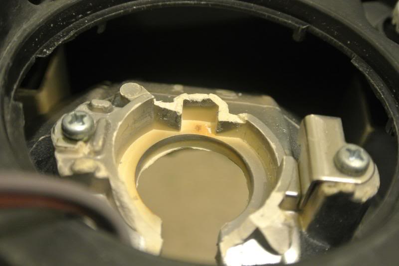

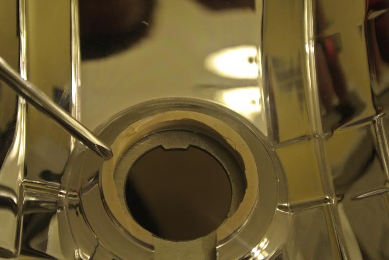

People do this step a couple different ways for speed sake I leave the reflector bowls in the housing plus I never paint the housings because I am a fan of the OEM look not a riced out look. You can remove them if it's easier for you to work with.
Back on topic in the rear of the housing in the low beam reflector remove the bottom screw and remove the glare shield (picture A below). Take your dremel tool and throw on a cutting disk or grinding wheel and grind down the front lip a little bit in the front of the low beam reflector bowl (pic b below) Now trim the rear of the housing a little bit (picture c below). Or if you’re not too destructive you can grab a pair of needle nose pliers you can break off a few pieces from the rear to mount the projector. Trim it down enough so that you can attach the locking nut and H7 mounting plate to the rear of the projector rear shaft. Just keep checking to make sure you have enough room without removing too much from the reflector bowl.

B
C
Once you removed enough from the rear of the projector put the small silicone washer on the projector and put the projector in the reflector bowl. Once inserted into the hole in the reflector bowl put the H7 adapter plate on the rear of the projector and put the locking hex nut on. You can use a deep well socket (27mm I do believe) to tighten down the hex locking nut tightly.
