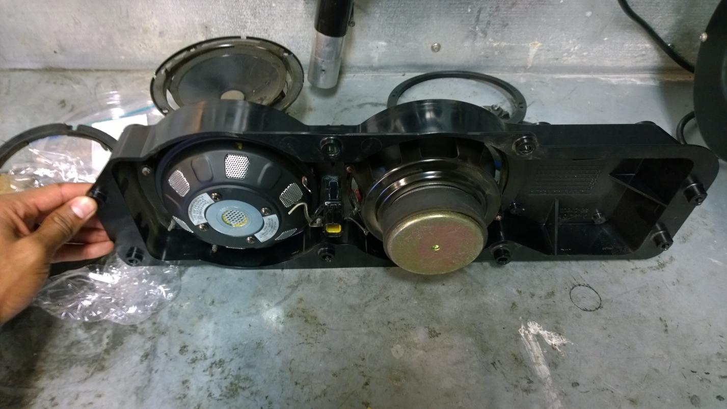

I stumbled across another option for people with blown speakers in the rear door. These are sws 6.5 woofer. They drop right in with no issues. Since they are a shallow woofer no trimming on the door is needed. The stock amp should have no issues powering them. They sound amazing. I didn't know a speaker so small could hit low frequencies so cleanly. I may replace the front door woofers with them. I got them off of amazon but they seem to be available through many vendors.

65$ is for the pair. They only sell them as pairs. I picked them because of their power ratings. The are designed for vehicles with factory amps. Anything asking for 600 watts will be too much for the stock amp to deal with and could end with either damage of the amp or distortion from not having the juice to control the voice coil of the speaker accurately.
