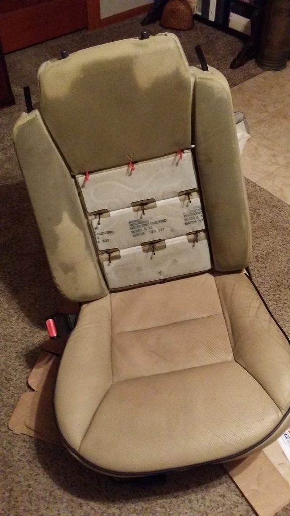

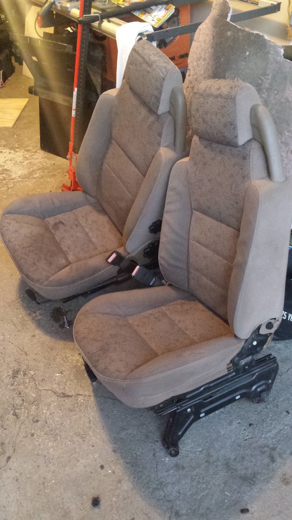

Over the weekend I was able to complete our new seats. When I say new I really mean new to us seats. Since we're going to be traveling in this car we wanted to eliminate some of the electrical items in advance. One area of concern were the powered seat, and the potential for the motors to go. I've been looking for D2 manual seats for several months now, and kept coming up with nothing. A couple weeks ago I came across a pair of manual seats on eBay from a seller in Virginia. I arranged to have them shipped to me, and the project began. In addition to the manual seats we wanted to be able to keep the leather, and the heated seats.
Here's what happened.
The seats came in.

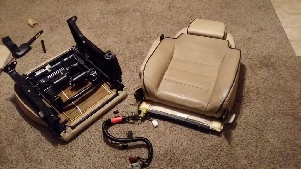

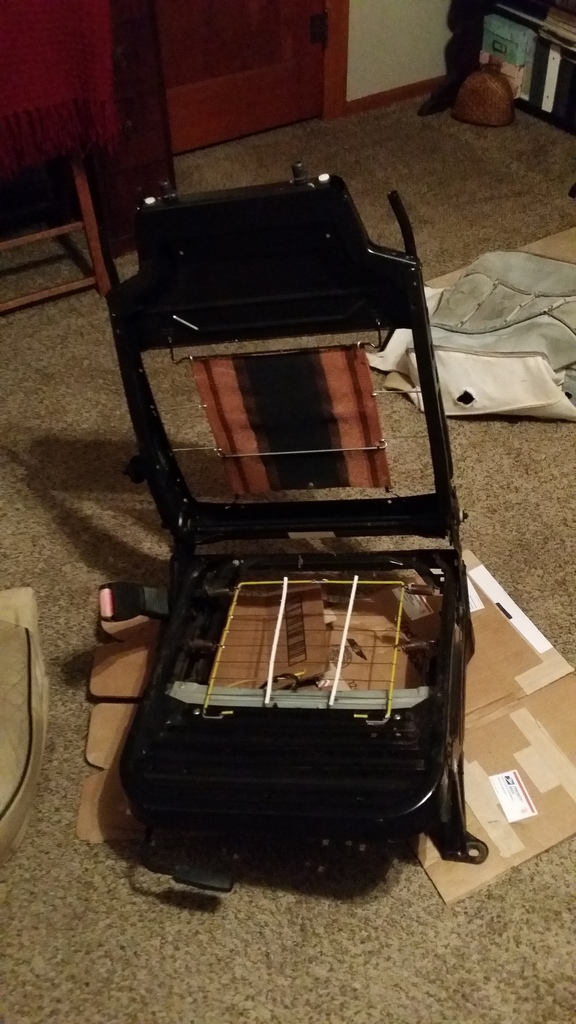

They got stripped down to the bare frame.

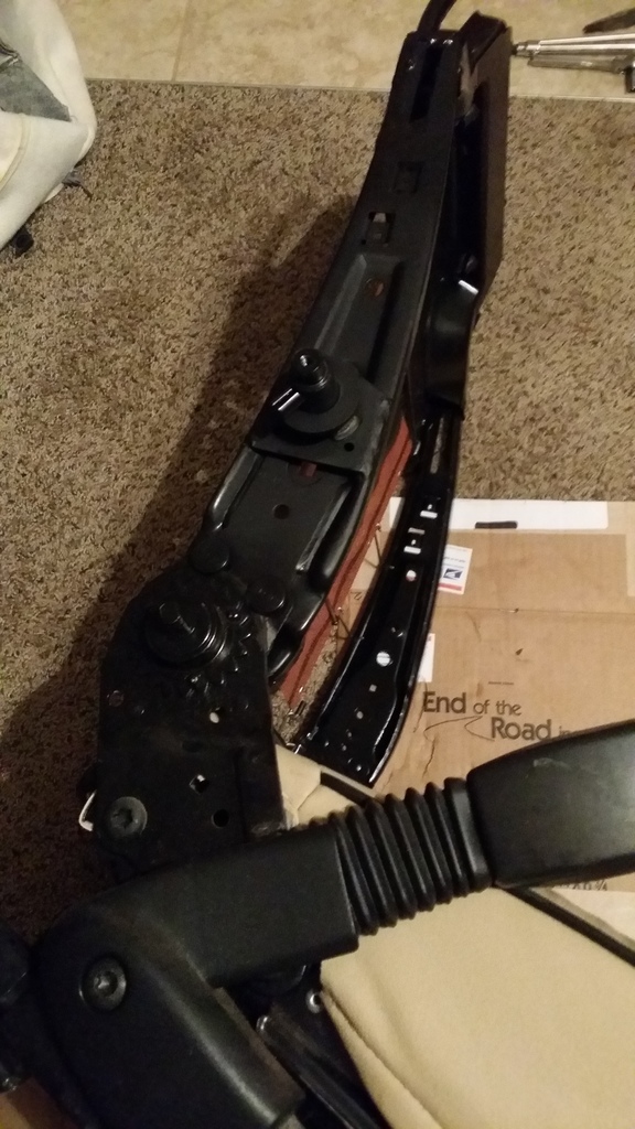

Next was unbolting the upper seat frame from the lower on the electric seats.

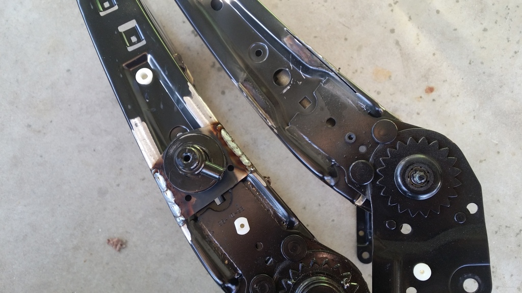

We wanted to keep the armrests too. I had to remove this part from the electrical seats, and weld the bracket on the manual seats. This bracket went in the same location as the manual lumbar ****. So that was removed.

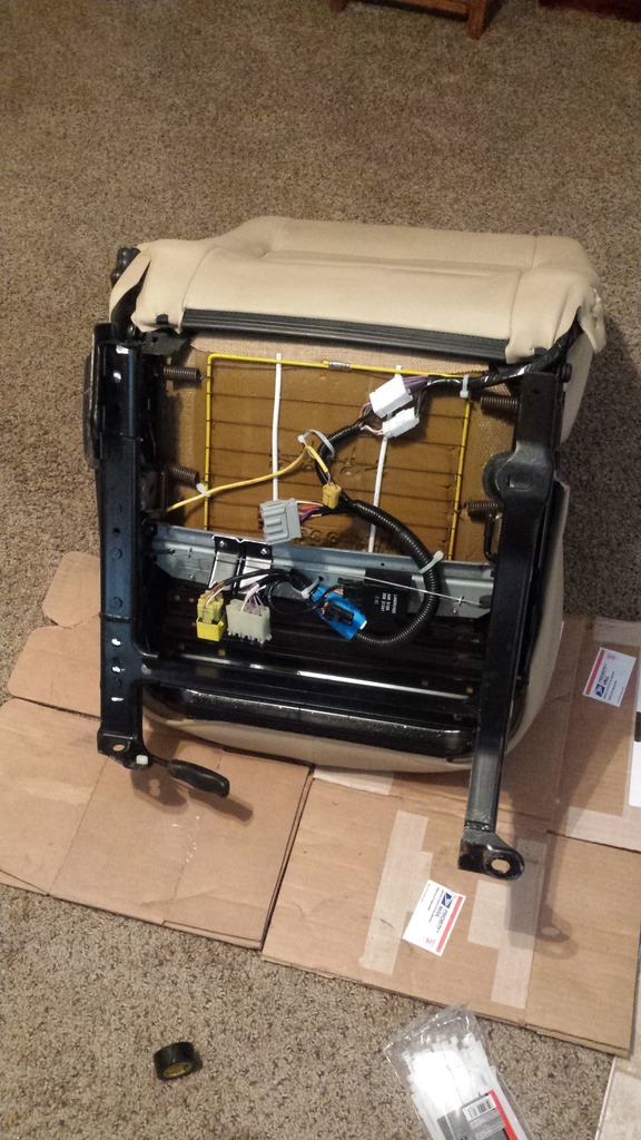

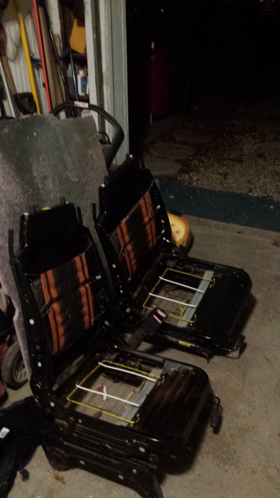

The new manual seat frame back together.
Moving right along to mounting the cushions. The bottom was easy, but the top was a PITA.

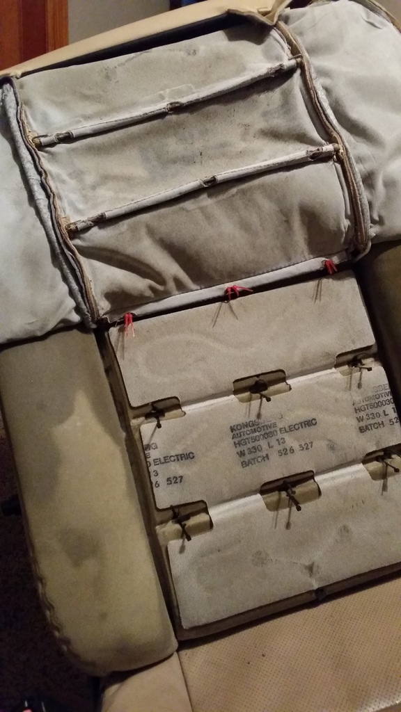

I had to remove a mount from under the electric seat, and install it on the manual to be able to hold the fuses. All wires are tucked up nicely, and out of the way.

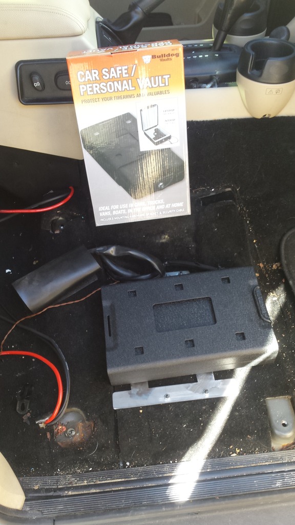

While the seats were out this was a perfect time to mount our Bull Dog car safe. The safe can be pulled out from the front seat through the old CD changer door.

I managed to find D2 manual cloth seats out of a 02. I picked them up from Will Tillery, or the person running his parts sales on eBay.

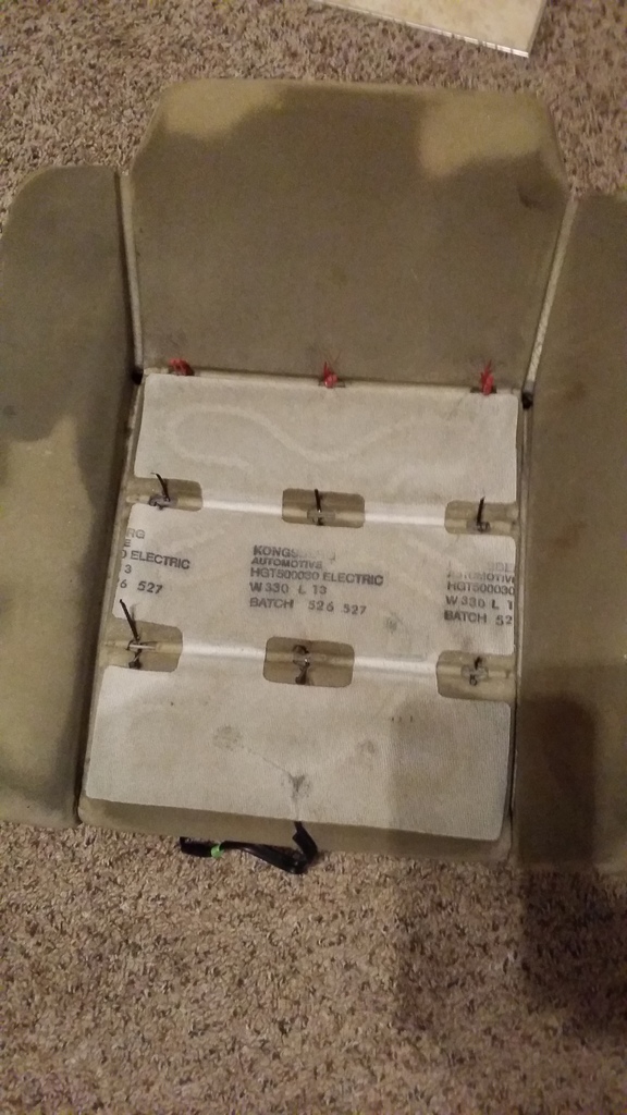

So the frames were exactly the same, and came with different options between the manual and powered versions. They still mounted to the same four mounting points, and all the trim fit as it should as well. I had to modify the upper frames to be able to use the armrests, but that's about it. Drill a couple holes on the upper passenger seat to attach the seat back diaphragm, and a couple holes on the bottom of both for the heated seat electronics.

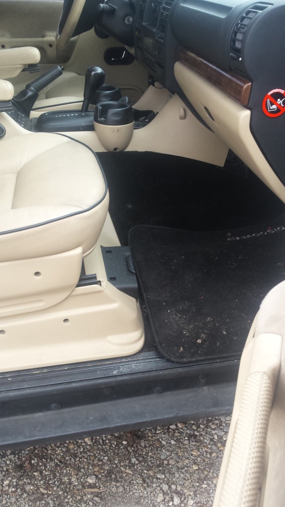

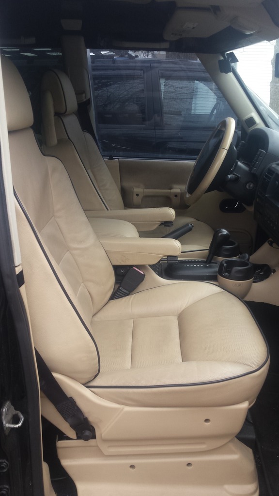

Here are a few pictures of the installed seats.

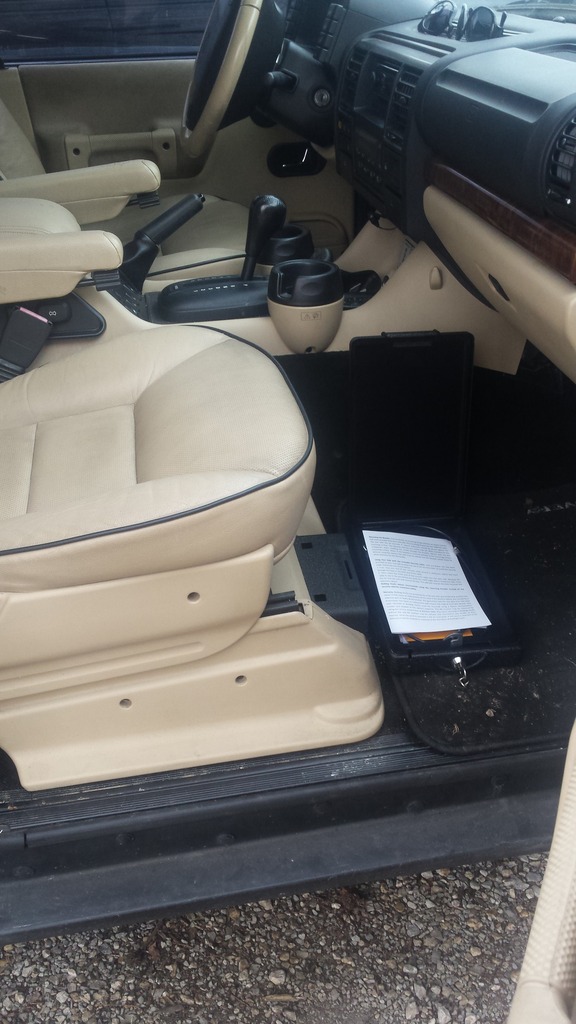

Here's the safe in the locked location.

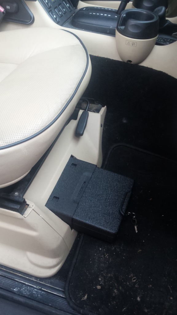

Here's the safe being slid out.
