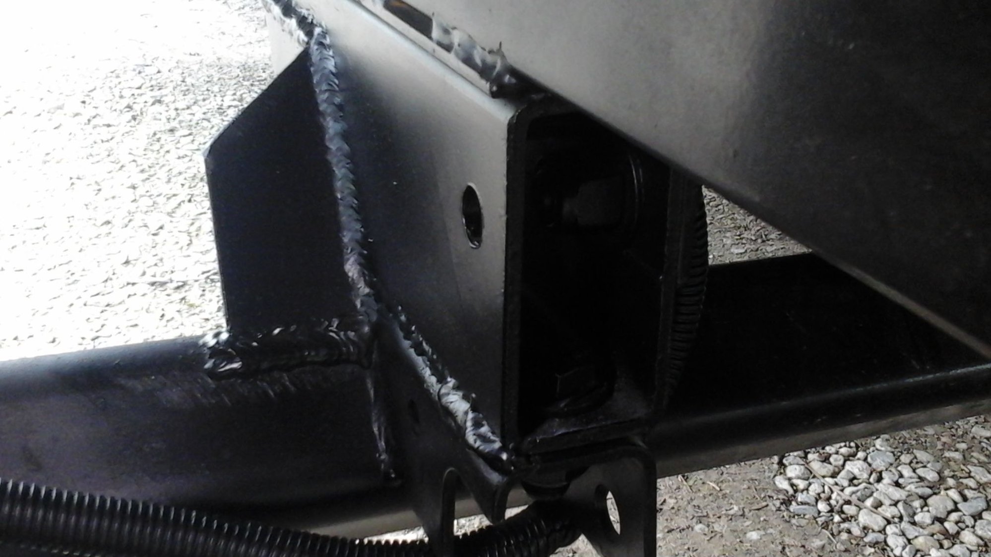

Put the lift kit in the travel trailer, too.
Before...
After...
Made the lift myself and added support brackets.
Lift blocks were 4", and added support gussets to outer edge for lateral support. The factory had 2 bolts connecting axle bracket to trailer...added 2 more for safe measure. Know this really isn't rover related...but at least you can see that l've not become a total slacker...lol.

Trailer looks good, I’m sure having it a bit higher will help with towing quite a bit!
