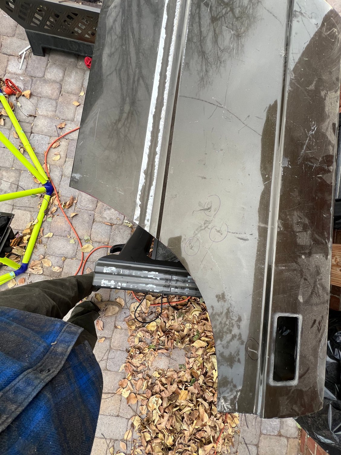

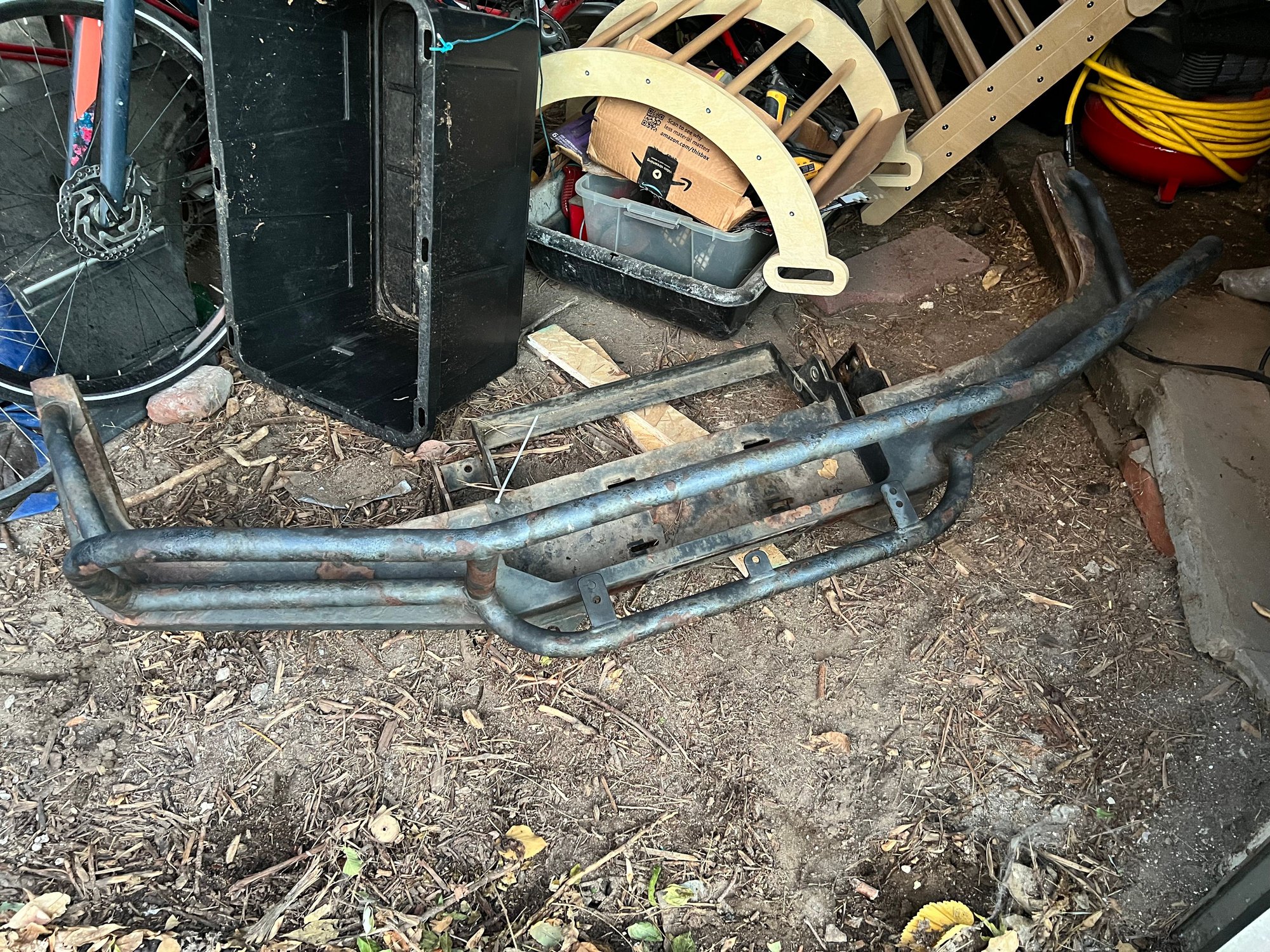

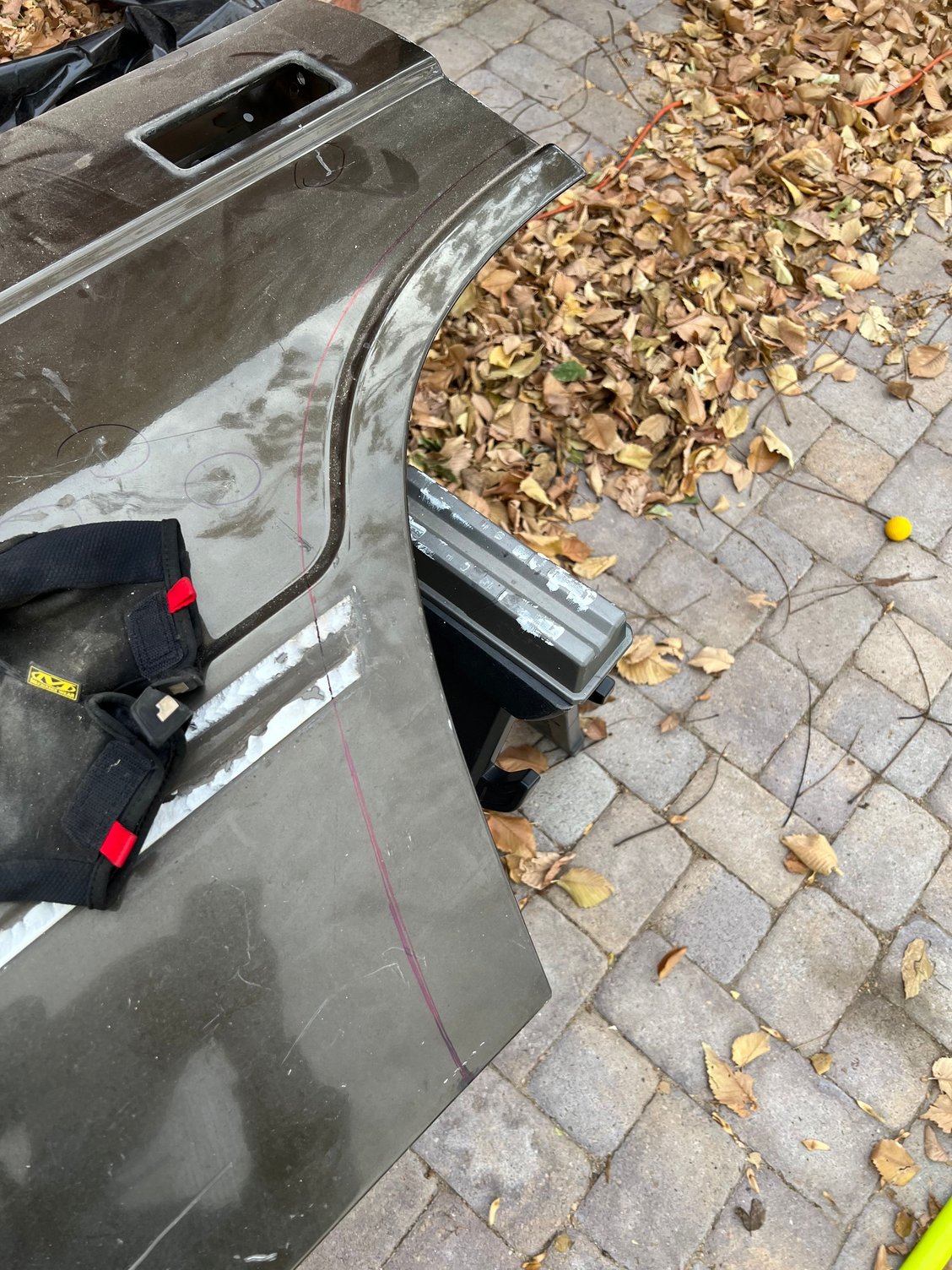

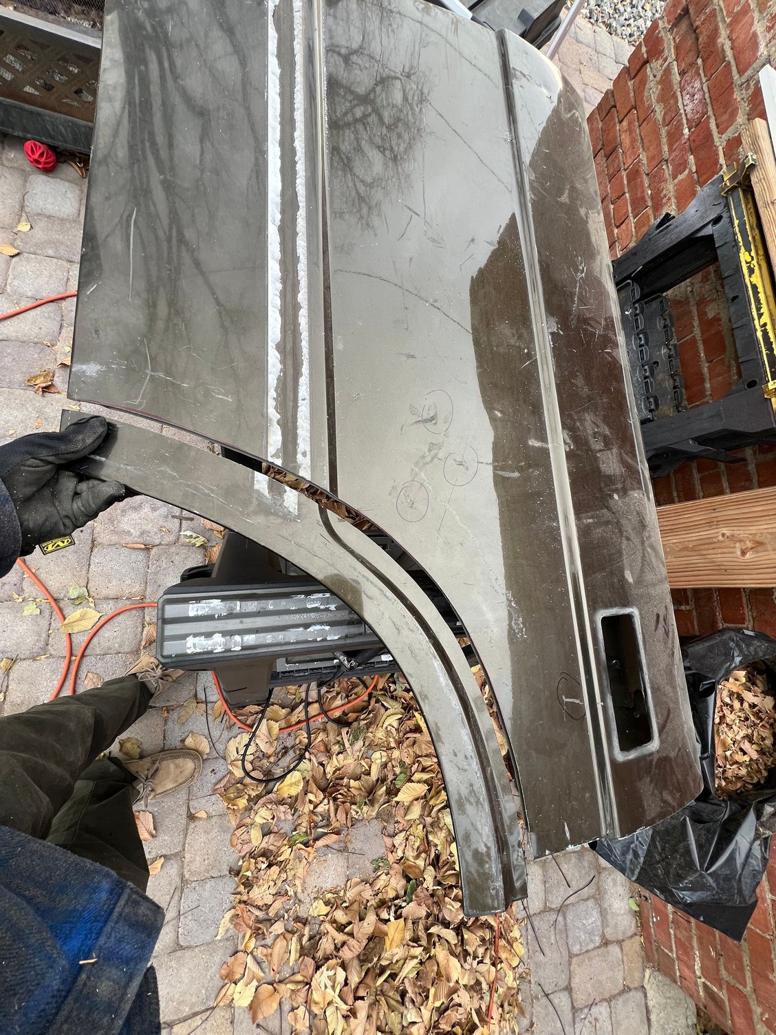

finally made some tangible progress, got the driver rear door cut that I had measured out over the summer. Time to get it sealed and prepped for paint sometime hopefully soon. Pic of RTE bumper, need to have it stripped so I can paint it before mounting it ideally.

It looks like what you removed is pretty much where the inner and outer skins still come together. Should be easy to mend them together. Are you going to try and roll the edge?
Is that bumper just painted...or powdercoated? The bumper l got from Bill (aka...slowest 110 builder in the world...lol) had an almost rubberized coating on it, started stripping it...but it turned into way too much work. So, l just cleaned up the worse spots and blew some paint on it. Figured it was going to get all scratched up anyway. Plus, l didn't want to spend the proper amount of time needed to do it right...and then end up taking over the proclaimed title of "slowest 110 builder in history'...lol. Which, with these 110's...it is a never ending story anyway.

I absolutely loathe terrafirma powder coating absolutely trash.
rte could be either paint or powder coat depending on the era. Great bumpers either way

Based on how it's kind of bubbling but not peeling I'm kind of going powdercoating, either way for $100 can't argue with a straight RTE bumper. We all know it's just surface rust lol those bumpers are borderline invincible.
Doors probably should have left a little to try and roll some, that would have been smart, maybe on the other one. Very much cut past where the two skins join, wasn't super concerned with getting them sealed up but somehow rolling that edge skipped my mind...

Yup those things are extremely stout any decent winch bumper for $100 is a winner
