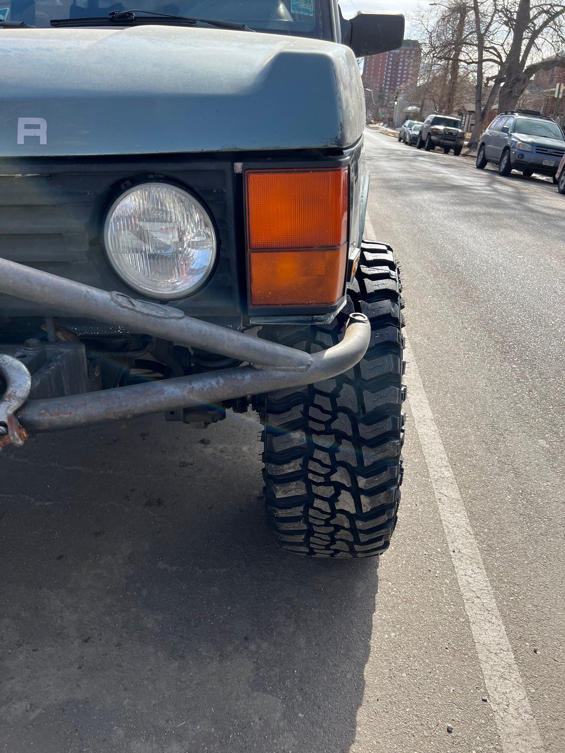

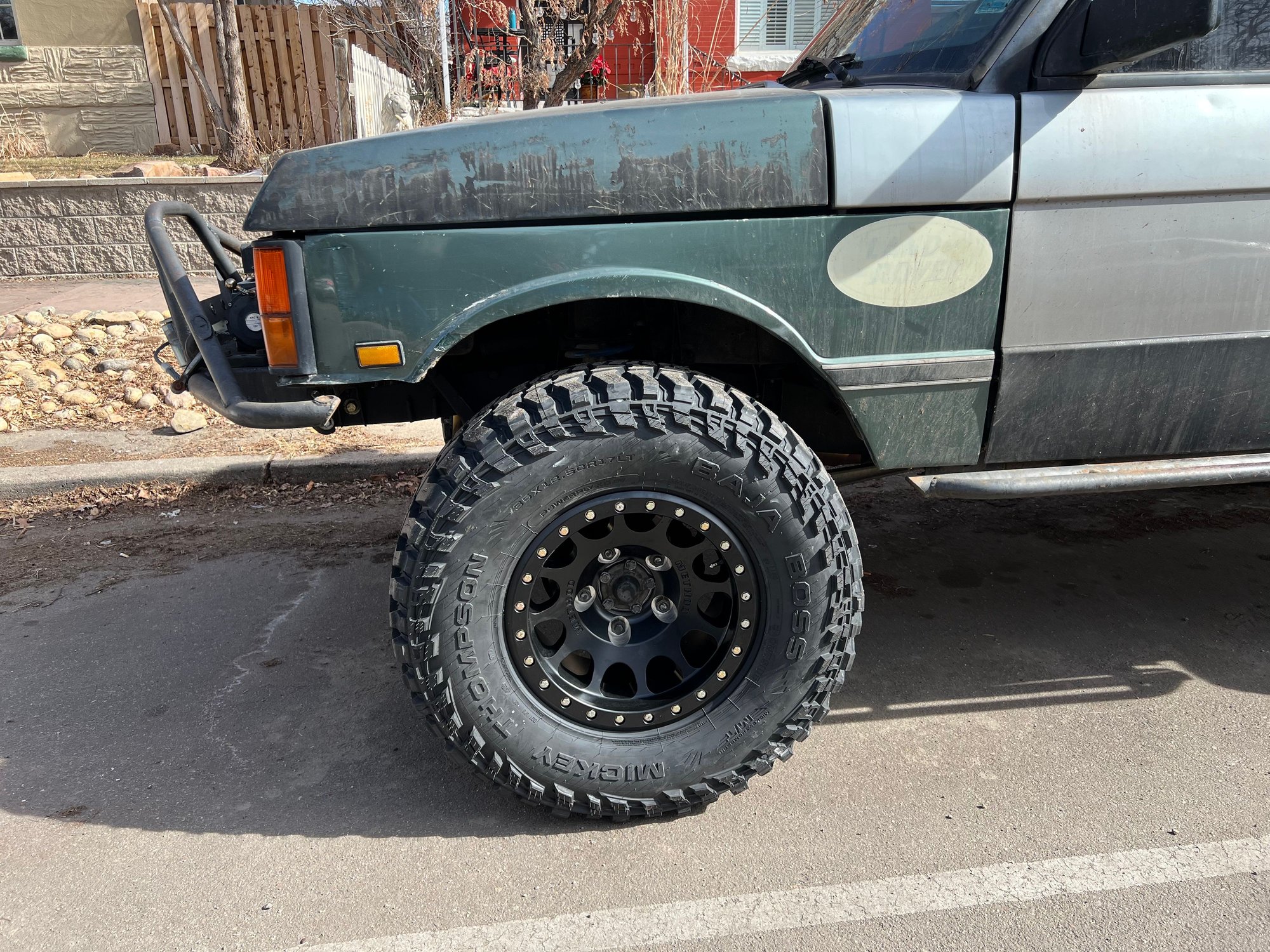

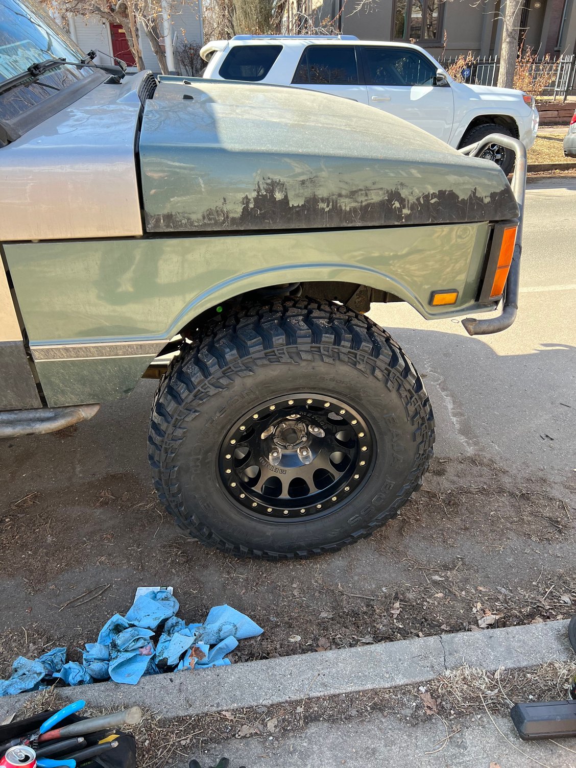

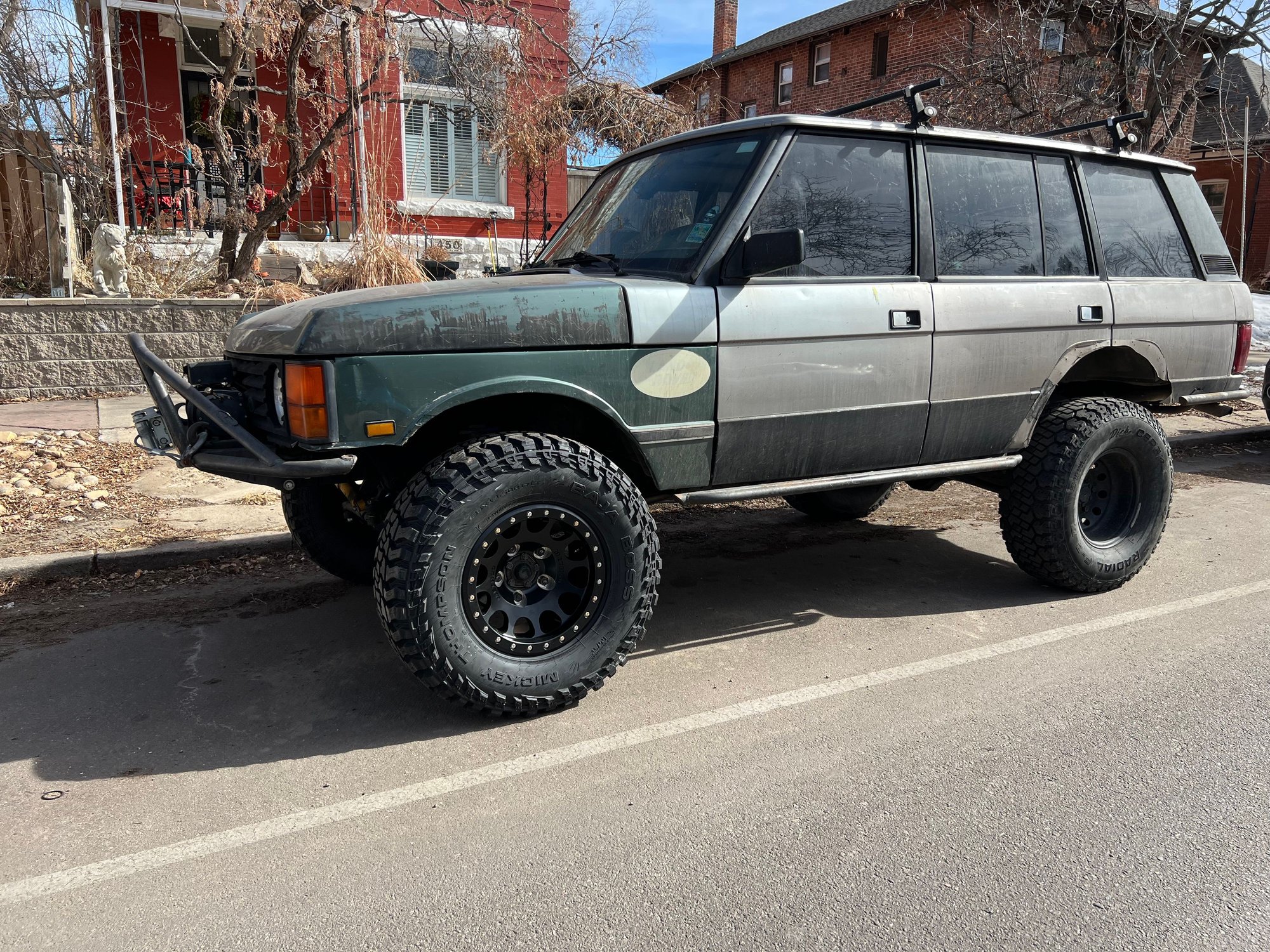

4th tire arrived today and all four are mounted up on the wheels. Will get to the hubs here soon and get these bad boys on the truck to rack up a few miles before I get them balanced and an alignment next week. Can't wait to see them on the truck!!

As of now 3 of the 4 hubs have been swapped out and wheels mounted. Really changes the whole feel of the truck. Body work is very much high on the list this spring as these wheels/tires have lit a bit of a fire under my *** to get this truck looking right. I have flares for when I get the body right but saving them until that time, mainly so I can confirm exactly how much trimming will be required in it's final form. Just going to sling everything all over the sides this week in Moab!! Will have lots more photos in the next week or so from that trip.

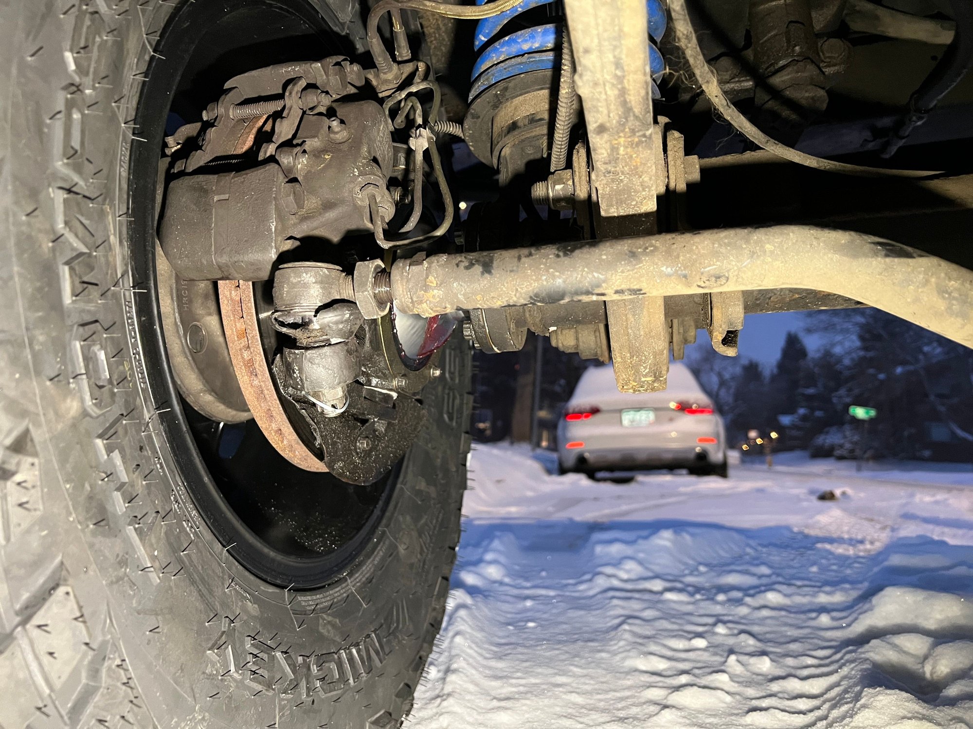

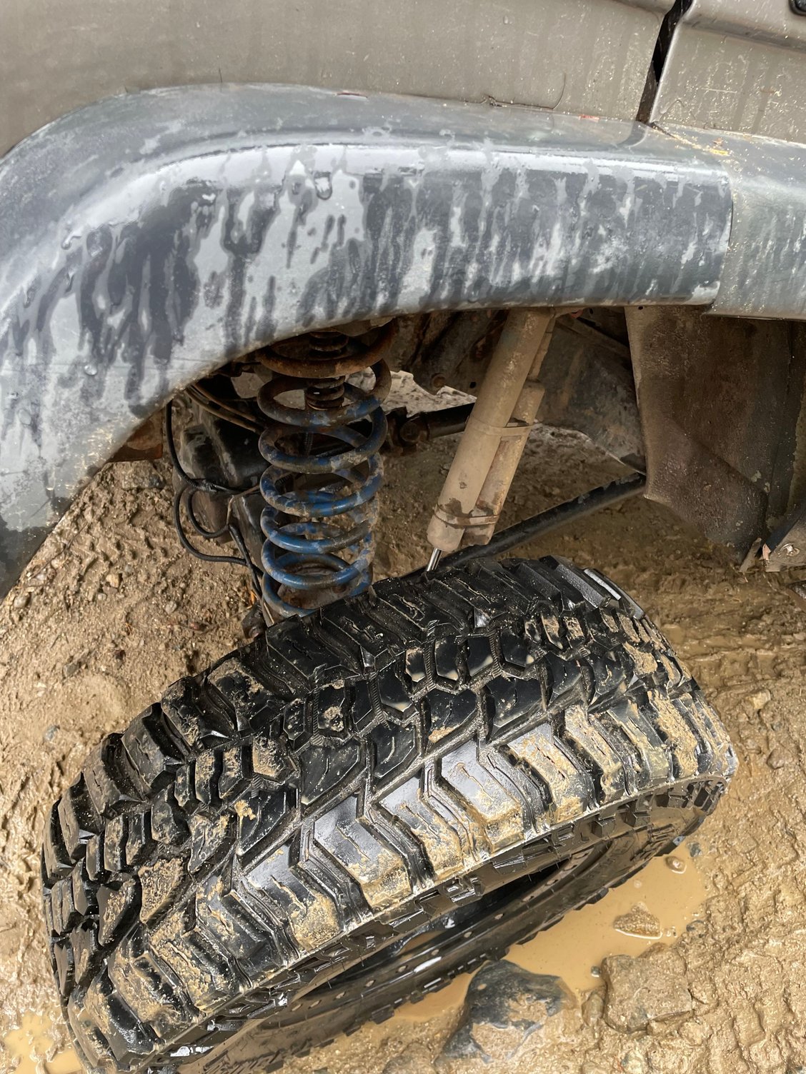

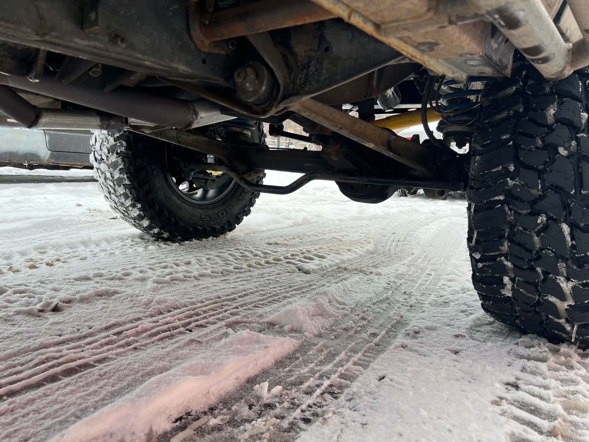

well got the tires balanced and attempted an alignment…as you can see they left the rear bar upside down and the jam nuts on it were uhh not tightened. Not even close. Got a partial refund before I left but hadn’t noticed the loose jam nuts at that point so they get a very angry phone call in the morning.
got it remedied and it’s off to Moab in the morning. Assuming all goes well the plan is to hit top of the world on the way into town.

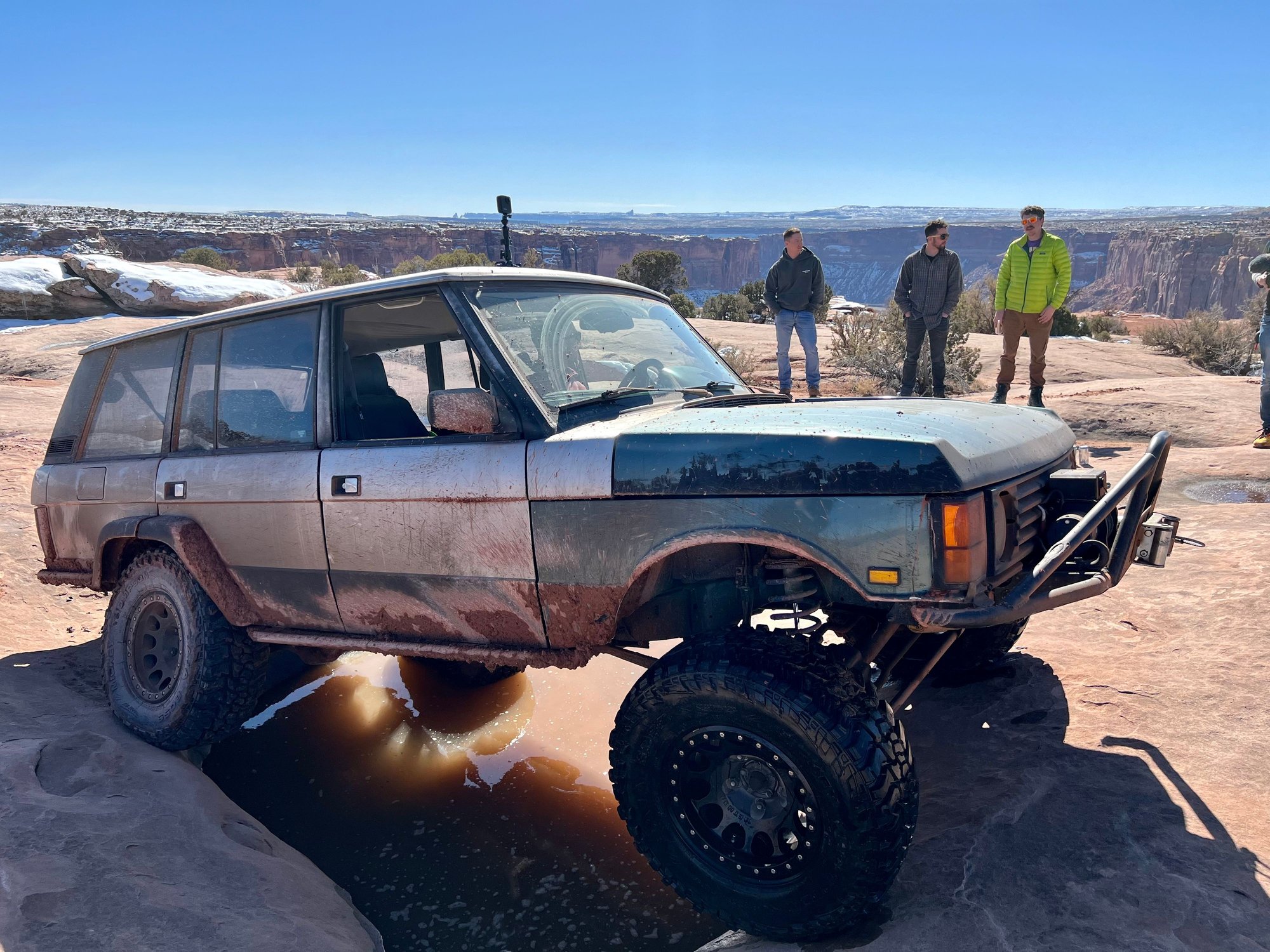

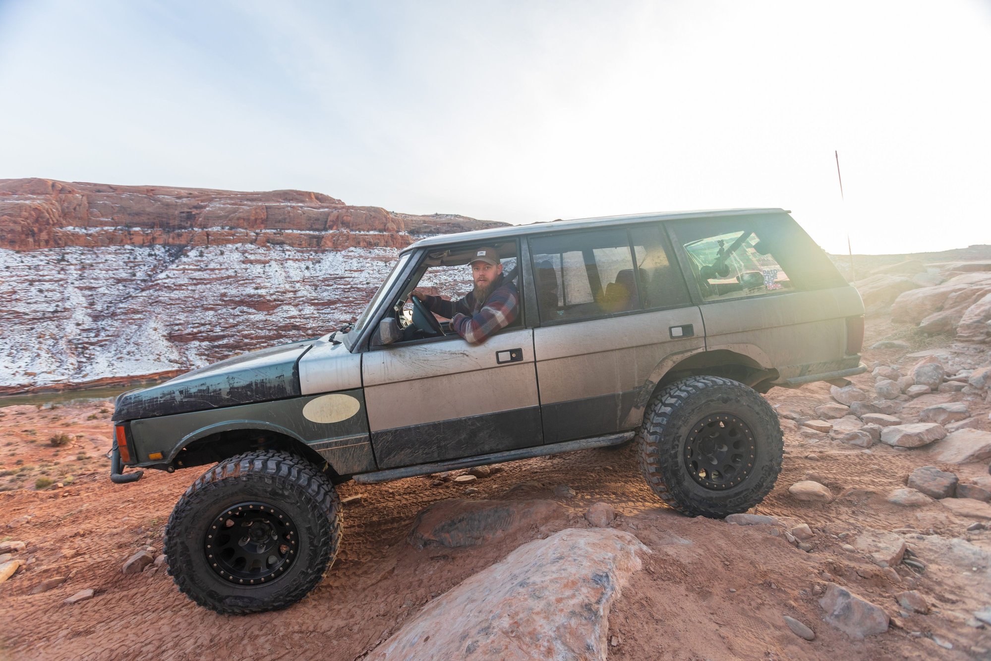

Another awesome trip to Moab is in the books! Truck performed incredible on the trail and almost made it home. Alternator went nuclear going up Vail Pass but we made it well within the 200 mile "free" tow with AAA so she more than did her job for a truck that I had driven as far as Boulder once....the new wheels and tires were amazing, and well worth the push to get them mounted and installed. We ran Poison Spider Mesa, Metal Masher and a combo of easier trails to an epic overlook that I won't be naming (not that hard to find if you really look for it out there). The LWB really provides a very stable platform for harder wheeling and really makes you reconsider ever wanting to wheel one of my D2s again. Not to mention it pulled up the highway better with 4 adults and gear out to moab than my white disco ever did with 2 people...that said I need to re-evaluate what I carry on trips as I may have the tools to rebuild anything but definitely not bringing enough spares. Live and learn as we would have had the alternator swapped in 15 min and back on the road home vs a tow truck.

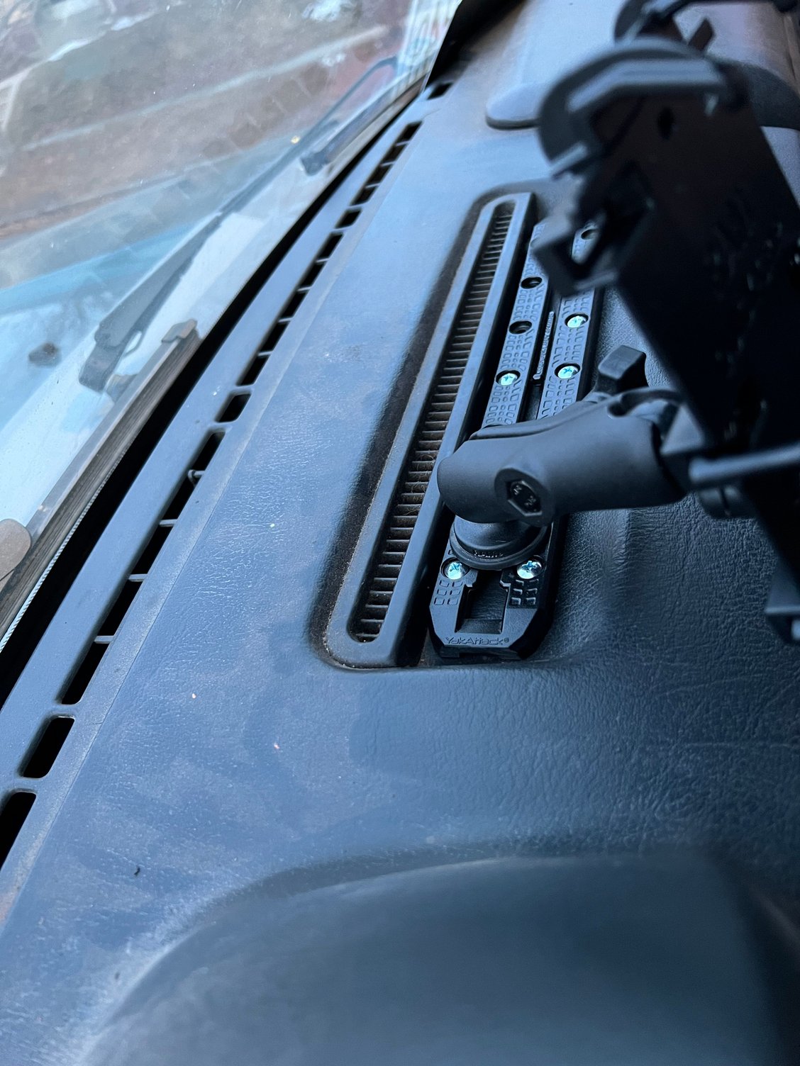

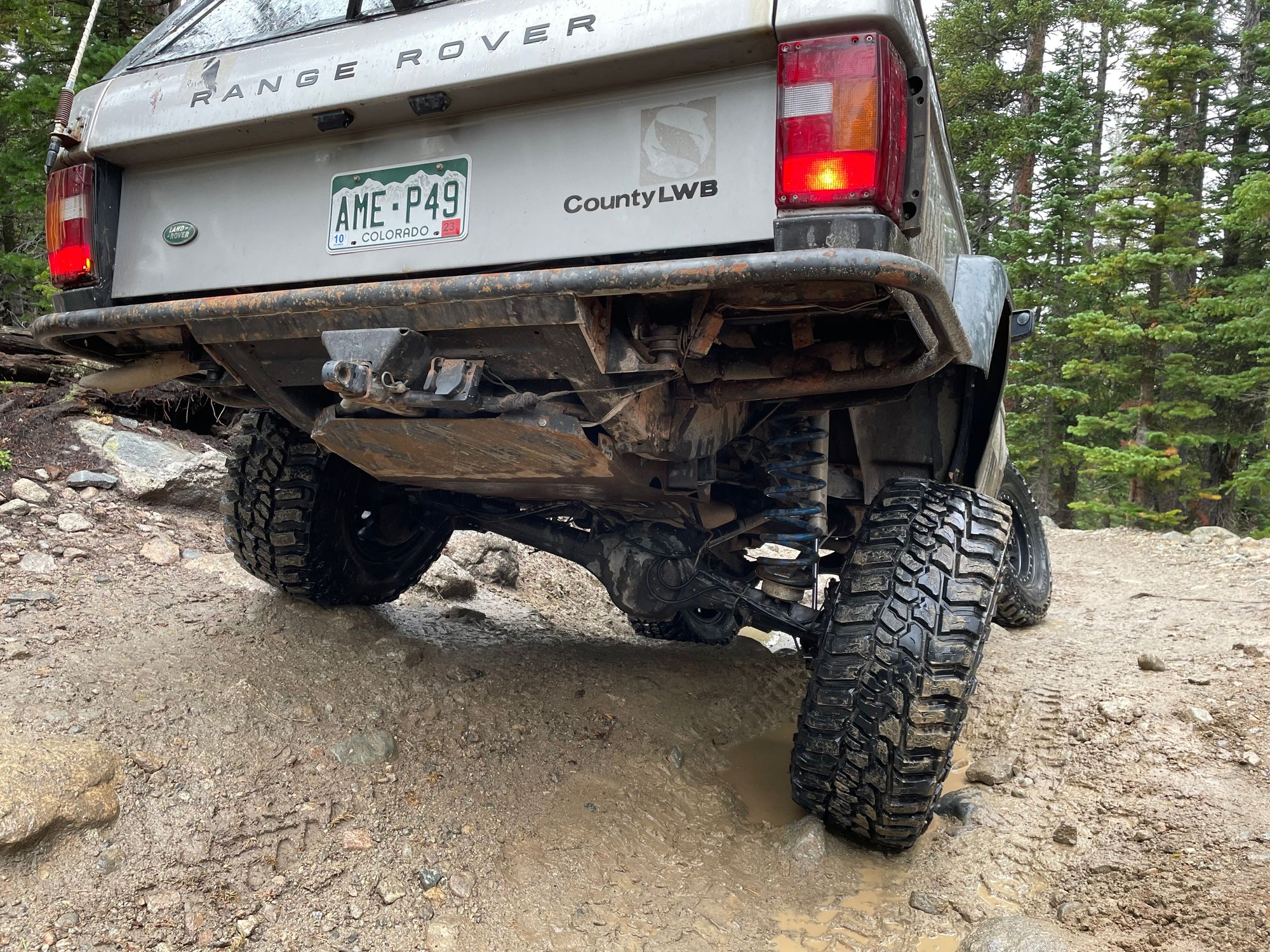

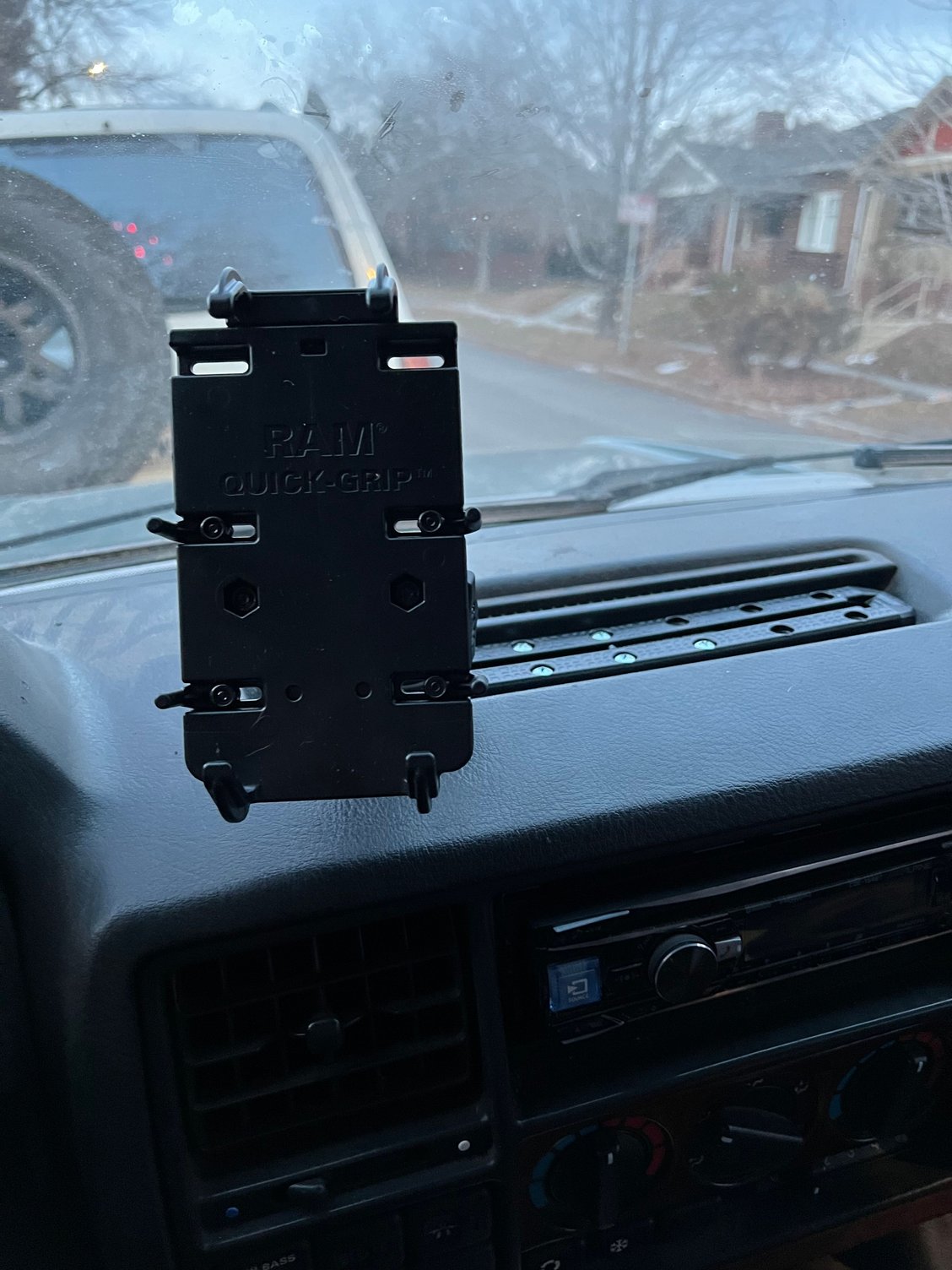

C
Couple pics from a trip last summer and then the new ram mount track and phone holder (this will also work for a d2 as it has the same upper dash shape).
