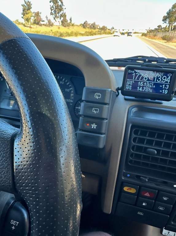

So I was today years old when I learned my cruise control works and that you PULL the lever to activate it:
At my friend's house:

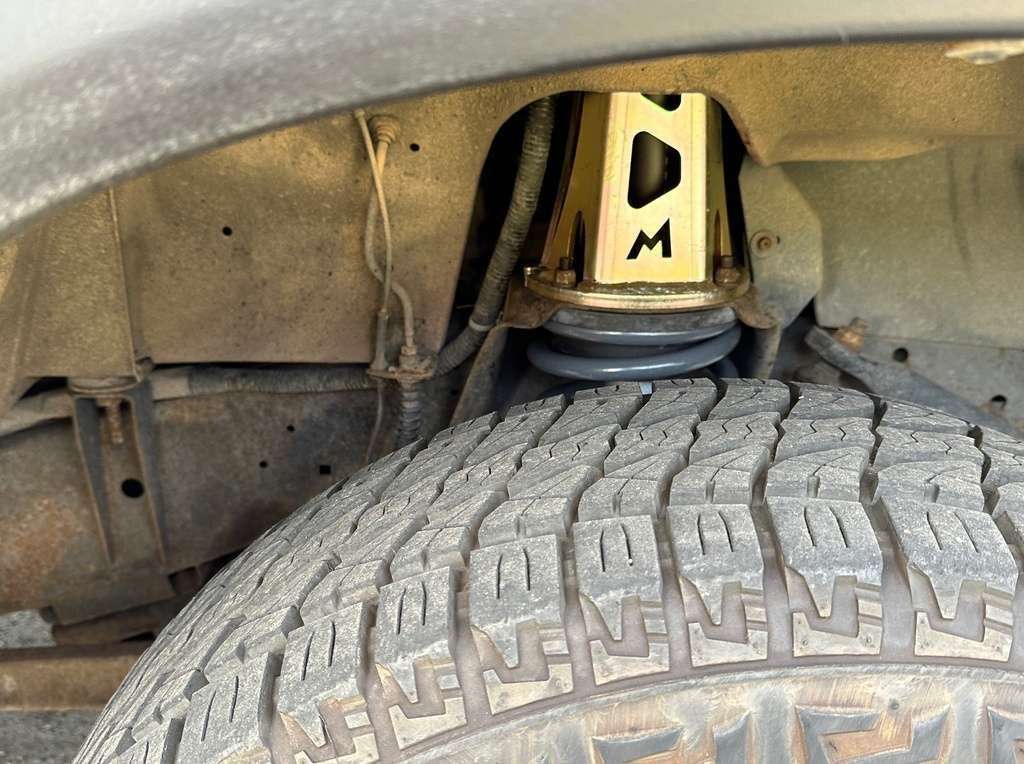

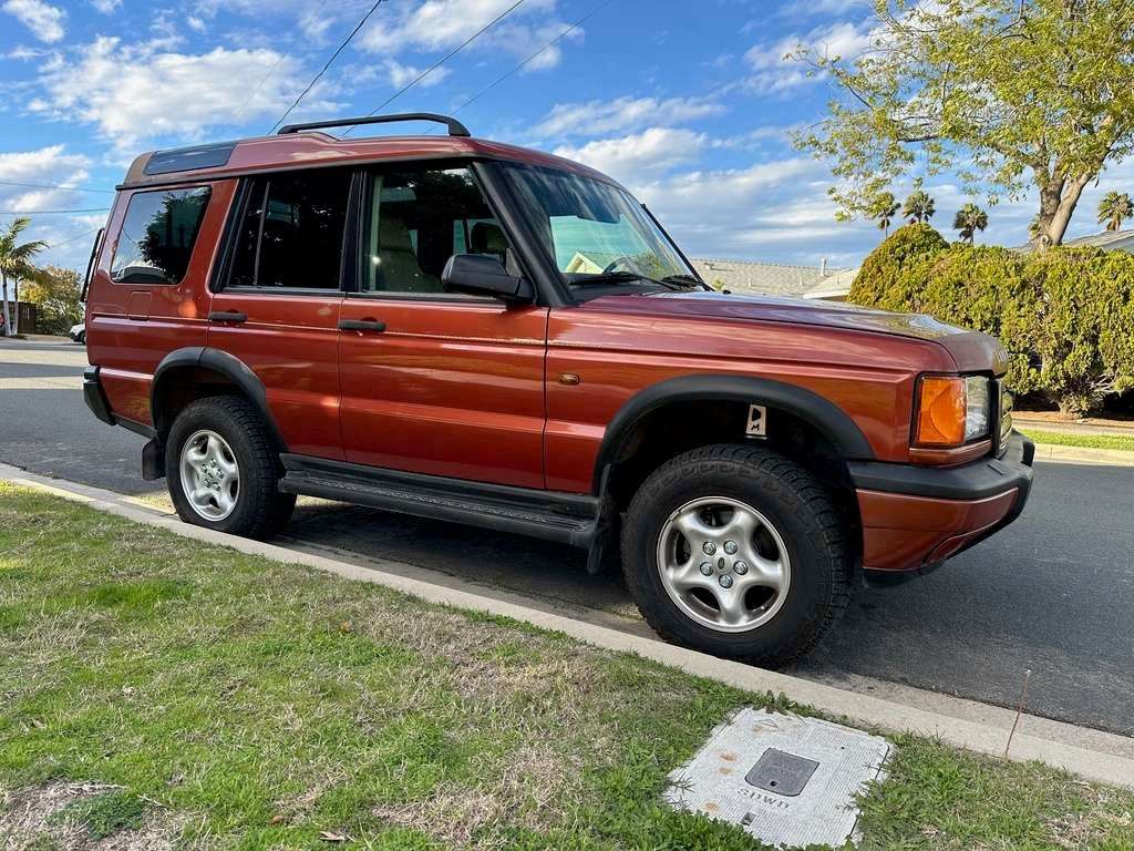

Picked her back up today! She got: all fluids and filters replaced (transmission, transfer case, both diffs, brake fluid, power steering), new Terrafirma medium duty suspension with new shock towers and steering damper, new calipers, rotors and pads, and the vacuum leaks fixed. No more codes!!
Here she is with the lift. Does it look like she skipped leg day??
The new shock towers and shocks

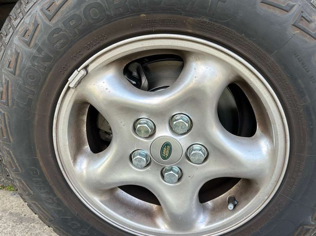

And, one of the best things, new one-piece lug nuts. Shipping from England costs a pretty(ish) penny, but not having to deal with the jacked up lug nuts is worth it:
She rides so much better now, I guess the original shocks were really shot.
