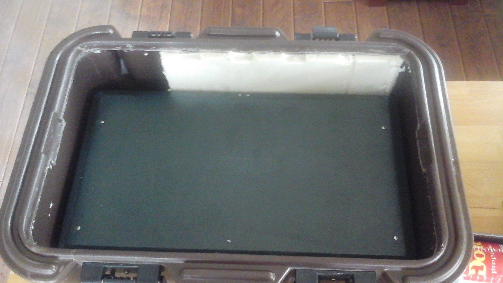

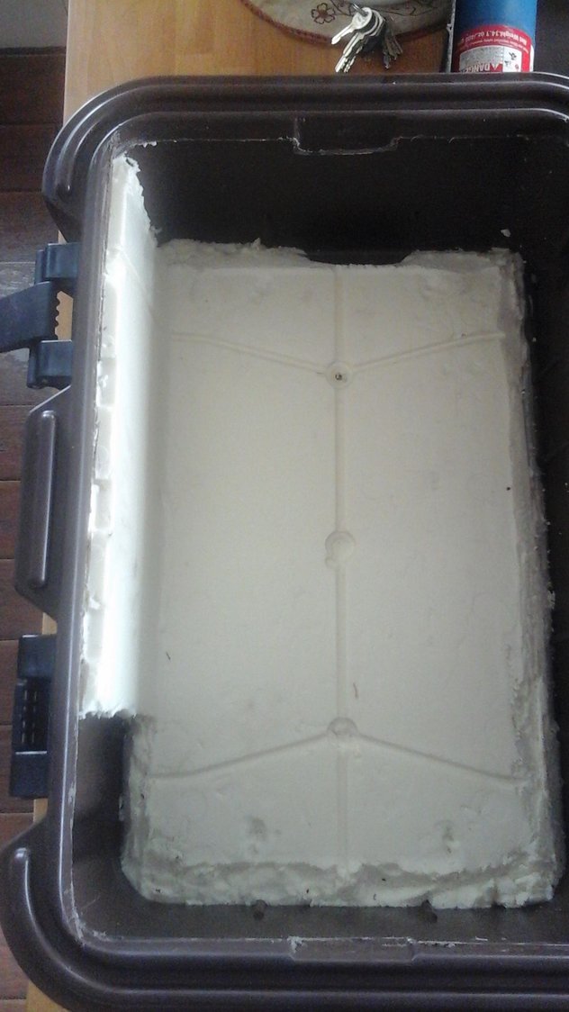

Started messing with a couple of the containers l'd acquired out of a dumpster. I'm able to utilize 4 or five containers under my sleeping platform.
Wanted to use one for the Coleman stove, but it wouldn't fit...that is...until I cut the inner portion out and removed some foam insulation.
Left some insulation on the bottom and front portion, notching it some to allow for the *****.
Stove in place.
Took the leftover plastic inner piece and cut it down, height wise, so it became a tray that will sit on top of the stove.
Tray in place with propane tank. I'm going to cut a piece of foam to lay between the stove and the tray, and have a piece that is molded/formed to hold a couple tanks and stove fittings (and maybe a torch tip) for the tray.
I'll remove the inner portion from one or two more, for dry foods and cookware.

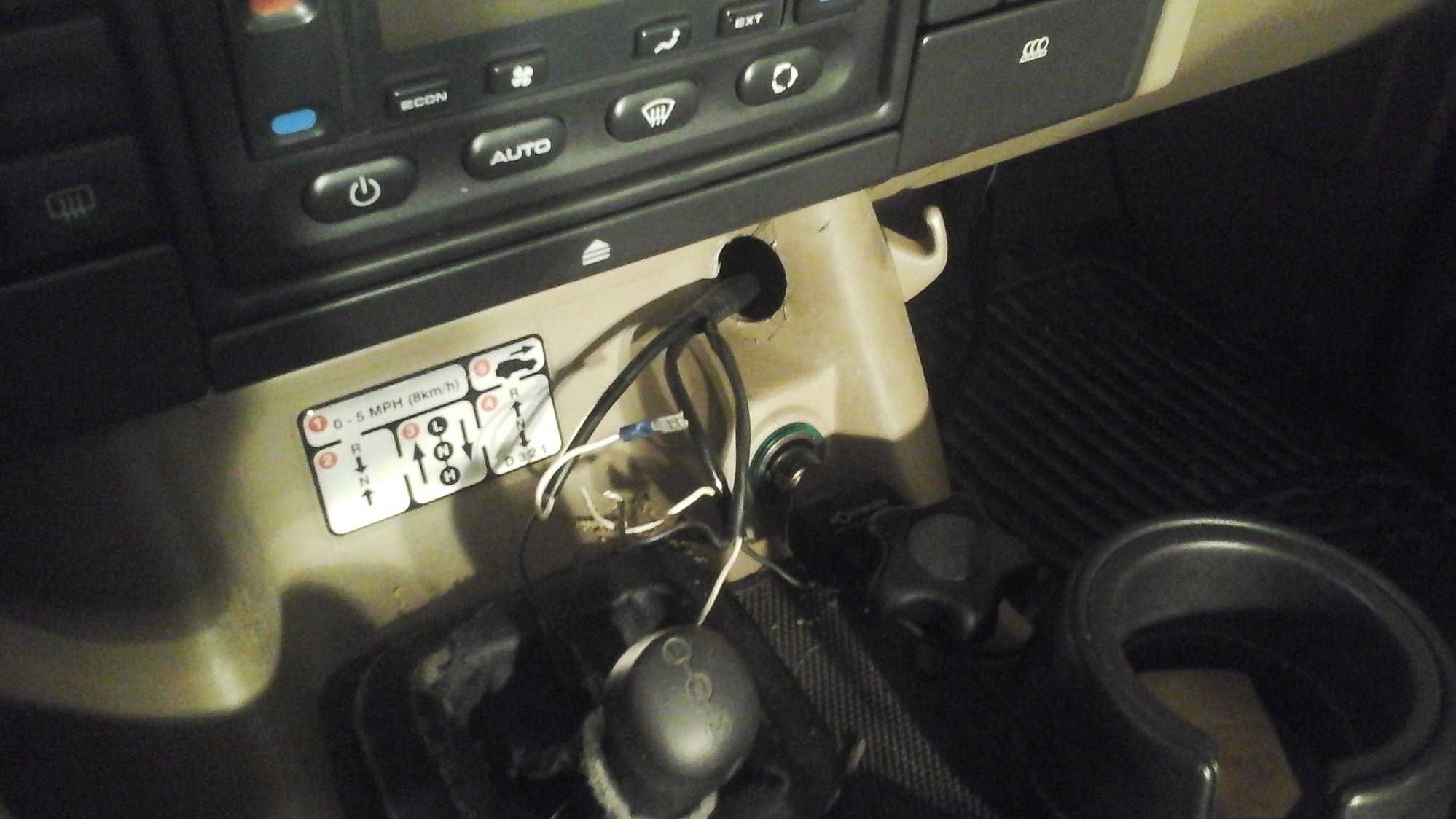

Worked on making a switch panel for front winch, "someday" rear winch and driving lights. First two switches are for in-out operation (front winch), second two will be for same (rear winch) and empty spot is for driving lights (need switch). Winch switches will have separate switched power source, that way they won't be activated by accident or by grandson(s).

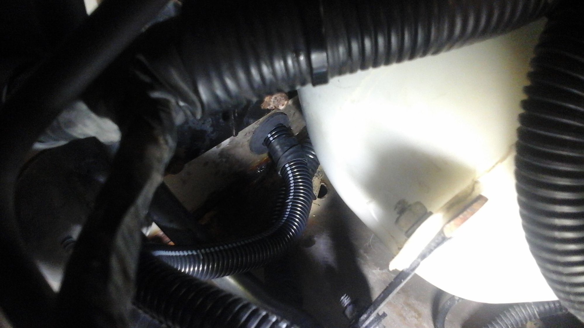

Wires ran.
Lucked out, nice rubber plug just beneath the washer reservoir (or where SAI motor use to be mounted). Removed plug, cut hole in it and fed wires through.
