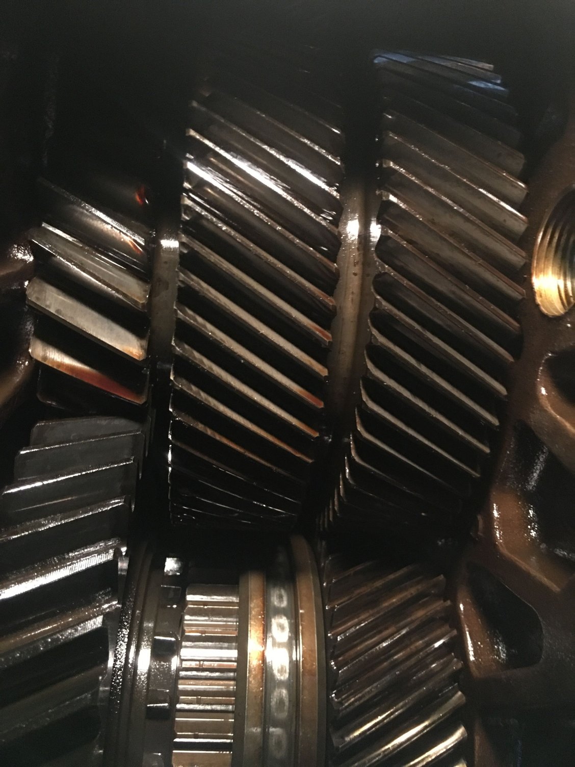

Hey guys, new here, but figured I'd start a build thread. Want to keep track of what I'm doing and hopefully get a little help and insight and possibly help anybody else out who may try the same with theirs. Bone stock 2002 Disco 2 I bought for $900 from an older guy who never took it off-road and took pretty good care of it. It's got a few leaks that he said he was getting too old to worry about anymore. Transfer case is stuck in 4hi. I figure since he's never shifted it into 4lo it's probably seized. Plan was to put a CDL transfer case in it so no big deal. Crawled underneath it this weekend to do some looking around. Very little rust... Happy about that! Looks like the front drive shaft has zerk fittings on it, so he's taken care of one of the major issues.
While I'm under here I decide to change out the fluids in the diffs and transfer case. Got the fluids changed out in the front and rear diffs. the fluid looked pretty clean, but not knowing all of the history I changed it all out to 85w-140. On to the transfer case. Holy hell, who put the fill plug in?.... Took 2 hours or fighting with it to eventually get it off. I start to drain the fluid and only about 1/2 cup comes out. Well damn... I decide to pull the cover off the transfer case to take a look and see how bad the damage is. Wonder how long it's been low on fluid. Doesn't look too bad, but I'm no expert, what do you guys think? Should get me by until I can do a cdl swap??

I’d say put in new fluid and drive it. Have fun with the build.

Transfer cases are pretty durable - I agree fill it back up and you should be good

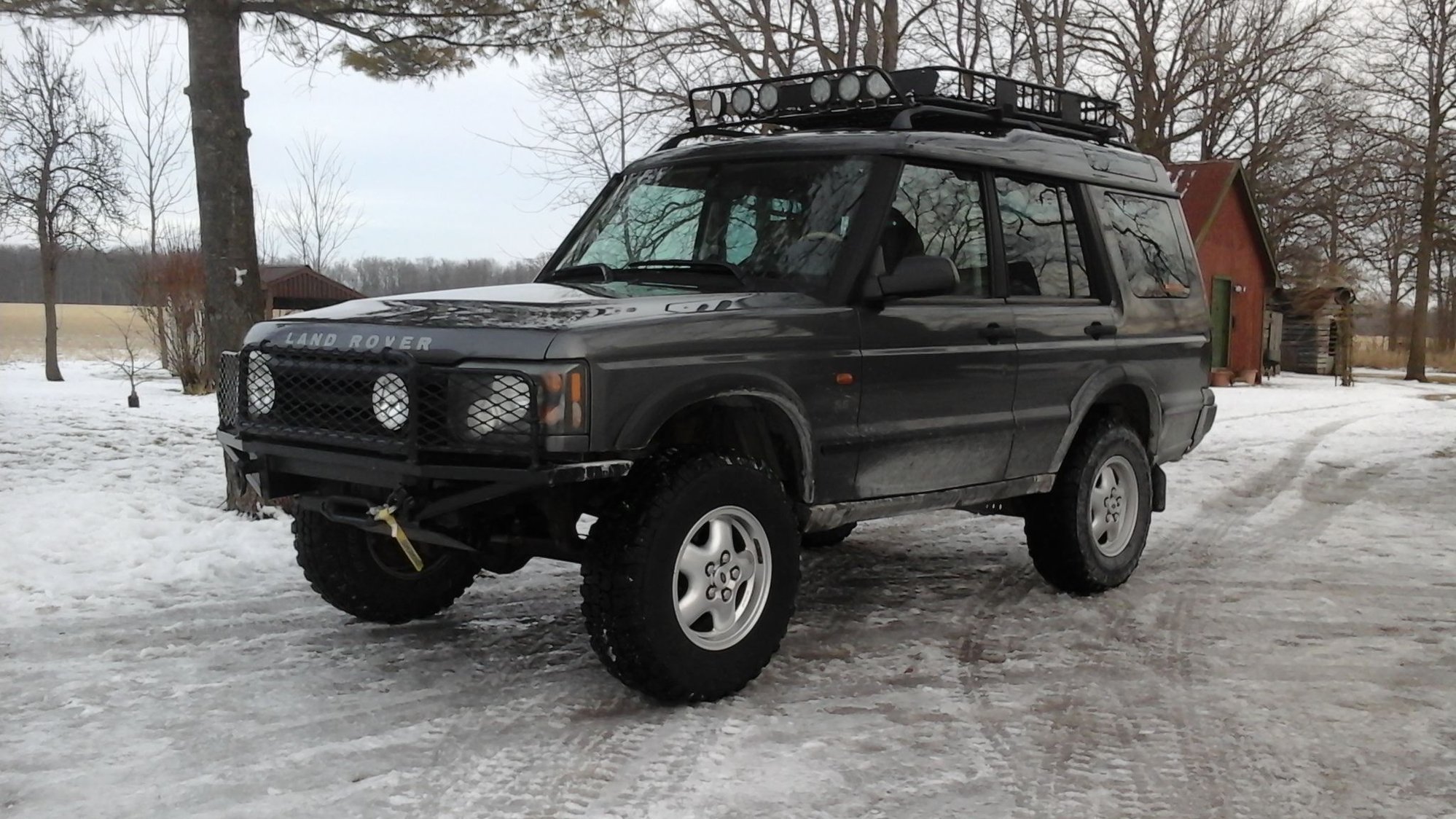

My gray 03 had a 3" inch lift, 2" springs and 1" spacers. Seemed just right to me, even had both sway bars removed and seemed stable enough on the road. Had 265/75's on her, but always inteded on going 285's next time around...but...that never happen. Me and this Dll got off to a rocky start...and it contunied to the point that she beat me down. It had a bad frame, rear section, when l bought it and l planned on welding in a new section, but after all of the other issues...she got scrapped.
Second picture is my 01 White Gold Dll...her and l had specially times. Still miss her, never left me stranded once.
Good luck with your build.

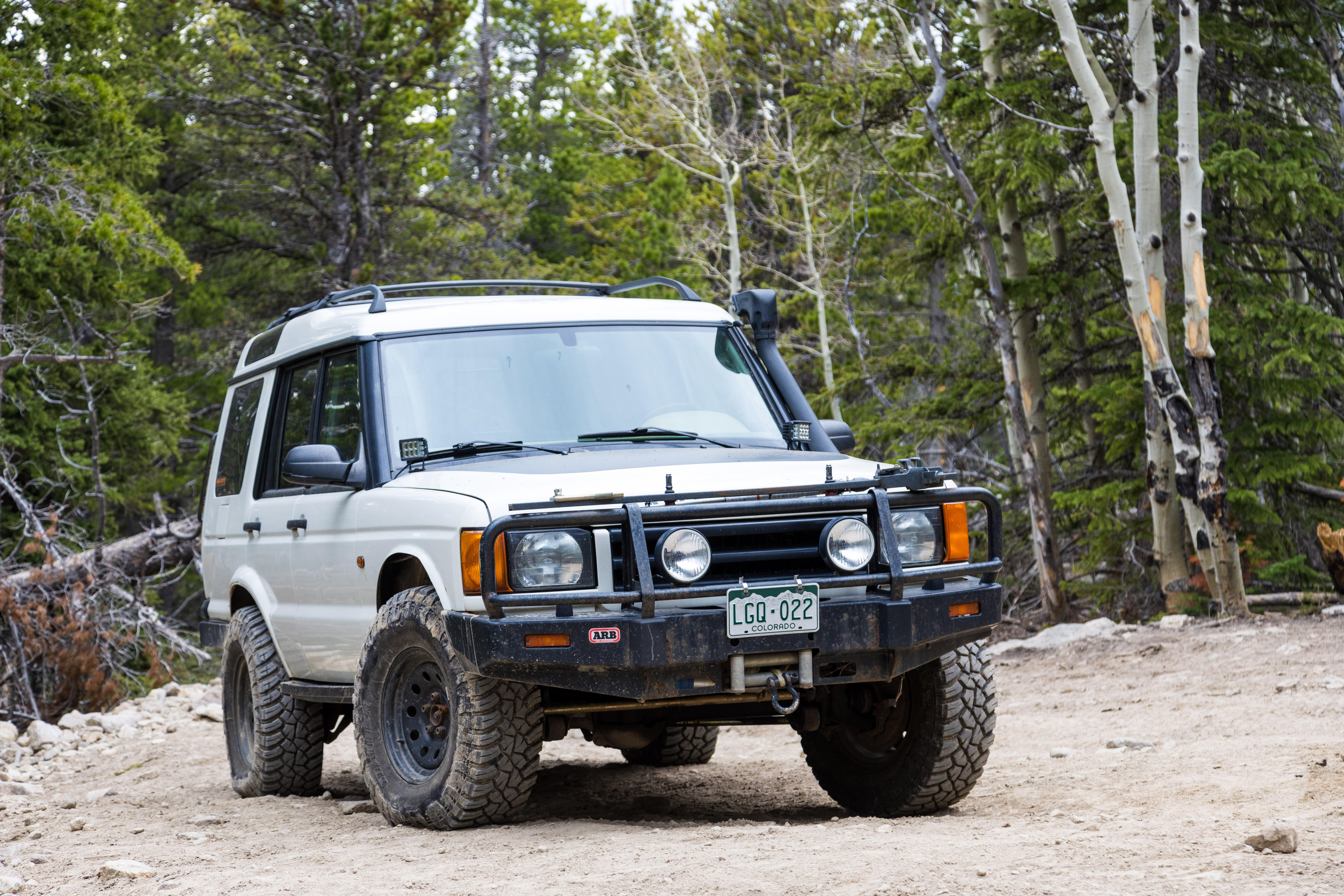

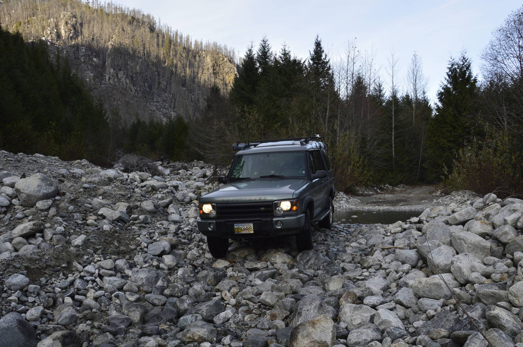

Here is my 04 :
2 inch Terrafirma MD springs and OME nitro charger shocks 2 years and so far has always got me home.

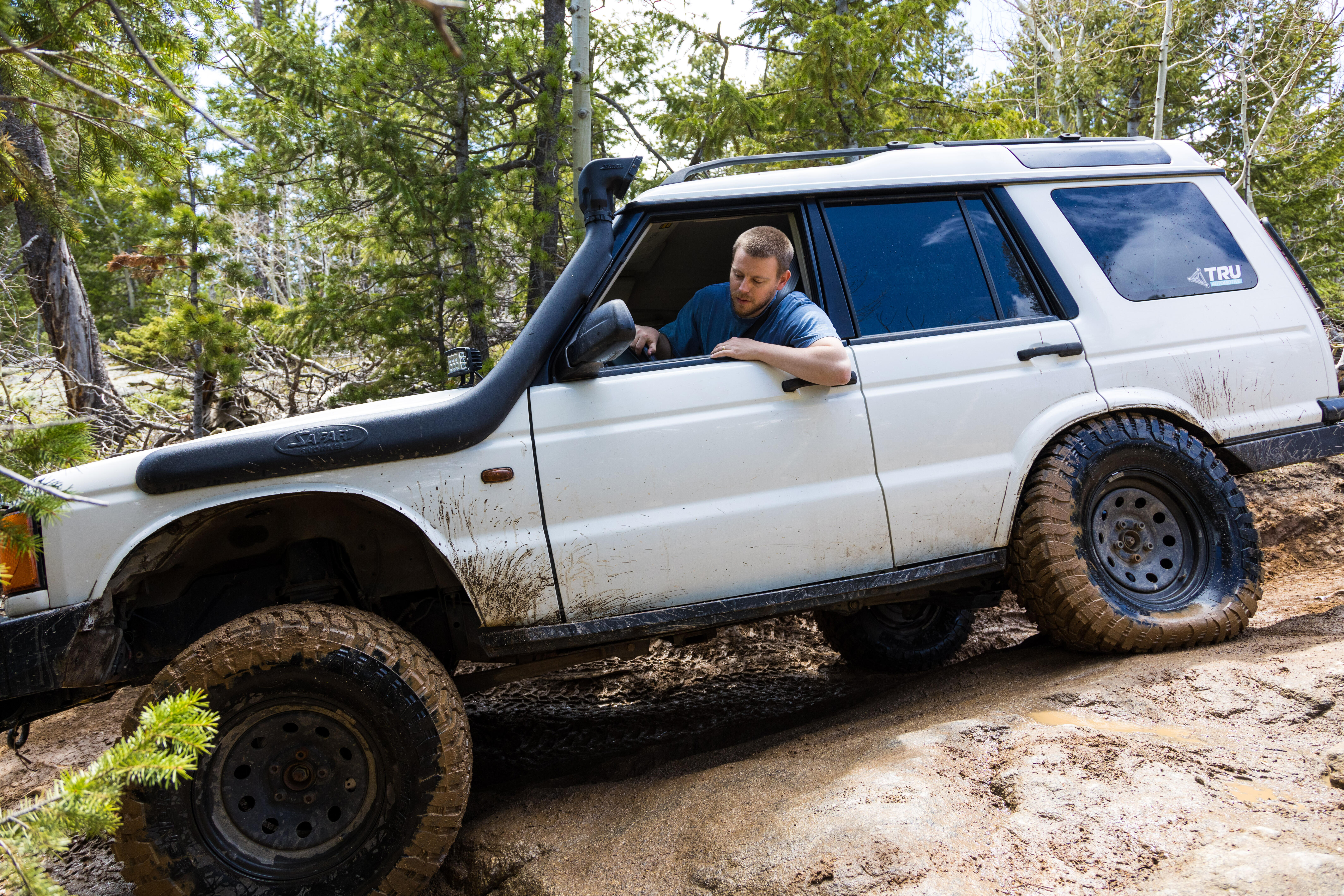

this was on an old tired 3" OME lift running 285/75/16s so was probably about a 2" lift if not less at this point. With the sway bars disconnected/removed these become a totally different monster.
edit: side profile shot is with the +3" TF adjustable shocks and 1" spring spacers on all 4 corners.
