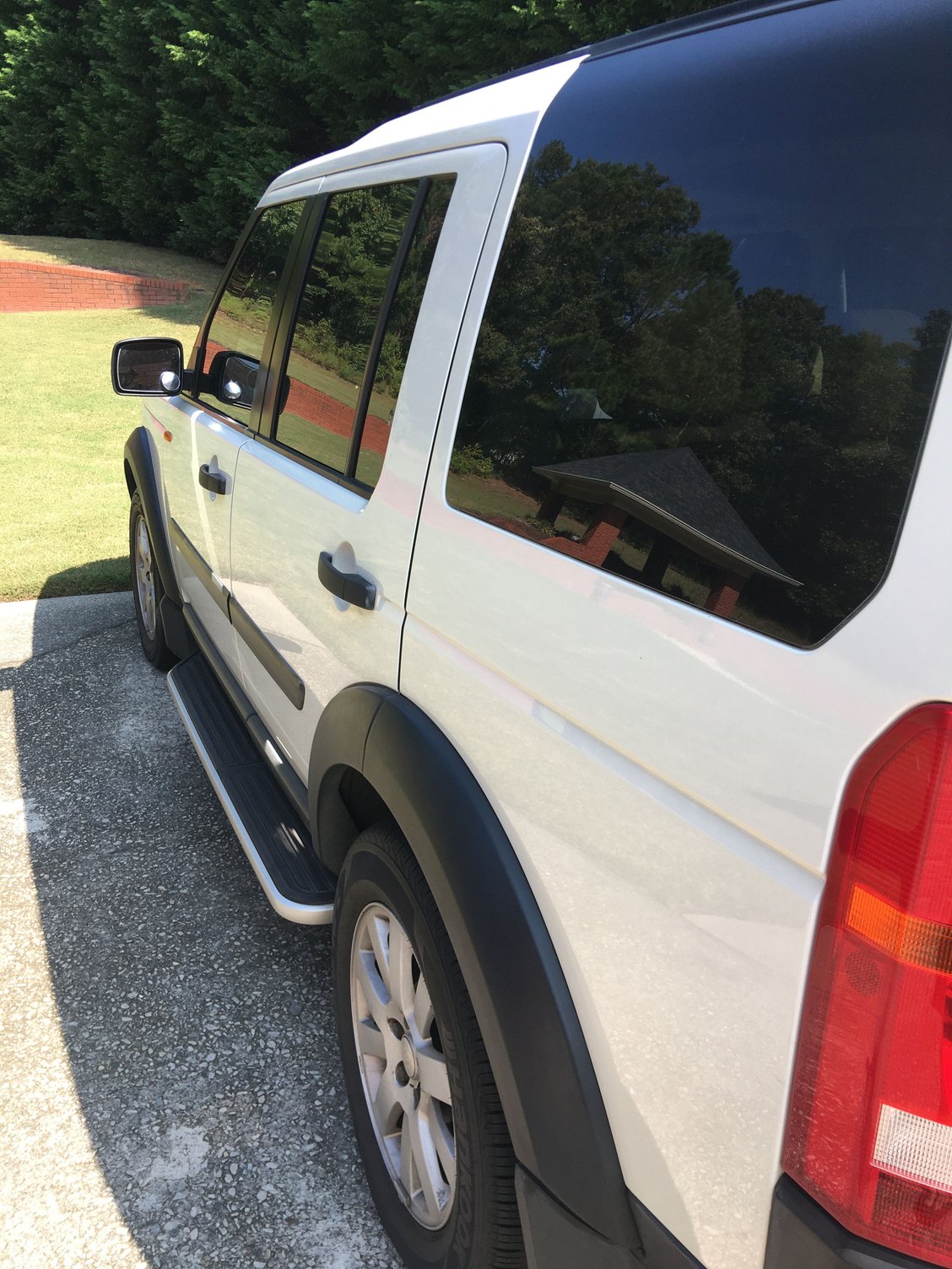

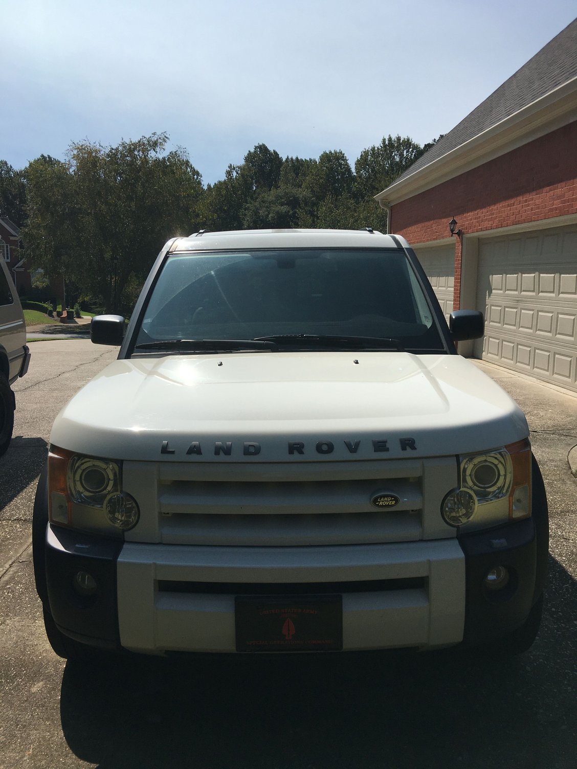

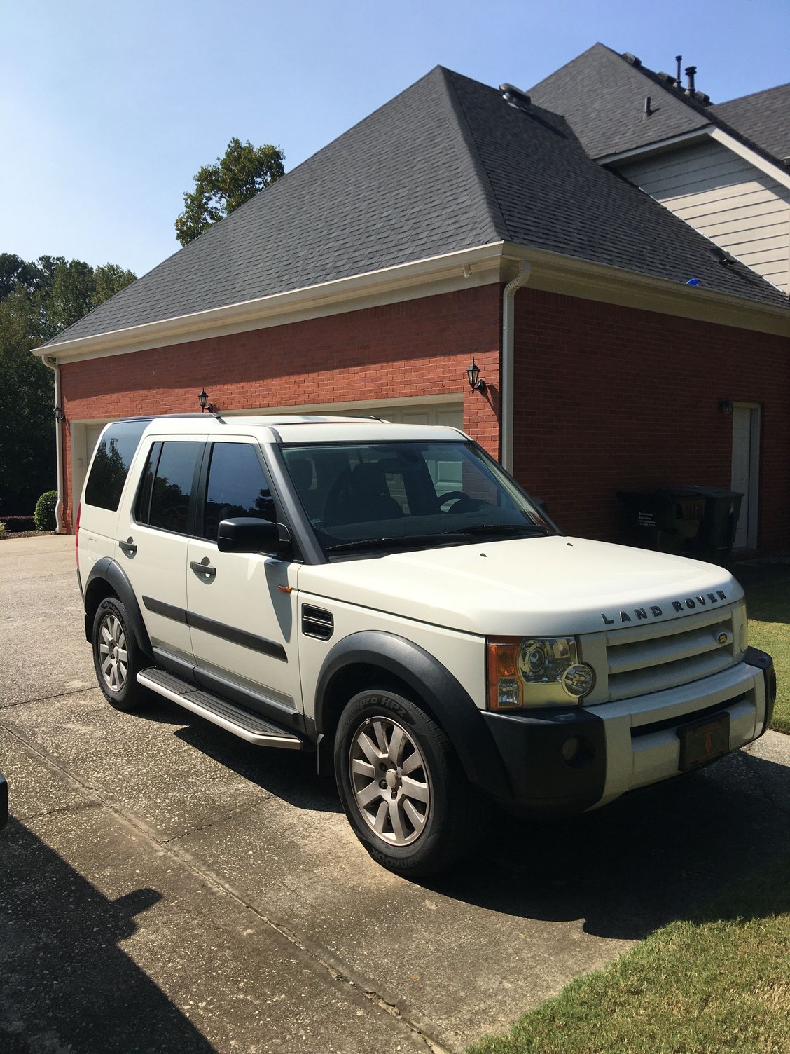

Finally went out and took a few pictures. Little dirty I have a little baseball player to takes over the back. Replaced the A-pillar trim piece and passenger front door trim, cleaned up the headlights. Changed all fluids, Royal purple in transfer case and diffs and Valvoline Maxlife in transmission, also did the transmission filter conversion kit. Fixed the hard shifting between 1st and 2nd and a bunch of messaged by replacing the TCCM ecu. Shifts nice and smooth and feels like new. I used to have an 06' Range Rover sport back in 07' and it feels just as nice if not better shifting. Dash has the normal cracking, so I put a Dashmat in which looks pretty nice. The steering wheel leather is pretty beat up almost looks melted, so I put a steering wheel wrap on it. How hard is it to replace the steering wheel?

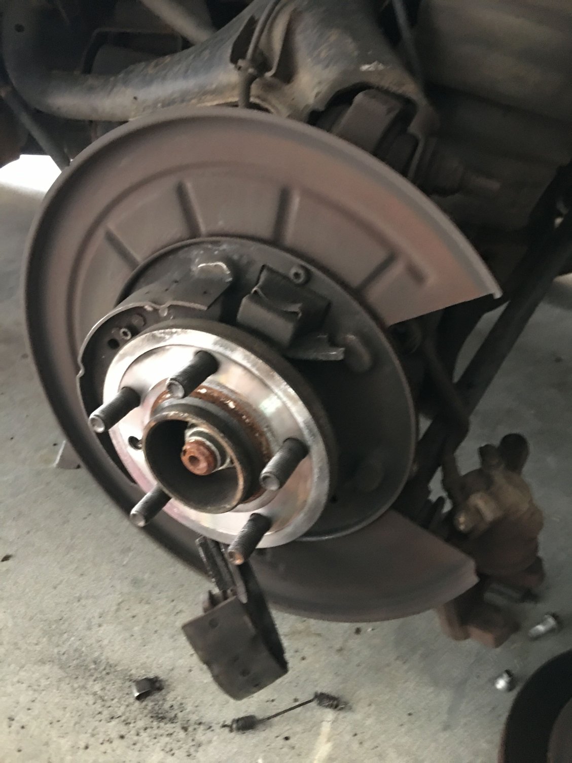

When i picked it up it had a dragging noise in the rear as well as when I set the parking break it started squealing. Figured I'd try to adjust the parking brake. Adjusted it and went to baseball practice. On the way there going about 65 the LR started shuddering. I was like WTH is that! My wife was like "you bought a lemon!" Slowed down and it stopped. We made it to practice and back home without incident. I was like, well the only thing I did was adjust the parking brake. I went ahead and ordered new rotors, pads and shoes for the rear that night knowing in the back of my mind something was up with the rear.
Parts arrived and I tore into the rear. Started with the driver's rear (where the dragging was coming from). Right when I pulled the rotor off this is what I found.
No pins holding the shoes on.
No liner left on any of the shoes and was digging into the rotor.
Got it all replaced, adjusted the parking brake, did a functions check and all is good. Glad the parking brake actuator wasn't dorked up. I don't know that I'd want to replace that thing.

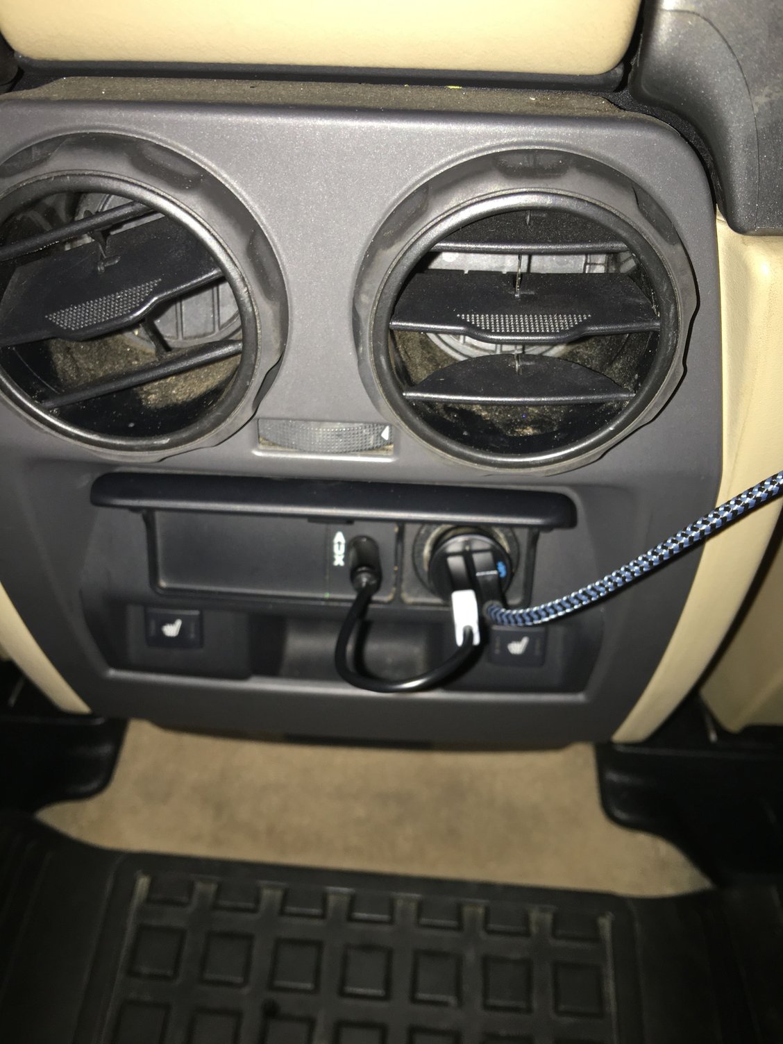

One thing that bugs me about Land Rover is no BlueTooth and the aux port in the rear of the center console. I gotta have my Spotify. Aux adapter with Bluetooth which is powered by the cigarette lighter. Works great, if you're looking for Bluetooth without tearing into the dash and adding an android unit, this is probably the best option out there. The other usb cable is for my son, he tucks it into the seat back pocket.

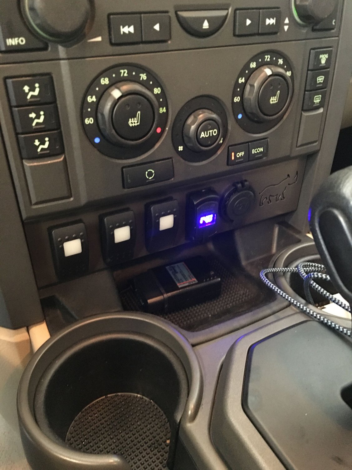

Got a small shipment from Lucky8 yesterday, so today I went ahead and installed the Proud Rhino Power panel in the lower center dash. Pretty straight forward. Had to do a little trimming on the dash to get the thing to fit flush. The connectors were pressing up against the dash frame. Works great and looks good.

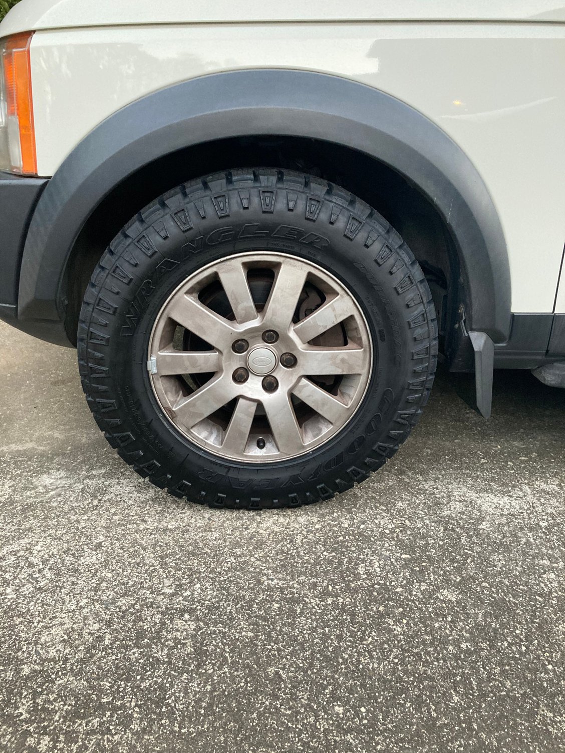

UPS man came by the house this morning to drop off my new tires
Goodyear Wrangler Duratracs 265/65R-18

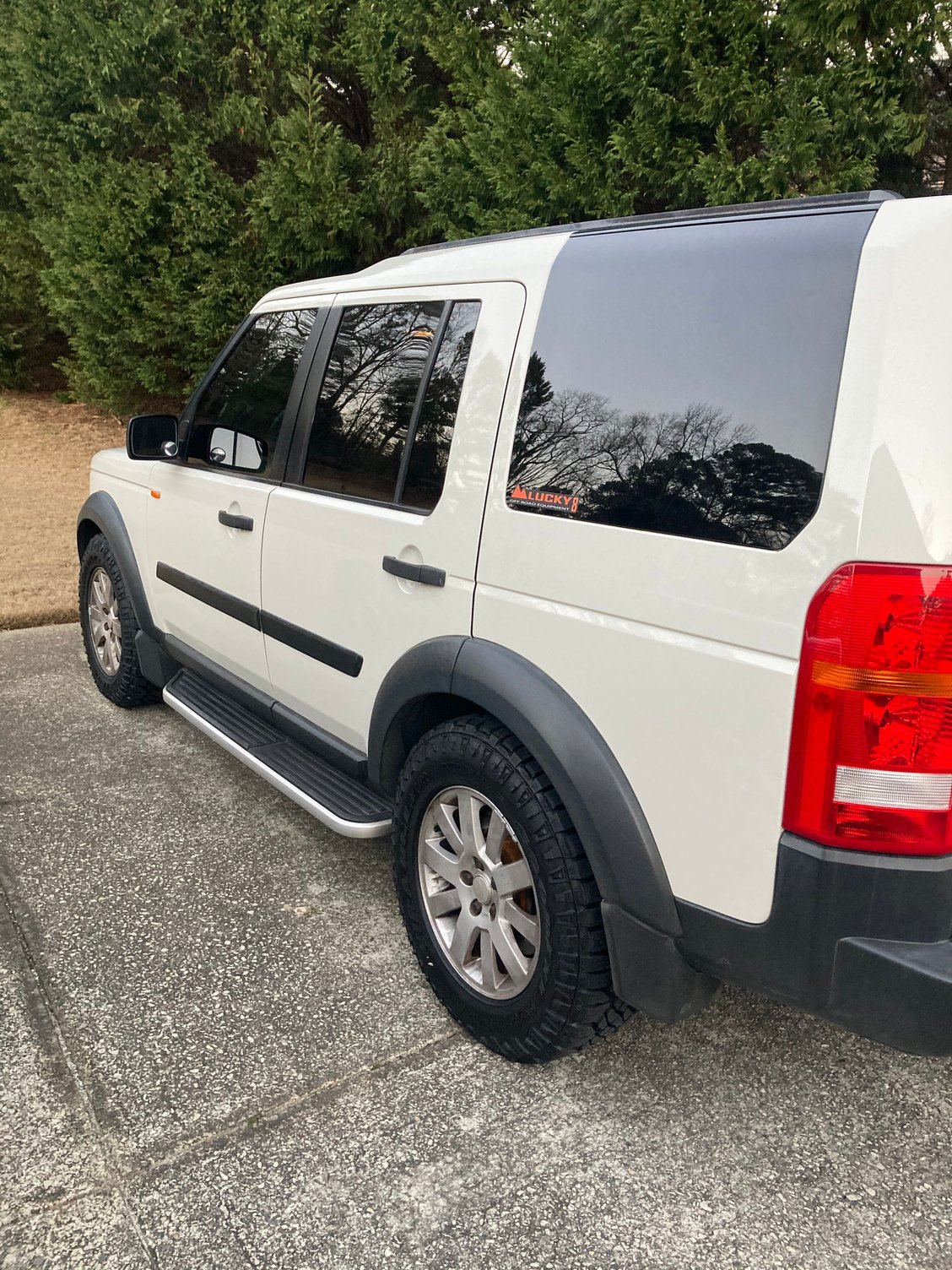

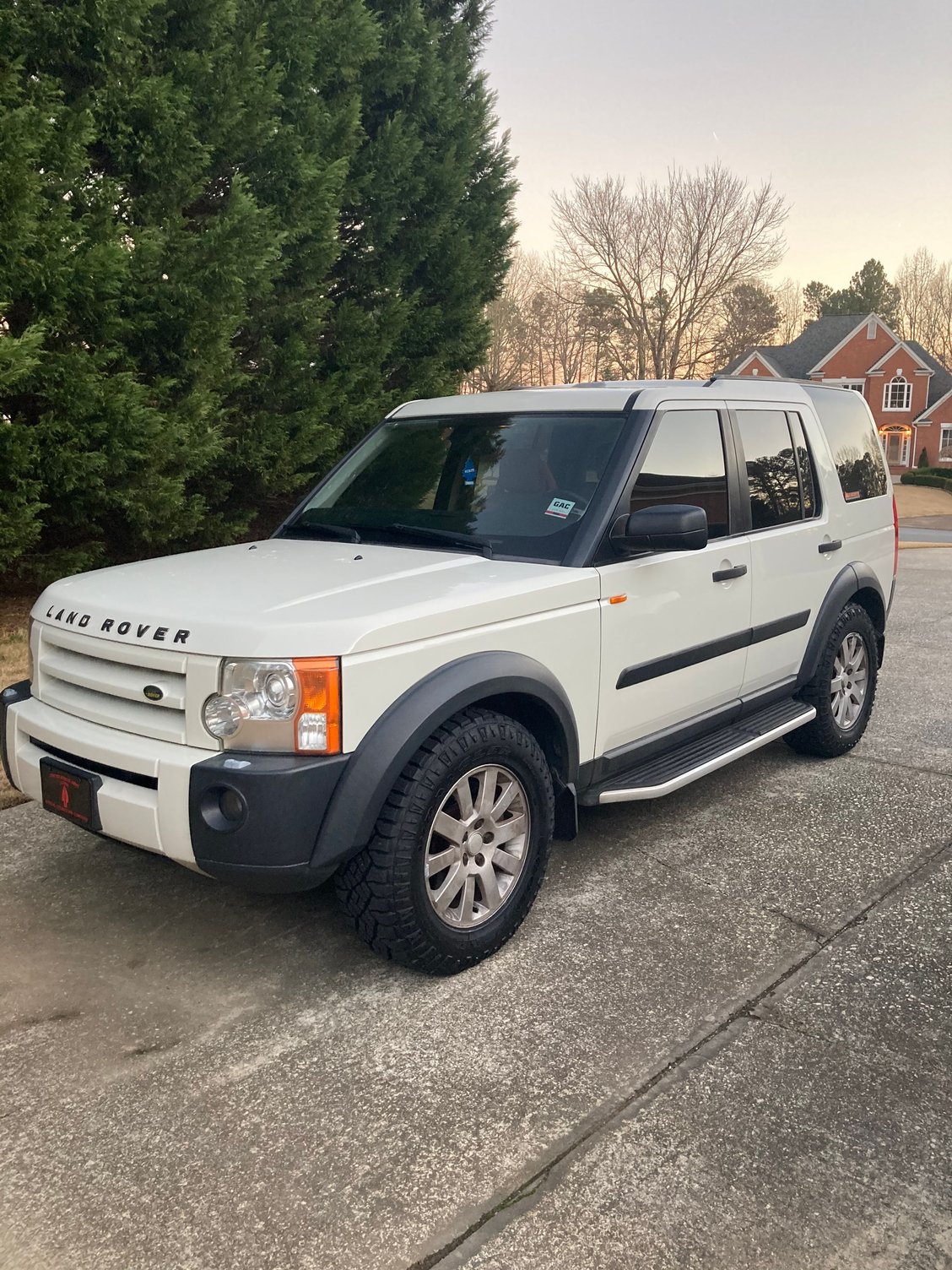

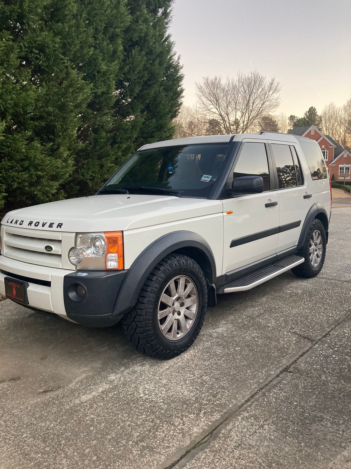

Finally got around to putting the new shoes on. Stock height. I think it came out super nice. I may play with the suspension settings in the GAP tool, raise it up just a tad.
