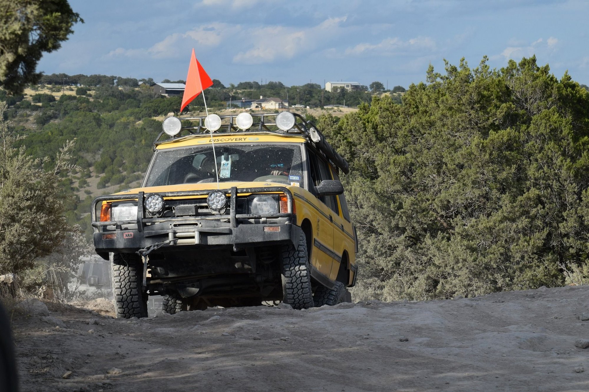

The XD is doing well. In October of 2022 I attended the Hill Country Rover Rally at Hidden Falls Off Road Park near Marble Falls, TX. The XD performed flawless on the way to the event, and during the event off road. Nothing stopped it, and I had a great drive home as well. She's got a rusty body, but mechanically minus the cheaply made Chinese hose, and the ball bearing that lived a very long life she's doing great. Before the event I did swap out the bumpers. I had the 98 LSE chrome bumpers on it, and I actually liked it because it was different that 99.9% of all other XD's. I eventually slapped on a D1 ARB, 12K Winch, and a black rear bumper. The extra weight up front only made the suspension sag may 1/4 of an inch, but it made it handle much better on the road with the extra weight and those D2 SE7 Progressive springs I'm running on the front of the XD.
I haven't honestly wrenched on it since the Big Bend Trip and the repairs afterwards once I was home or at my friends. The XD has been one of those LR's you can just hop into, and enjoy. It handles the trails at the HCRR Event & SCARR like a champ while still being fun to drive on the road.
That darn wire hanging from the RF bumper amber light kept falling down, but I eventually just cut it off! Those lens are all jacked up from someone using larger bulbs in them so I need new assemblies anyways, but I like that pic a good friend of mine took of the XD.
