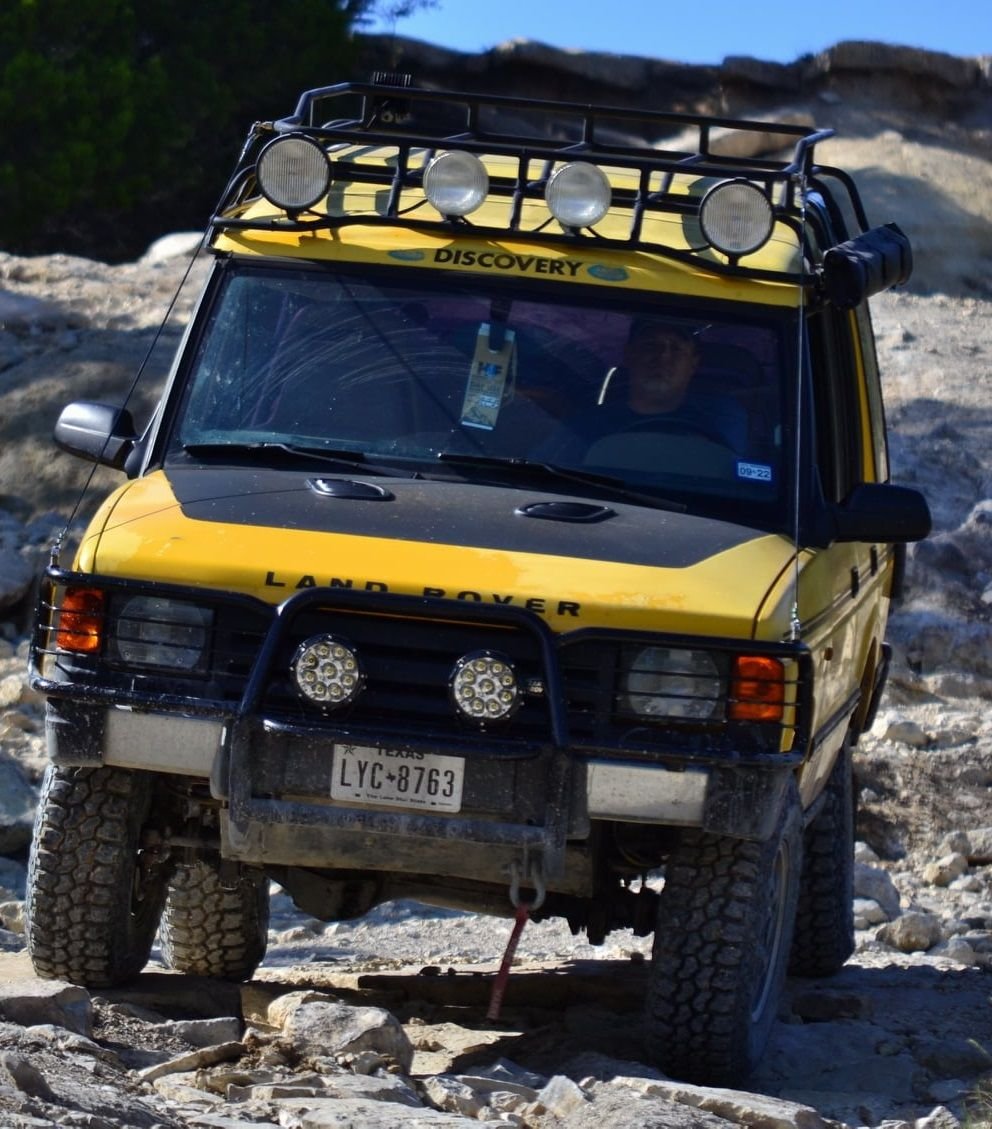

Looks like a good time. Yep, three inch lift just looks right on a Dl/Dll...and still offers pretty good road manners...granted...you always want to be aware of ever-changing road conditions.
l'm terrible at taking pictures, too. Usually by myself...so action shots are out...then by the time l think about getting the tablet out at camp...it's dark.
Yep that's me, get to the off road park (also usually by myself), and hit the trail, do all kinds of technical stuff, then only get to take a pic when you stop for a restroom break or to grab a water out of the cooler. The XD has no sway bars front or rear (original mounts on the frame F/R are beat all to hell from a previous hard life and when connected the truck sat all kinds of funky lol) so yes I have to be aware of my surroundings at all times on the highway, but it handles better than either of my 05 Wranglers with sway bars on em. I went down this one trail where the axles were constantly going in/out of deep trenches made by those crazy 4ft lifted side by sides, and I never lost traction. Springs were dropping in/out of the rear perches but the spring retainers kept em in place. Darn XD just acts like a mountain goat. I also didn't air down the 235/85R16's and everyone else in our group had big old fat tires. I was the only tall/skinny tire person there and I was VERY impressed once again with those 500.00 for 4 Thunderer MT's. Tons of traction aired up and I never bottomed out or got close to dragging anything all weekend. I am very happy with the XD's setup now and I don't have any plans to tweak it anymore.

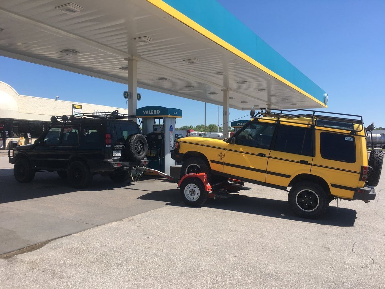

I don't think you're suppose to tow a 4wd vehicle like that...
Old Jun 21, 2021 | 10:31 PM
  #116
Best4x4's Avatar
Posts: 8,010
Likes: 2,512
From: Beaumont, TX
Are you talking about this picture of my XD? You can tow em on car dolly if you remove the rear drive shaft. Towed it home 3.5hr with no issues.
