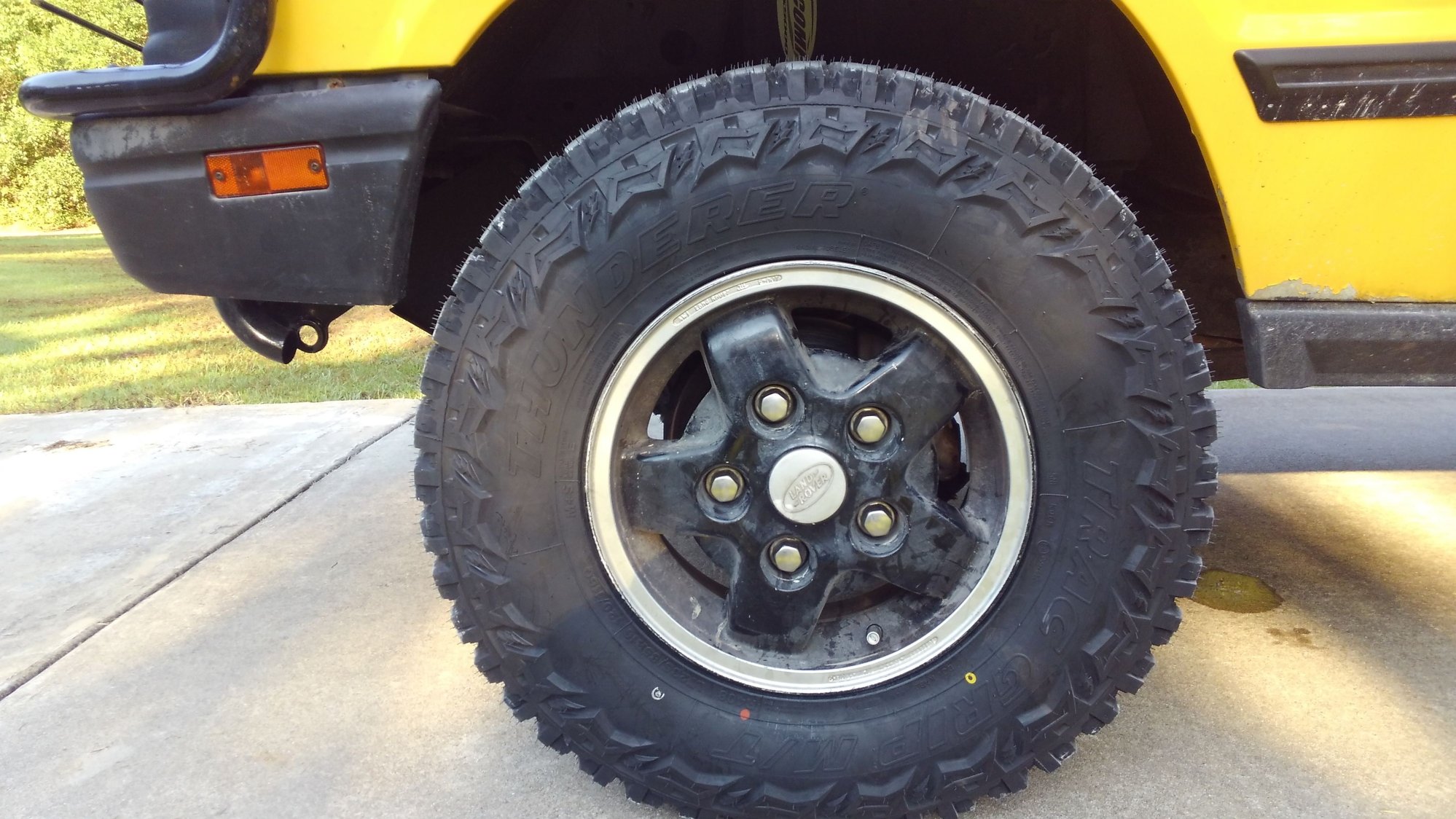

Besides the silly name I am impressed with these cheap $475.00 M/T tires from Thailand. They took very little weights to balance, and the sidewall and rim protector are nicely done. When I took the pic's I laughed when I saw the LF headlight metal piece floating around inside the light assembly. When I took it to Houston last weekend there was a lovely massive hole on I-10 near 610 and it was pretty violent. If that's all that fell off with old yellers rusty body I'm impressed lol.
Also good news so far on the oil light flickering BS when coming to a stop. Since switching to the OEM oil pressure switch that came on my 10.00 front timing cover the light has not come back on. Note to self DO NOT trust a URO oil pressure switch. If it does come on again I have all the gaskets to slap my spare front timing cover on. SS Brake lines should either be here today or early next week.

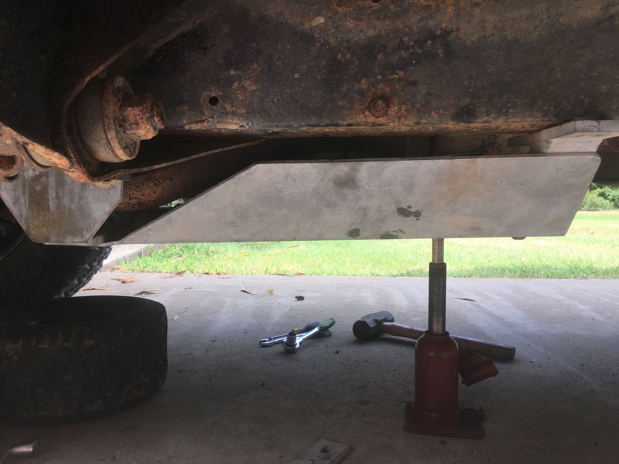

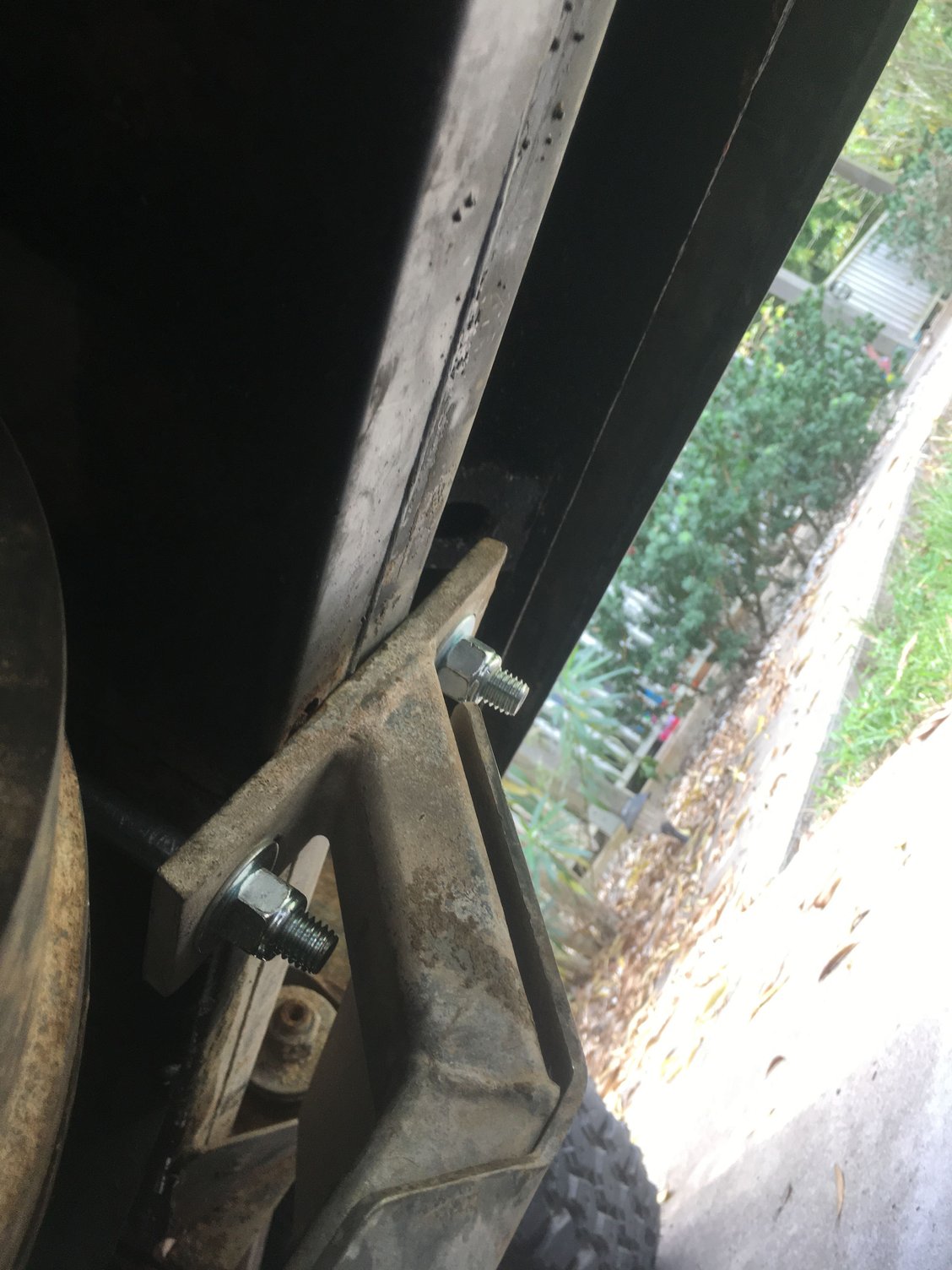

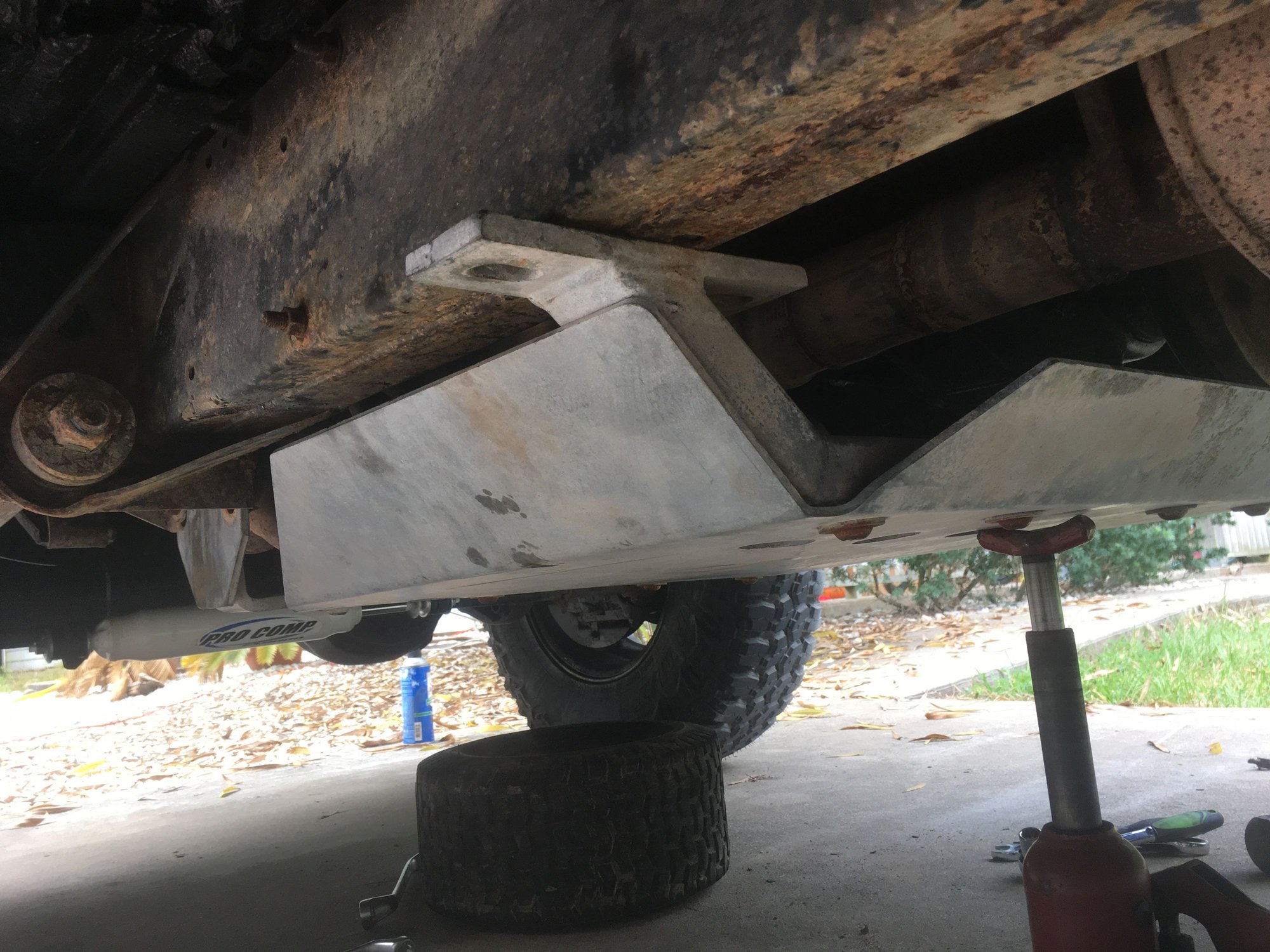

Free skid plate! Thing is galvanized & extremely stout! Just had to buy new bolts for the rear mounts vs the crappy all thread it had on it previously.

URO is garbage
Nice score on the gas tank skid
