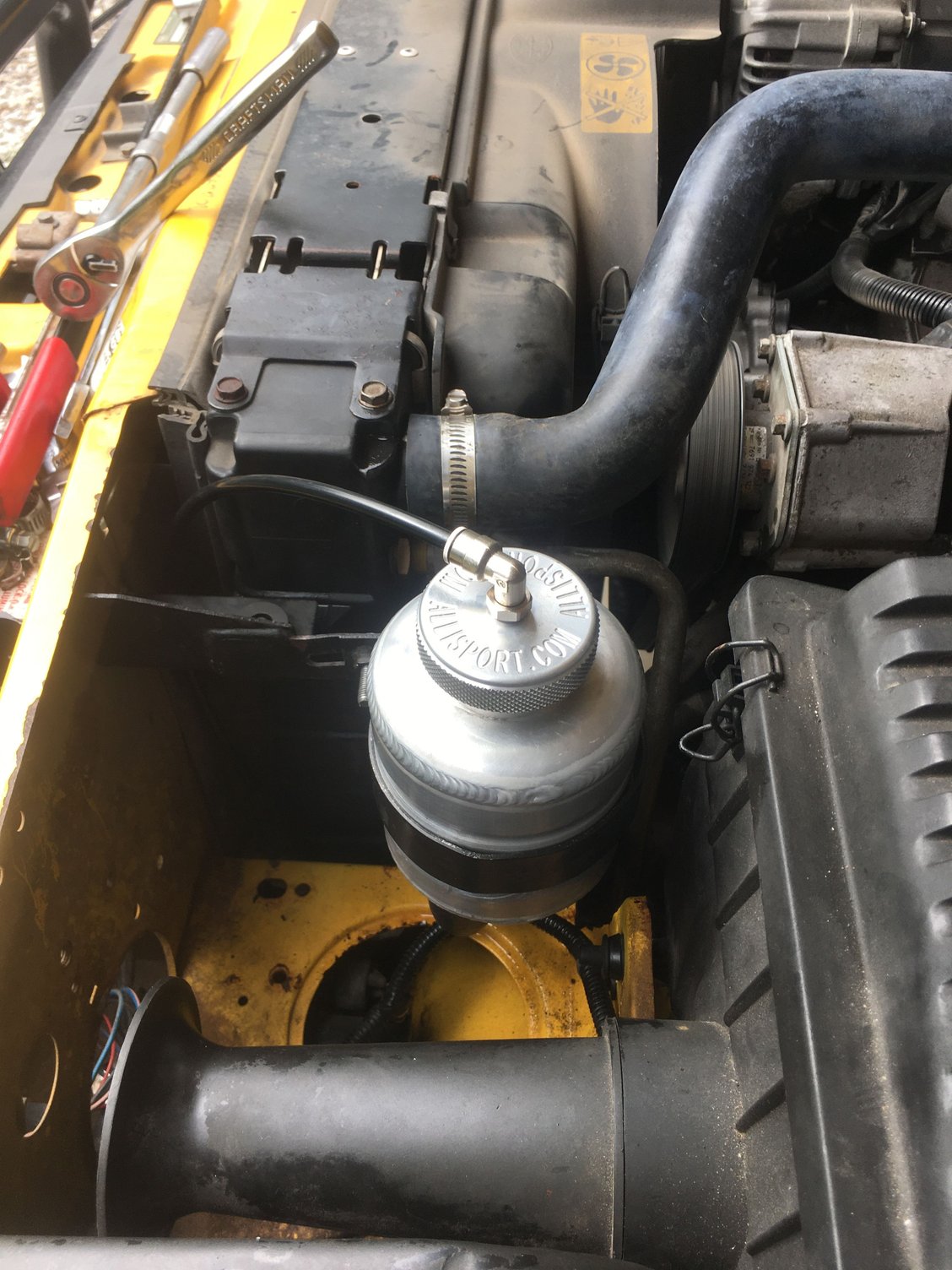

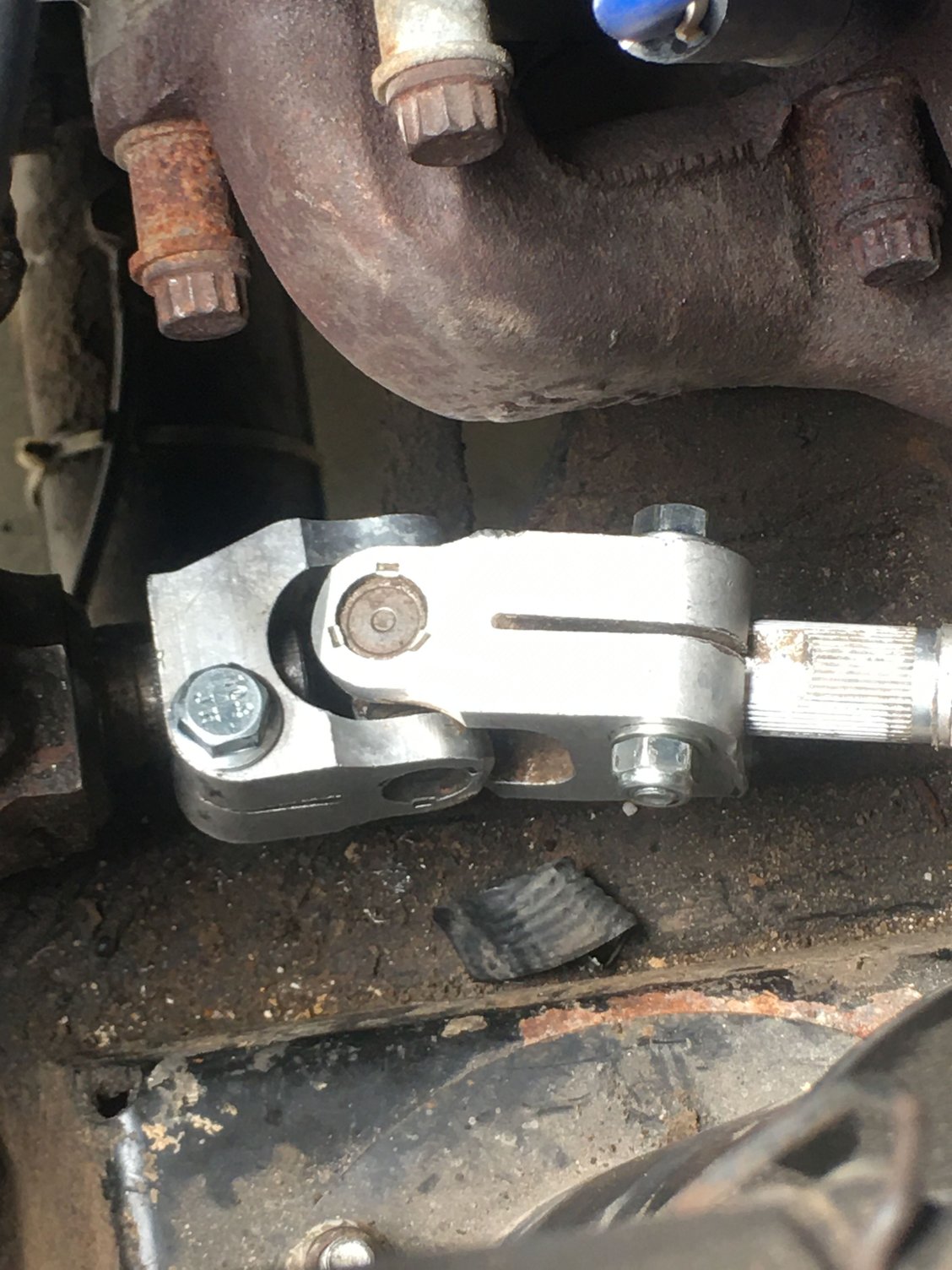

I also won an AlliSport Aluminum P/S reservoir for a RRC/D1/D90/D110. I got it installed today and I also found the cause for all the slop in the steering. OEM steering shaft bolt was loose & stripped. I simply drilled it out on both ends and installed a longer bolt and installed a washer & locknut. Tightened it up and no more slop!
