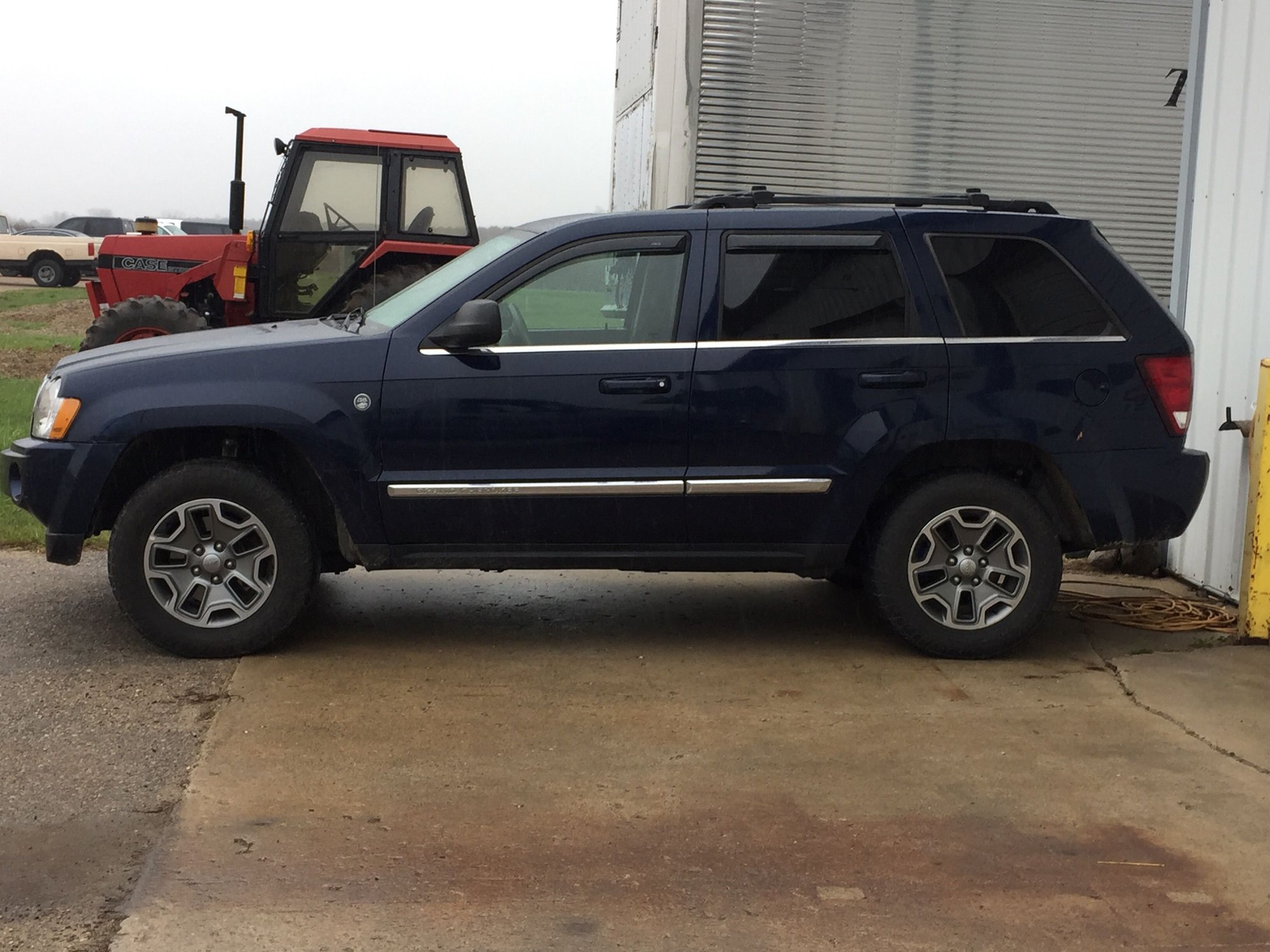

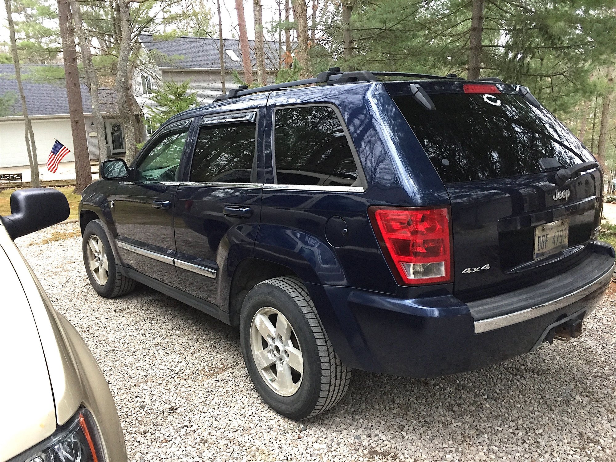

Hey folks, just a small update with a former Landy owner. I've been looking for a LR3/LR4/RR Sport for some time, something that was a project because I need distractions. They didn't materialize so at the end of March I saw a 05 Jeep Grand Cherokee Limited with the 5.7 Hemi on CL for $2k, it had a transmission issue where it wouldn't go past third gear and the owner was selling it thinking it had a bad transmission. I know from my sons Dodges that the newer transmissions are solenoid shifted, basically all the same transmission throughout the line. Finally talked to the owner of the Heep and he had bought a solenoid pac for the transmission from Mopar. 155k miles it's about that time for a new one. Ended up buying the Heep and the solenoid pac off him for his asking price because it's a 5.7 Hemi, pretty rare they come up for sale. Had to remove the valve body on the 545RFE trans, remove the old solenoid block and install the new one, fill and test. All five gears and this thing is a cream puff. I'm the fourth owner, originally owned by an older couple in Tampa Florida for 14 years. Second owner neglected it somewhat but it was still serviced at a Chrysler Dealer. So far it's had it's struts/springs/shocks replaced, fluids replaced and will get a new CV for the front drive shaft next weekend to remove a small vibration. Everything is original except for the water pump, thermostat and heater core and all parts have been documented on CarFax as being dealer or auto shop replaced. This thing HAULS *** and has so many options like auto wipers and lights, heated leather gazillion position seats, pedal location, sunroof and navigation. It's 16 years old so it's basically just a small parts as needed rehab/refresh. It's one of the best projects I've owned concerning initial price and overall condition. Wheels have been replaced with the Rubicons I had on the other Heep since these pics, this is when I first brought it home. It's something I can drive to work and back and not worry about and the parts availability is outstanding. Would've been crazy not to jump on this.

Yes, Heep II was a good deal and the midnight blue pearl at the time of that pic hadn’t been polished or waxed in a long time. Now it’s been polished and the sun sets it ablaze.

First thing I did before buying was get under it looking for rust, almost none. It came up here from Florida and it shows. It will drop cylinders, read about the issues and solenoids is one. Going through fluid changes soon to inspect. It’s had mucho dealer care throughout its lifetime and fluid changes are mentioned in the CarFax report. The only thing left is to fix a driveline hum, have the front shaft CV kit, see if that does it. If not I’ll check hubs, u-joints and bushings while under it this weekend doing the the CV replacement. I don’t mind putting time and cash into this, it’s worth it at the buy-in cost.
