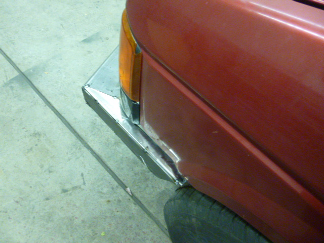

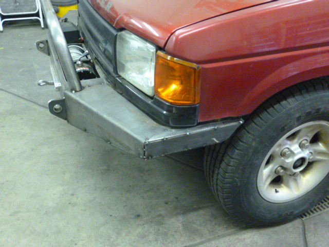

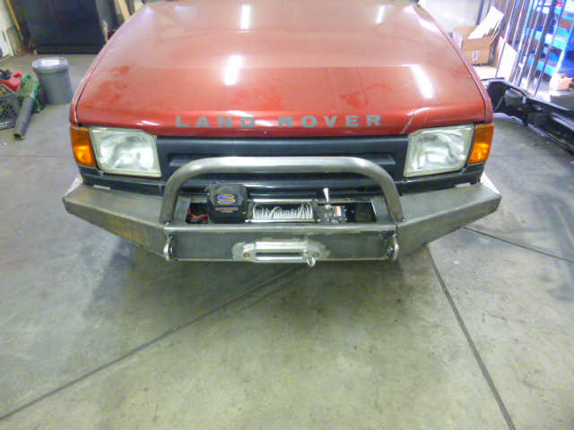

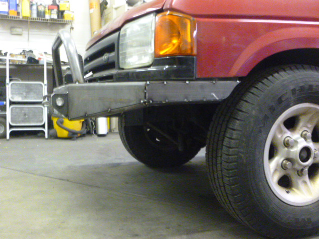

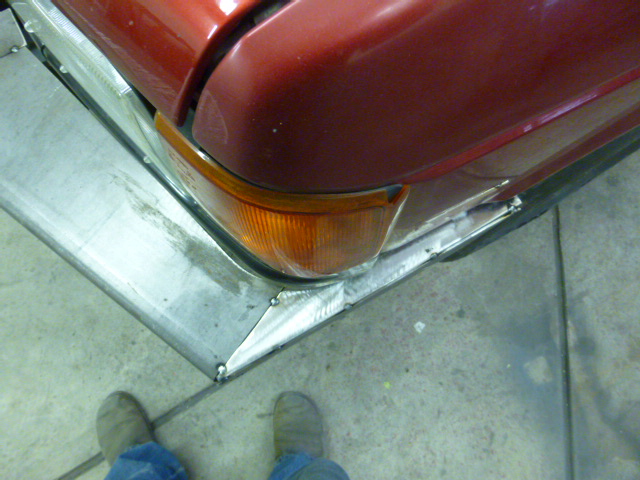

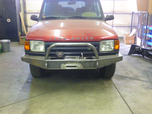

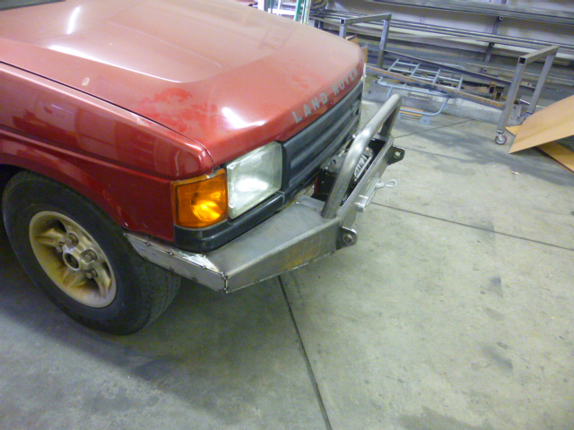

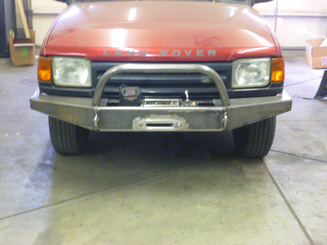

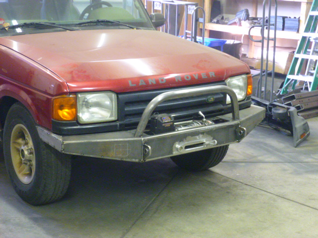

Front is all tacked out. I'll get the lights cut in later.
Jason

That is looking really good Jason. I like the a bar set up on it. Will there be light tabs on the A-bar?

Thanks Bill!!
I can put them in any configuration for a customer. I will put two holes on the bumper shell winch lip between the A bar legs for lights as well.

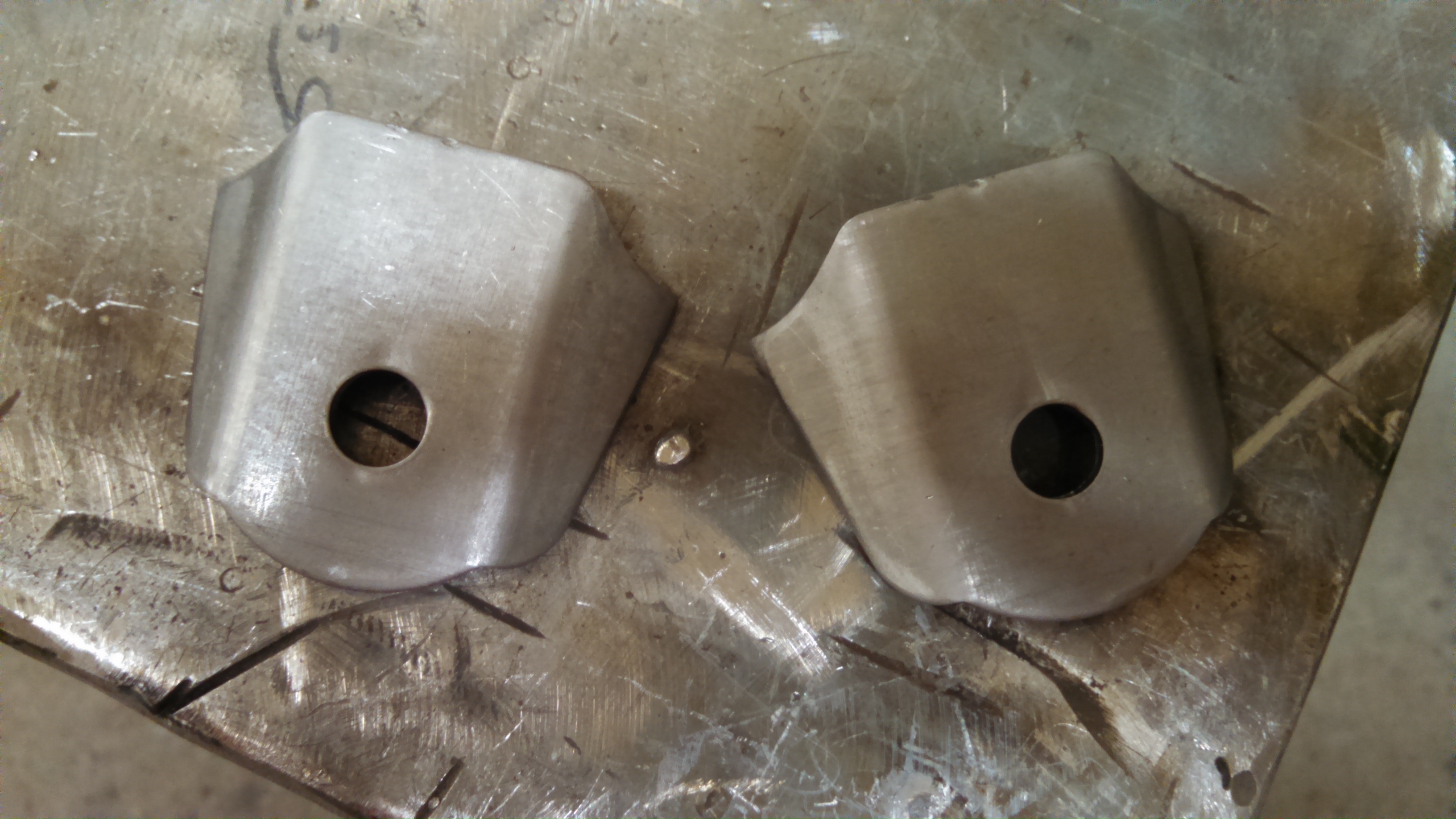

These are the tabs I use for tube.
Jason

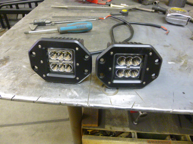

Not sure if I will run a combo LED bar (spot/flood) or a pair of round lights.

TerraFirma Heavy lift kit from Justin @ Lucky8 en route as well.

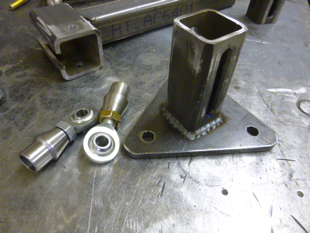

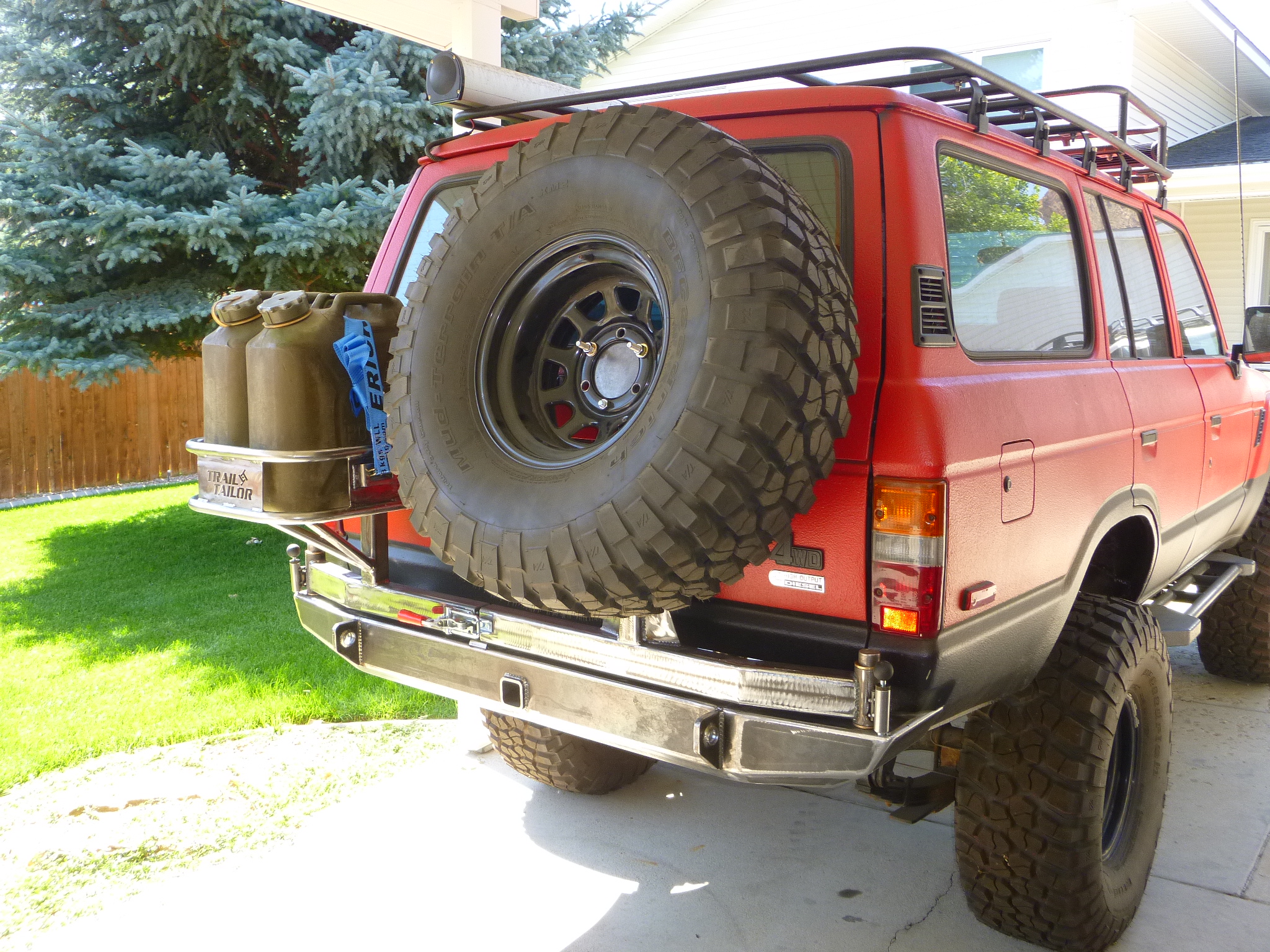

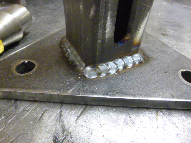

Trying to decide if I want to build a standard tire carrier mount for my exact setup or an adjustable...
Here is the start of the adjustable. I use this same style for my LandCruiser carriers. Will be building an offset plate with the pictured CrMo 5/8" heim joints to incorporate the swing arm to the D1 swing gate.
Ordered the RotoPax cans and locking mounts. I will cut a slot into the arm for my Hi-Lift jack lip to cradle into and then add a positive stud for the leg.
Should have all the components for the telescoping LED work light.
Jason

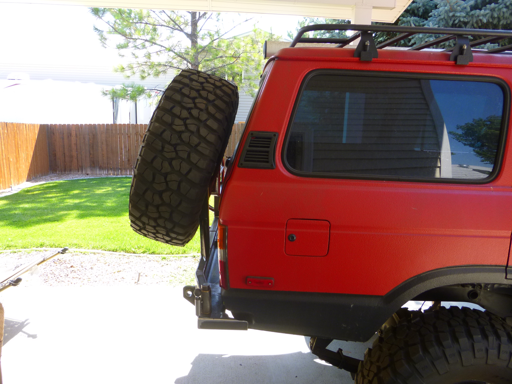

Originally Posted by Detoured Discovey
Adjustable is always more attractive.

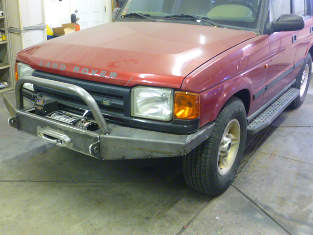

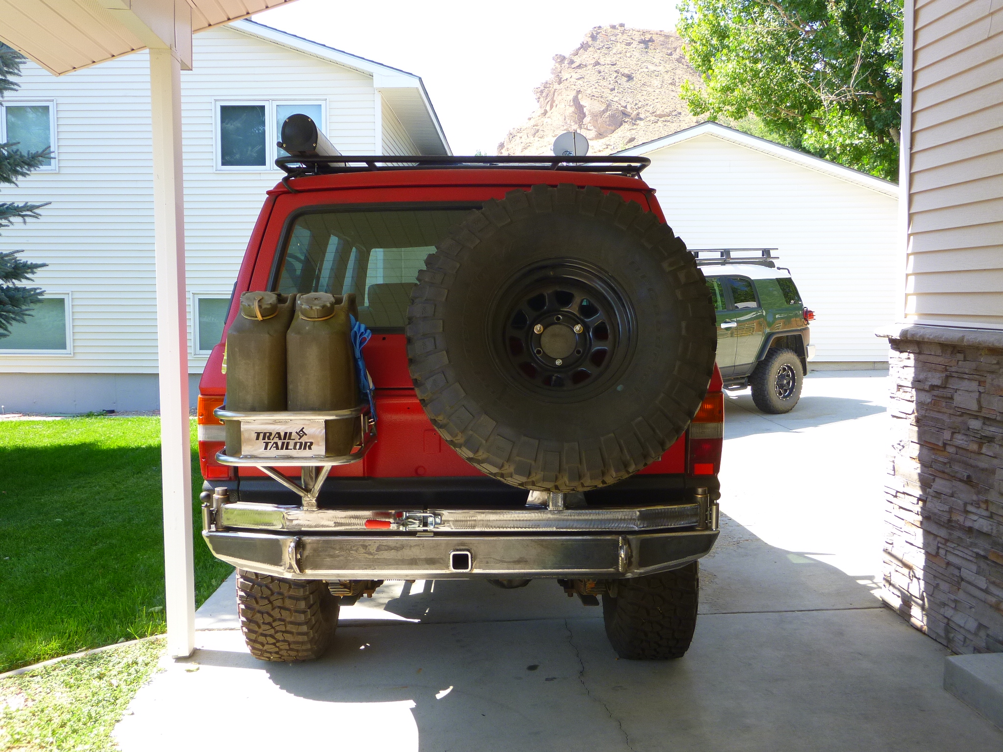

I change my mind too often. Here is the same adjuster on my old Yota rig. It would allow for a stock set-up 30" x 9.5" to my big meats 37" x 14"...
J
