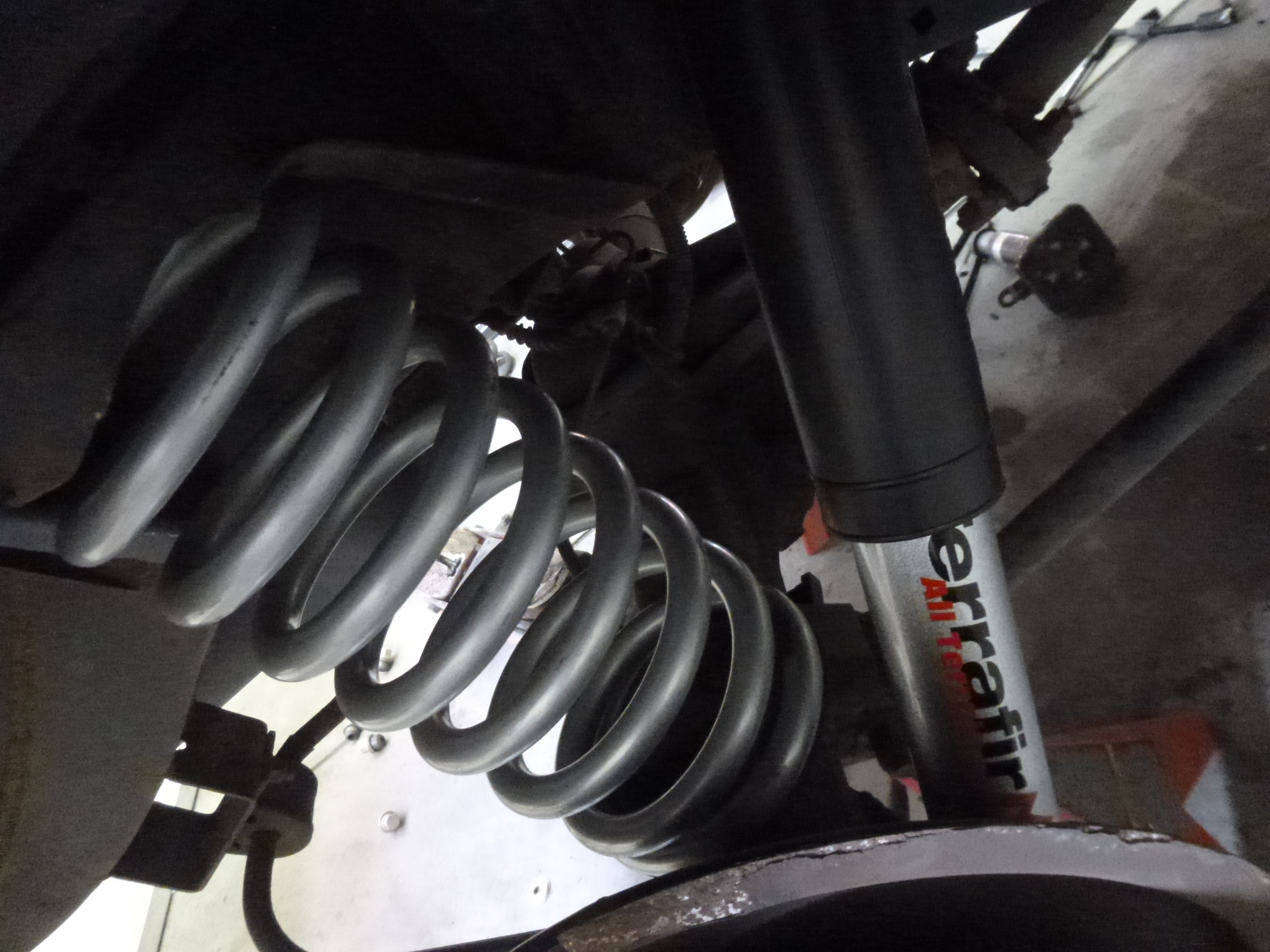

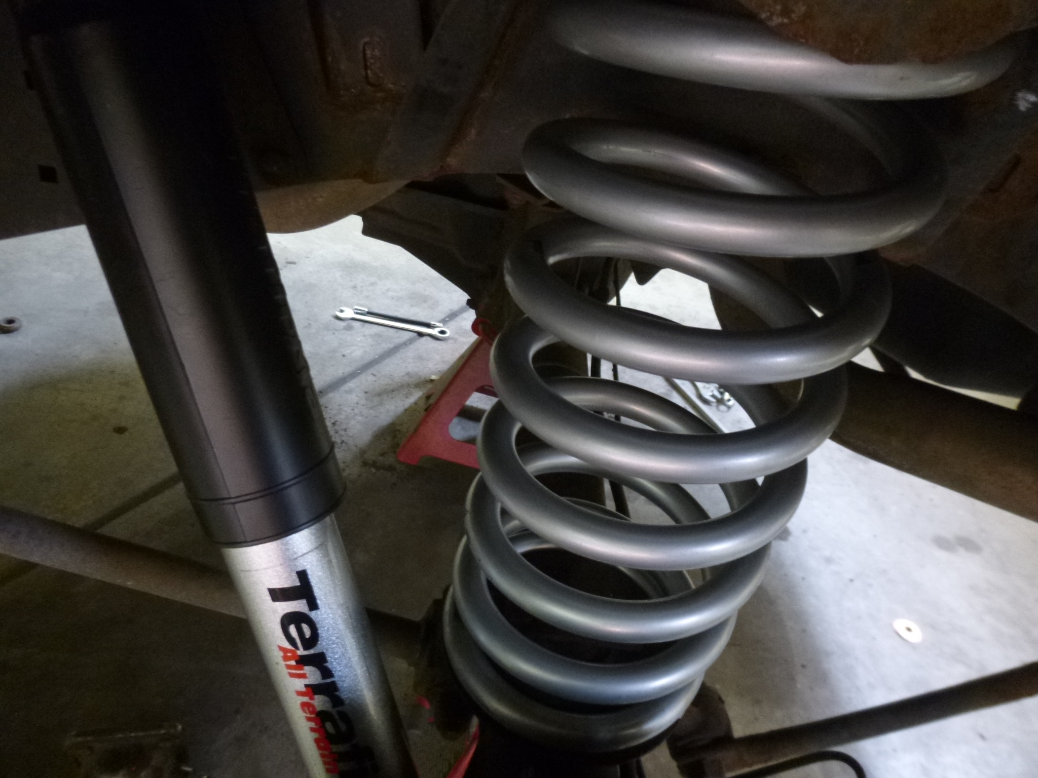

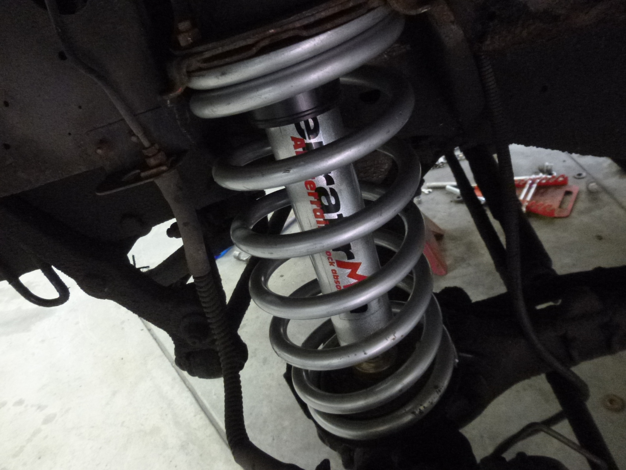

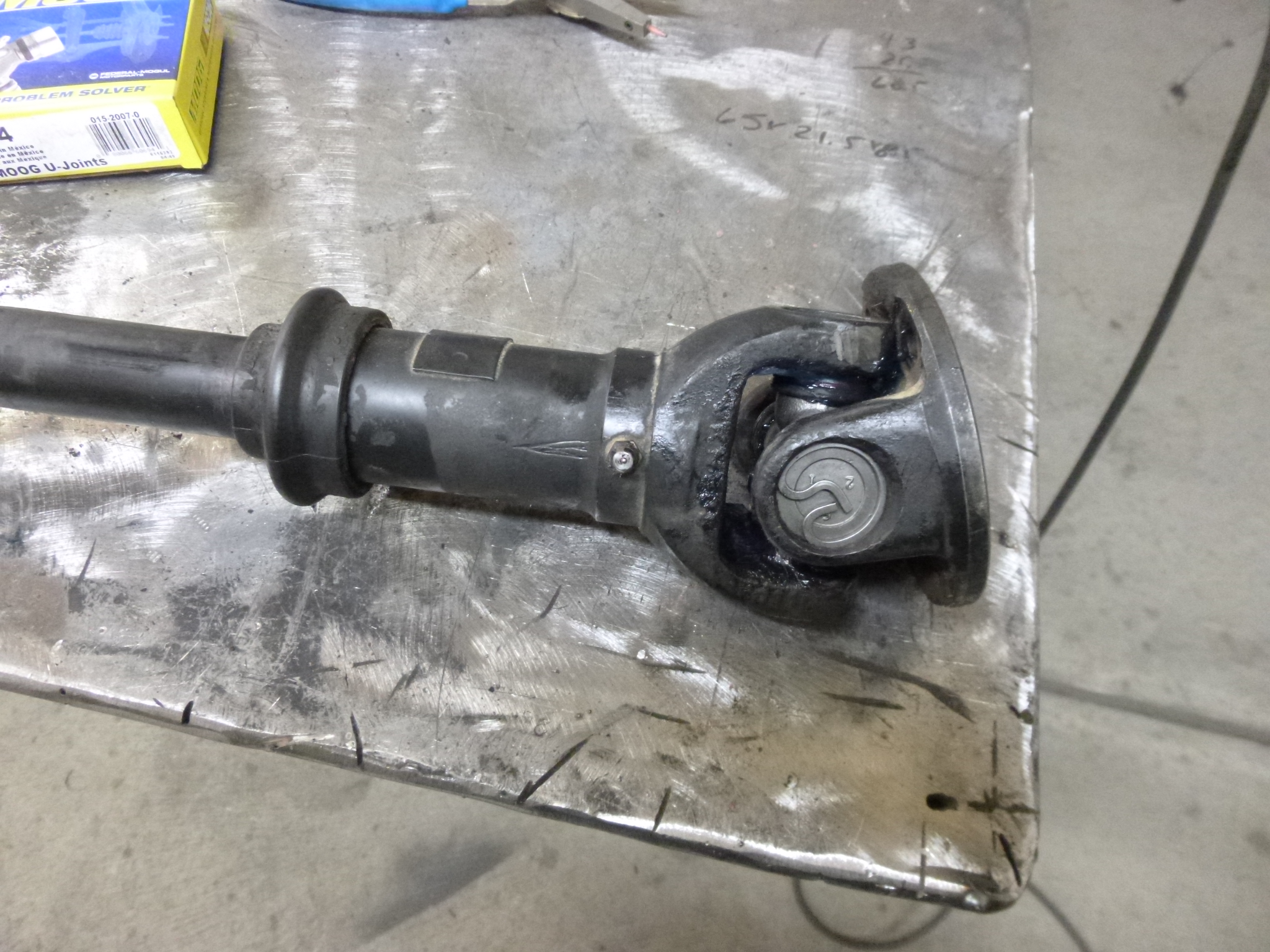

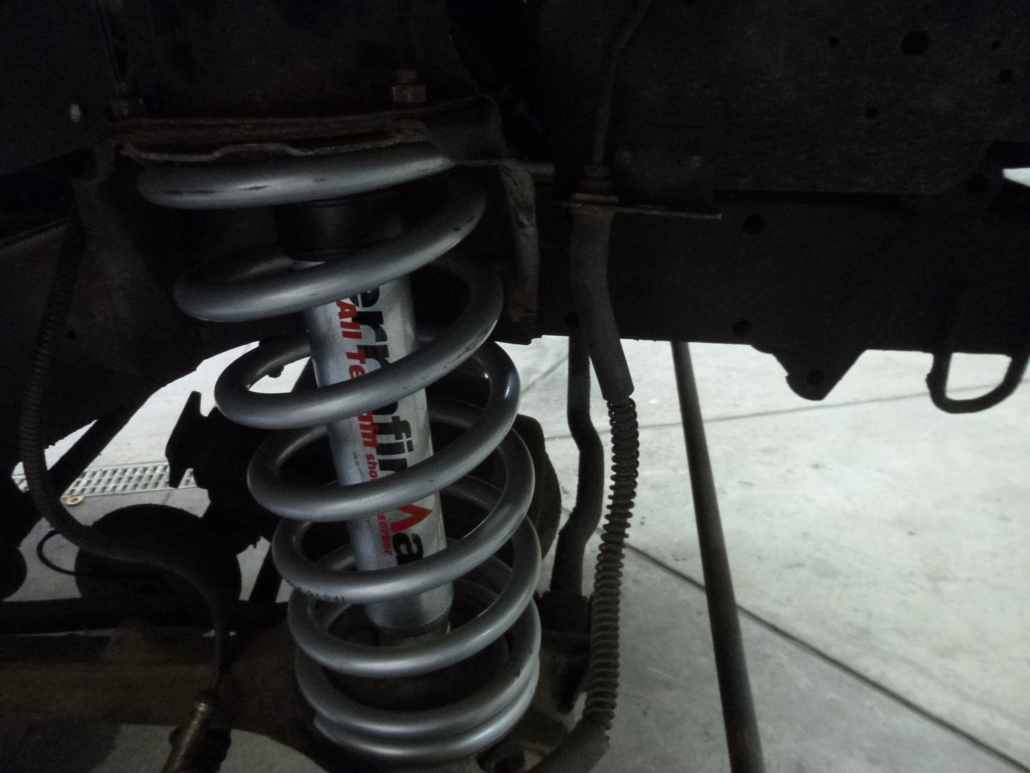

Had a couple hours this morning(3 to be exact). TerraFirma lift is on all corners now and new MOOG 344 U-joints on front prop shaft. I still need to fully bleed the brakes and swap U-joints and flex coupler on rear shaft.
I got about 3.5" of lift (from the worn out state my rear springs were at) on the rear and about 2.75" on the front.
Now to decide on what tires and GET MY A$$ in gear on ARMOR...
Jason

J you did replace the centering ball on the front shaft to correct? If not be sure to do that as well.
Old Dec 13, 2015 | 09:16 AM
  #87
Trail-Tailor's Avatar
Former Sponsor
Joined: Oct 2015
Posts: 528
Likes: 13
From: Redding, CA
B, I don't have a DC/Hookes joint.
J
