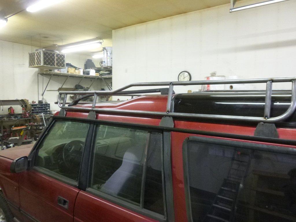

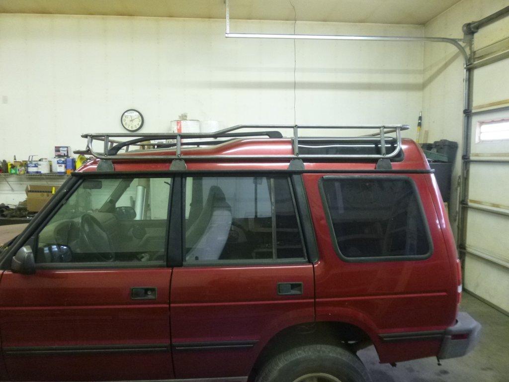

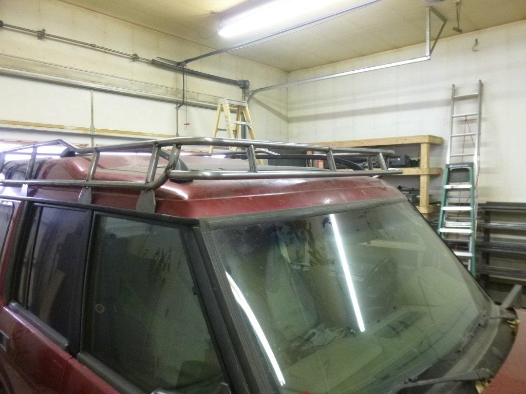

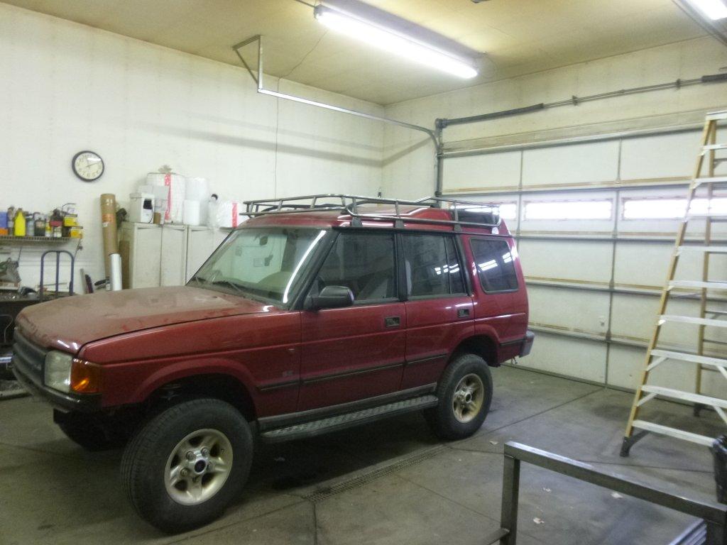

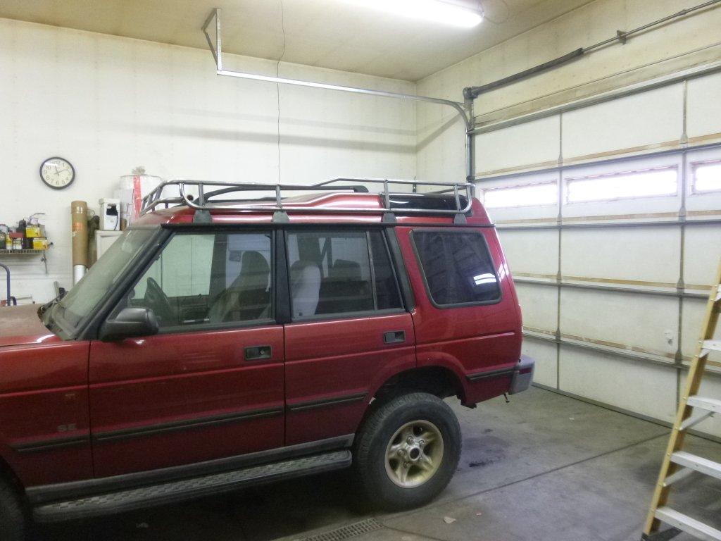

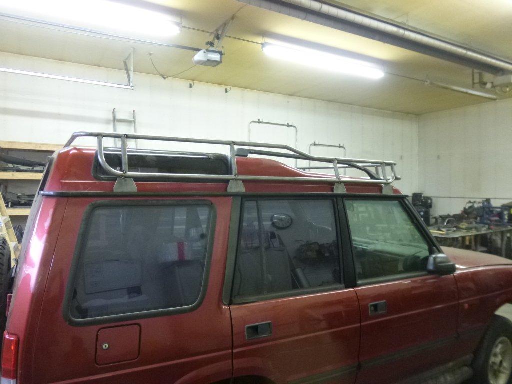

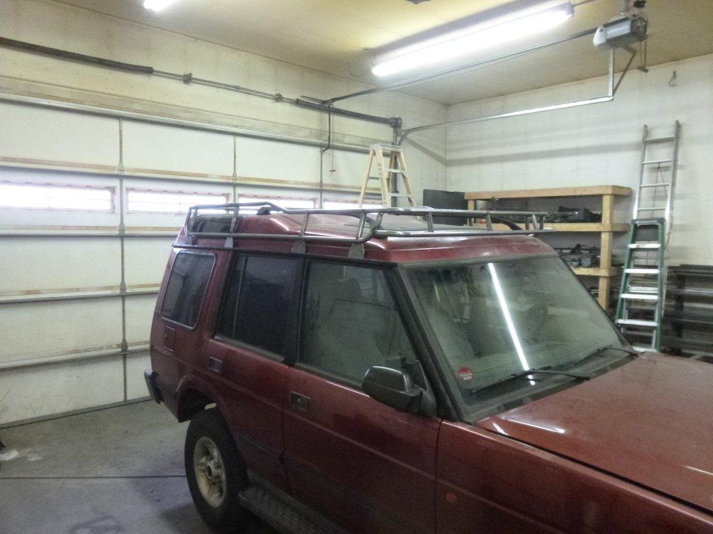

LO-PRO rack is mostly complete and tacked out. Still need to get the crossbars, tie downs and light tabs on.
Tomorrow I will start the EXPO/ RTT rack
Jason

Old Dec 22, 2015 | 05:54 AM
  #109
drowssap's Avatar
Posts: 9,298
Likes: 318
From: Boston Strong
that looks great, it really does.
I have question though shouldn't the weight be carried by the A B C D pillars?
in other words should the front and rear brackets be pushed out to the ends of the rack, rather than setting the weight over window openings? the weight would be transferred to the A & D pillars. just an idea
great work
Old Dec 22, 2015 | 09:04 AM
  #110
Trail-Tailor's Avatar
Former Sponsor
Joined: Oct 2015
Posts: 528
Likes: 13
From: Redding, CA
great work
Thanks for the kind words Drow. I will be cleaning up the front of the rack today.
In a perfect world the load should be placed as close to, on/over the pillars as we are taught/told.
The A-pillar is the only one that it is really hard to get a mount close to.
Most companies build so the mount feet are equal in distance from one another to be more load bearing and that their deflection calculations are similar across the length of the rack. This also makes them look more proportionate on the rack, but not as functional for a true load bearing design, unless there are several of them.. 8-12 mounts, IMO.
After all the racks I've built over the years and actually field tested.... The gutter rail is what takes the true abuse of the system, not the pillars. The best thing to do is have a mount with a wide foot (3"-6") to even further distribute the load. Less psi per running load width is what we are after.
I'd honestly be comfortable loading this rack up (RTT and 200-300# gear) with 6 mounts and none being placed over any of the pillars and hitting the trails, etc..
Jason
