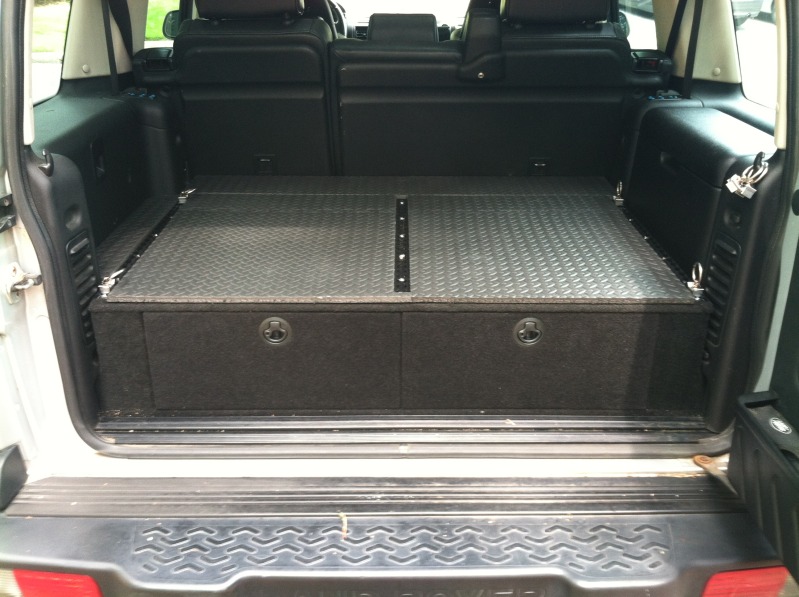

Next I pulled the third row jump seats, added the storage bin to the right side and built a set of drawers for tools and gear.

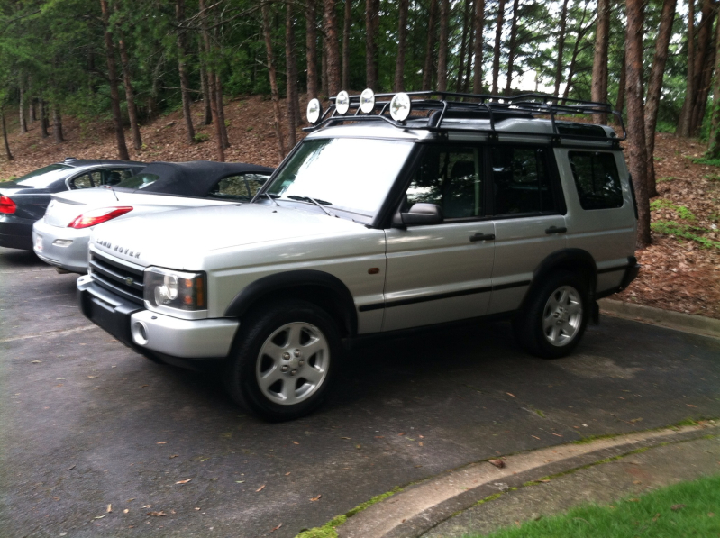

At some point I removed the factory brush guard, sold it and relocated the lights to the roof rack. This picture was in August 2013 just before leaving AL to drive back to CO for the Land Rover National Rally in Ouray.

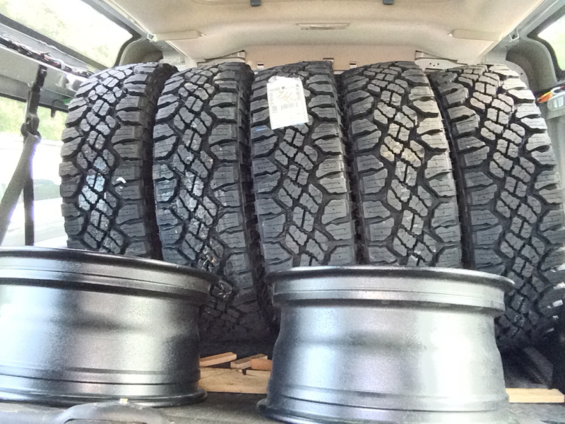

2014 I ditched the 18" wheels for a set of 16" wheels. I had them blasted and powdercoated. Installed 235/85/16 Goodyear Duratracs and a Terrafirma 2" lift.

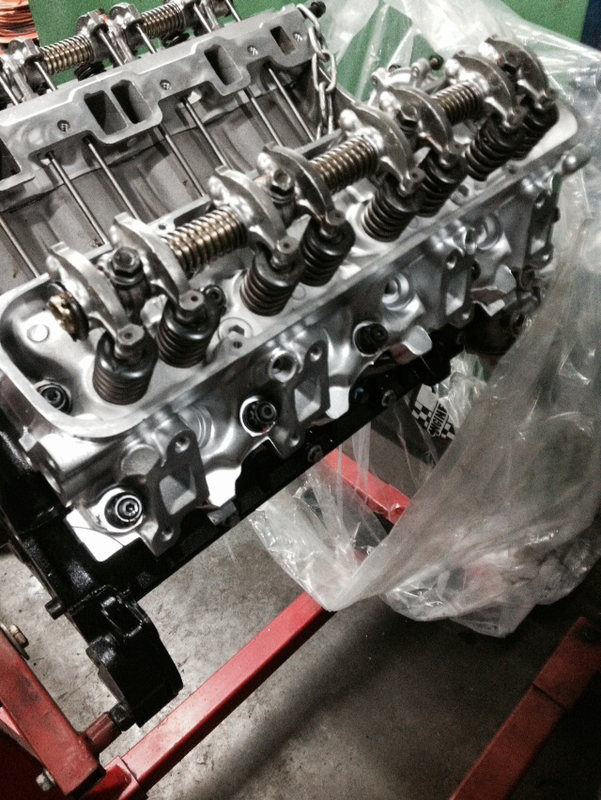

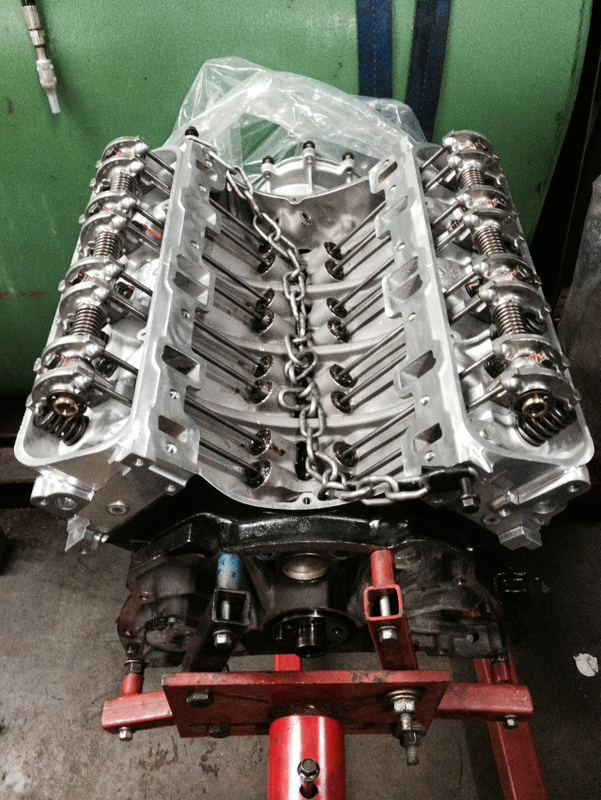

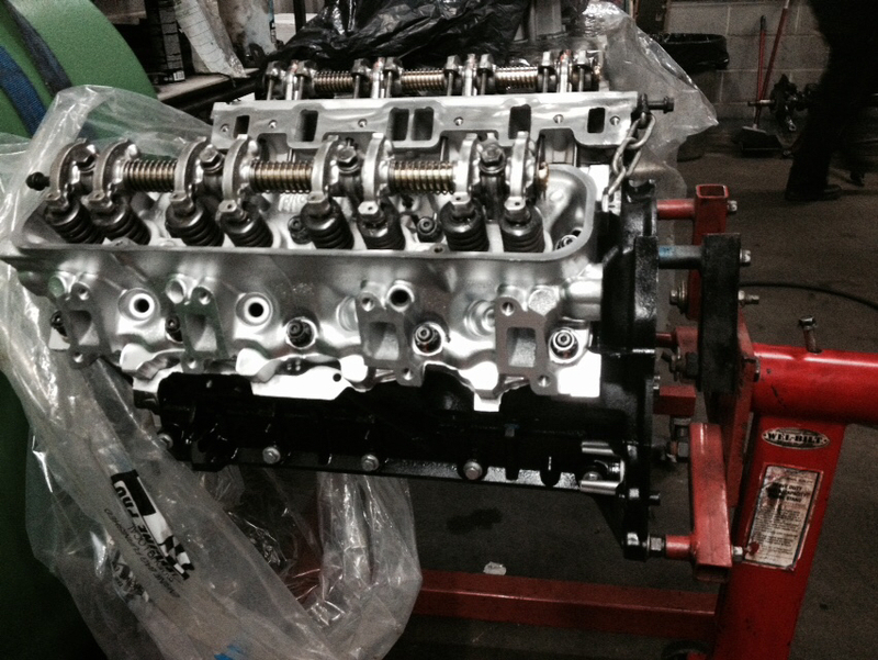

This brings us to late 2014 (November I think). I started chasing some misfires on cylinder 3 and 6. Continued chasing the rabbit by replacing plugs, wires, and O2's. Things were ok for a couple of days when the misfires returned on cylinder 3. Engine overheated quickly on a short drive and coolant found its way into the crankcase and into combustion chamber on cyl #3. After talking with several experts the diagnosis was a crack in the block behind cylinder 3. So I decided the time had come to buy a rebuilt tophat liner longblock from Cannibal V8. The longblock was shipped to The Shop in Norcross, GA. This brings us to present day. The engine is now being installed and should be ready to go in a few days.
New engine on the stand at The Shop.
