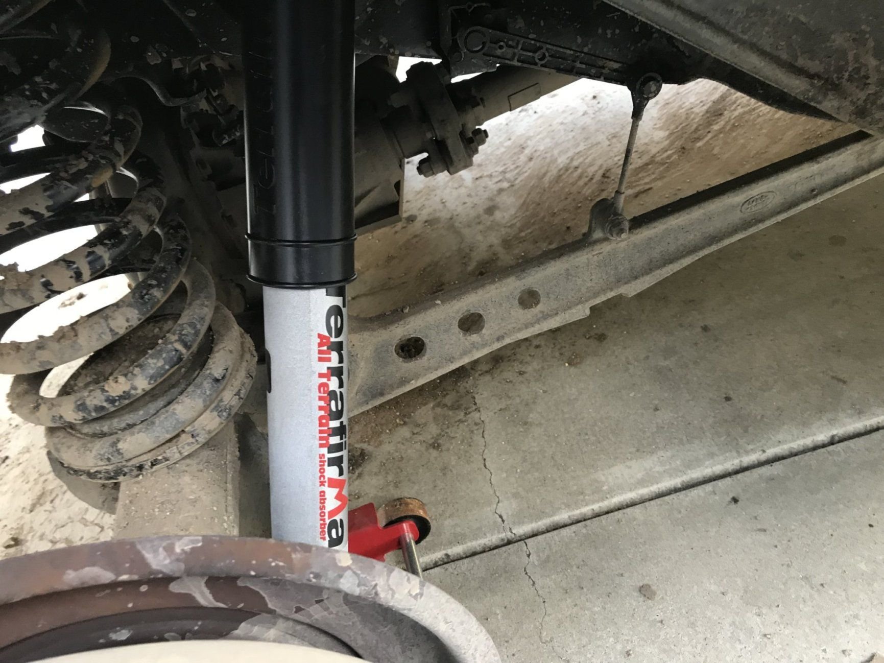

-I have had terrafirma HD shocks on since about a month after I purchased the truck. Overall, they are doing great except that all the paint has come off of the rear shocks, and they have rusted.
The rust actually looks pretty bad, like near perforation so that's pretty disappointing. The front ones are fine though. Such a shame because these shocks perform pretty good. I'll probably swap out the rear shocks soon (either OME or Bilstein).

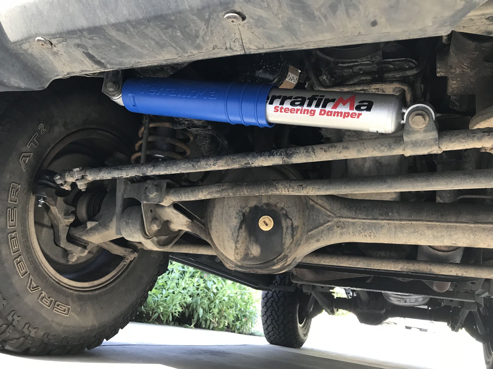

-Also changed out a drag link end. Probably will upgrade the tie rod and drag link to the terrafirma ones.

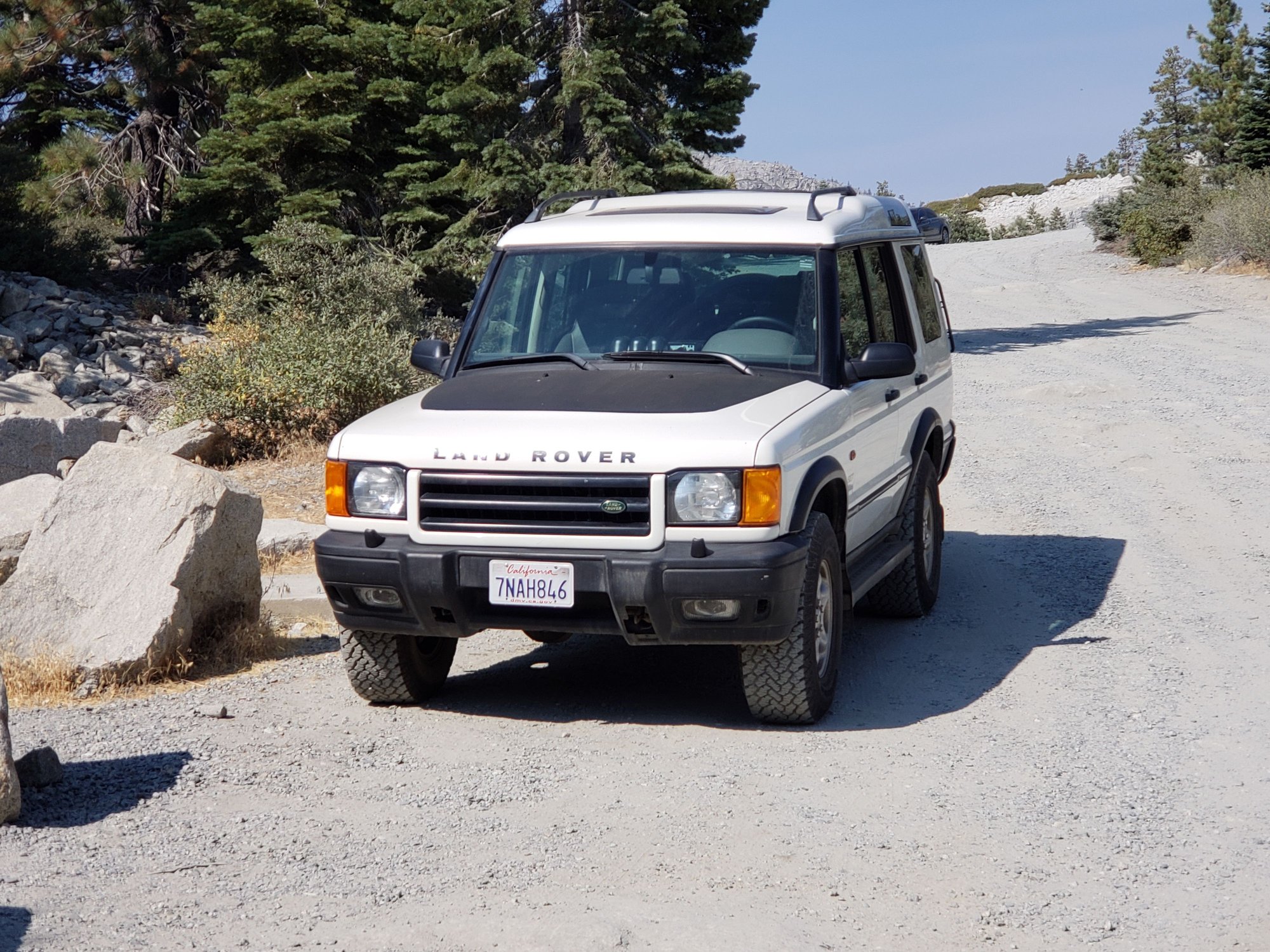

Done three trips with this truck. First was the Rubicon. Now to be clear, I didn't actually do the trail. Didn't have a second vehicle so it probably wasn't very smart to go solo. That's why I only went to the entrance. Planning a trip for this summer with some of my 4x4 buddies so hopefully Rubicon is a go this year.
Second was Pismo Dunes. This truck actually does really well in the dunes. Got stuck once, but was able to reverse out of it. Dunes are a ton of fun.
The third trip was also to the dunes. Just went last week actually. I got stuck again, but somehow it crawled out if it.
