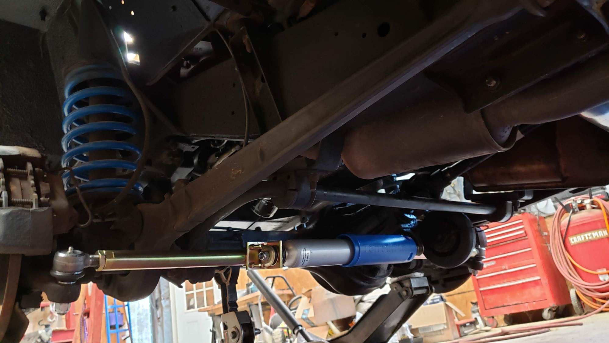

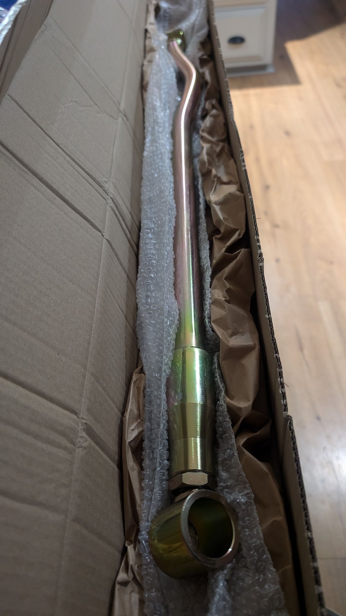

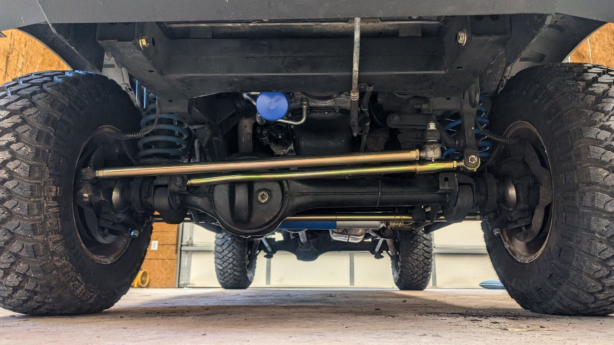

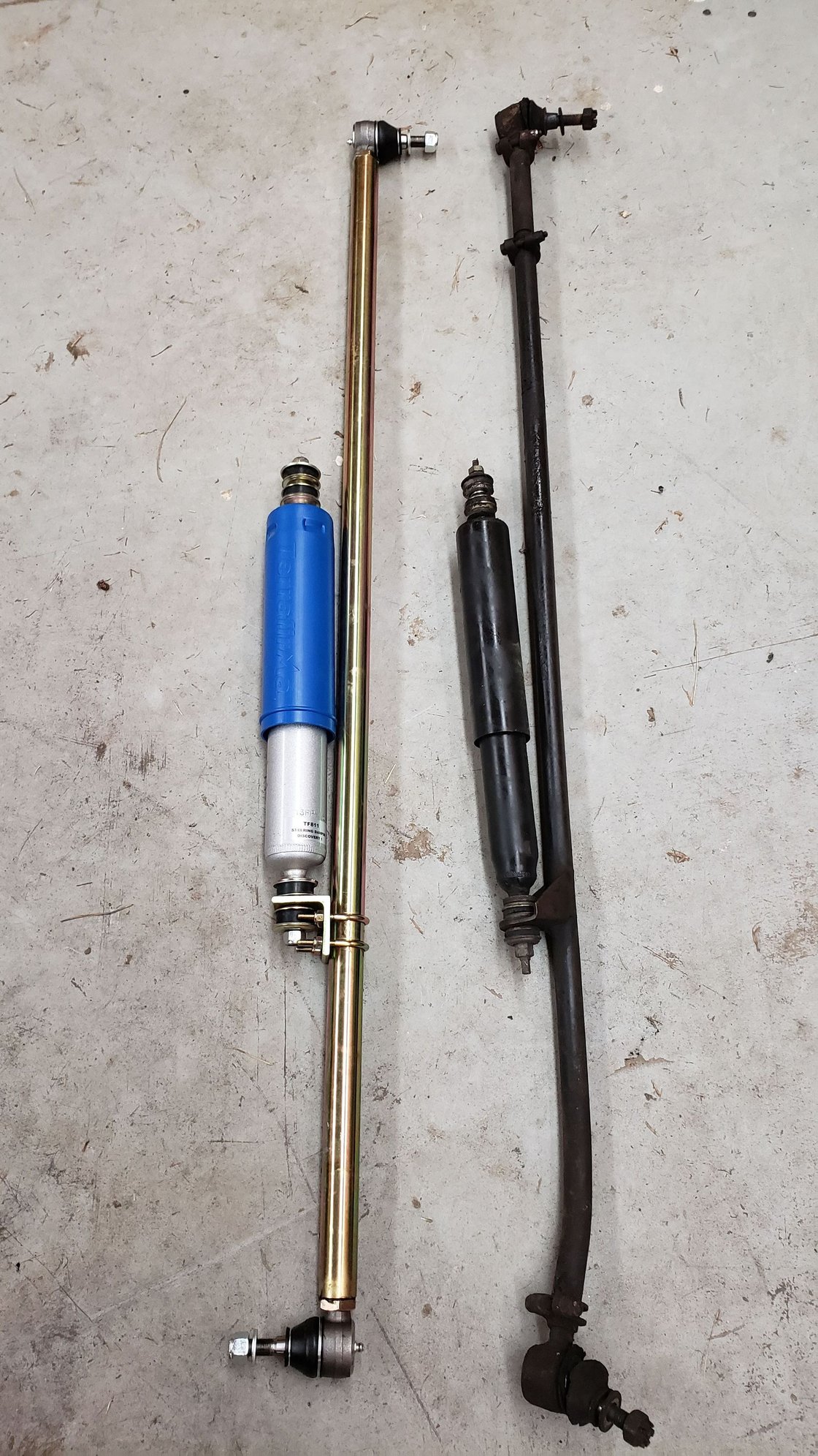

I've mentioned the loose steering on this truck... I think. If not, well, the steering was loose lol. I crawled under after driving it to look at the bushings in the radius arms because I knew they weren't great the first time we owned it. Found a bent track rod. This is a know weak spot on these trucks so a Terrafirma track rod and drag link assembly with steering stabilizer was ordered. Not the cause of the loose steering but if I'm replacing bad parts that are known to fail I'm gonna put the best replacement I can afford back on.

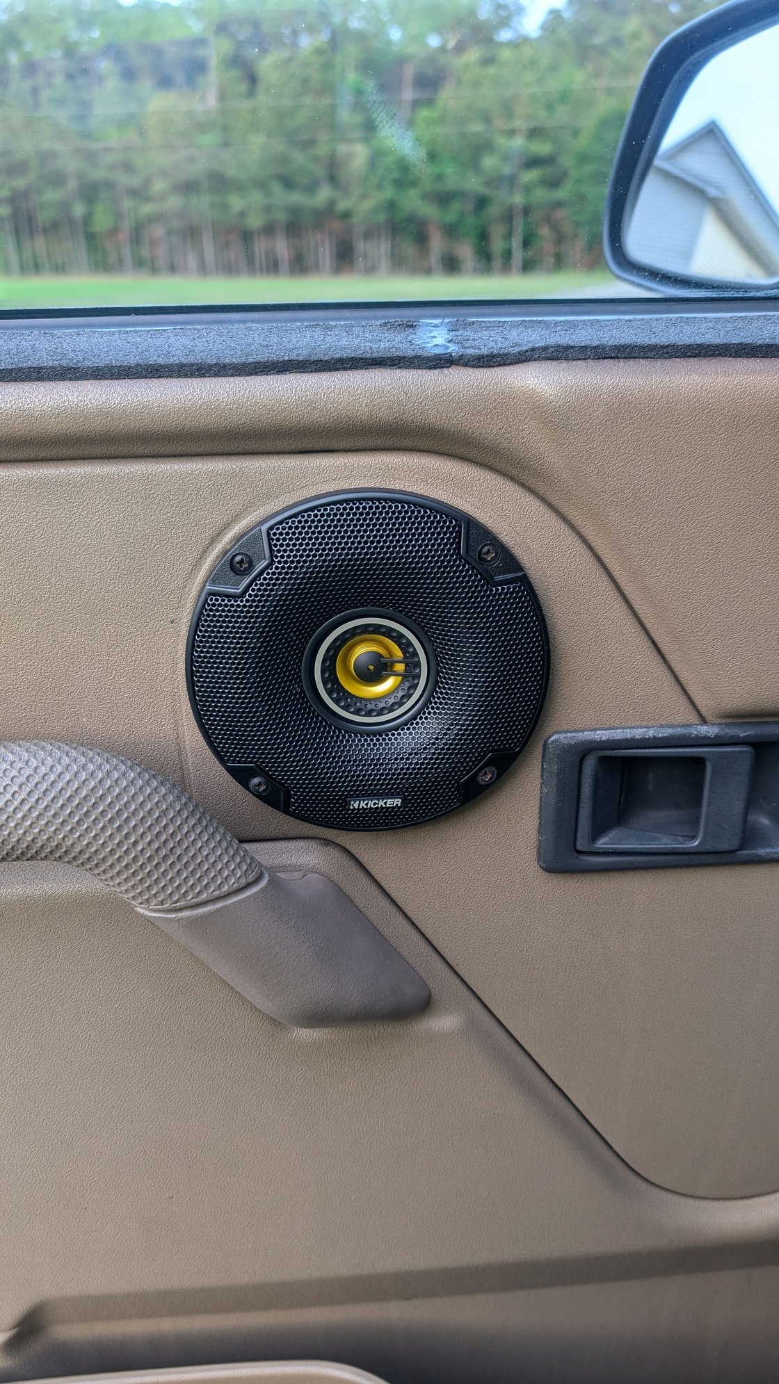

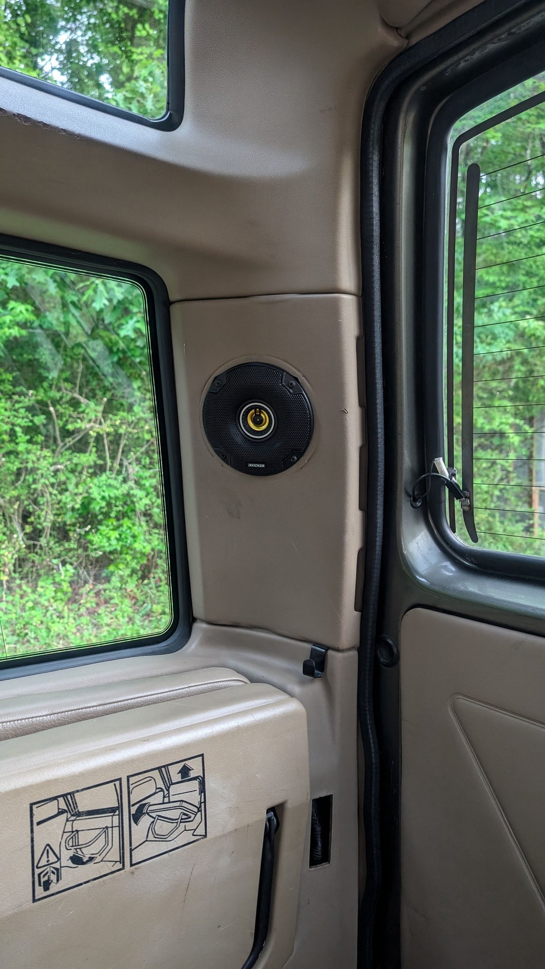

After the ladder I set about upgrading the factory speakers. Another member made a lengthy post about what he did and where he got the parts. I copied a lot of it. Went with a set of 4 4" Kicker speakers in the front doors and rear pillars. I got them from Crutchfield. Awesome website. You can enter you vehicle and it'll tell you everything they have that will fit. They also have pictures of the actual vehicle and how it all comes apart. I left the factory tweeters, and had already put a couple old Bazookas in the back door. They sound amazing. Not hard to improve on 28 year old blown factory paper speakers though.
The only thing I'll say about the installation is the original front speakers are supposed to have a trim ring behind them and mine were missing. The Kickers are deeper so they hit the door and pushed the door card out just a little. If I had the trim rings it'd be fine. I'm gonna have to figure out a solution to that but the rest of it was pretty straight forward.

Adding to the suspension overhaul, I picked up a Terrafirma HD panhard bar, sway bar bushings, and all new radius arm bushings. The sway bar bushings and panhard bar are done, the radius arms will have to wait for a free weekend which I haven't had in awhile. I'll update when I get to that.
