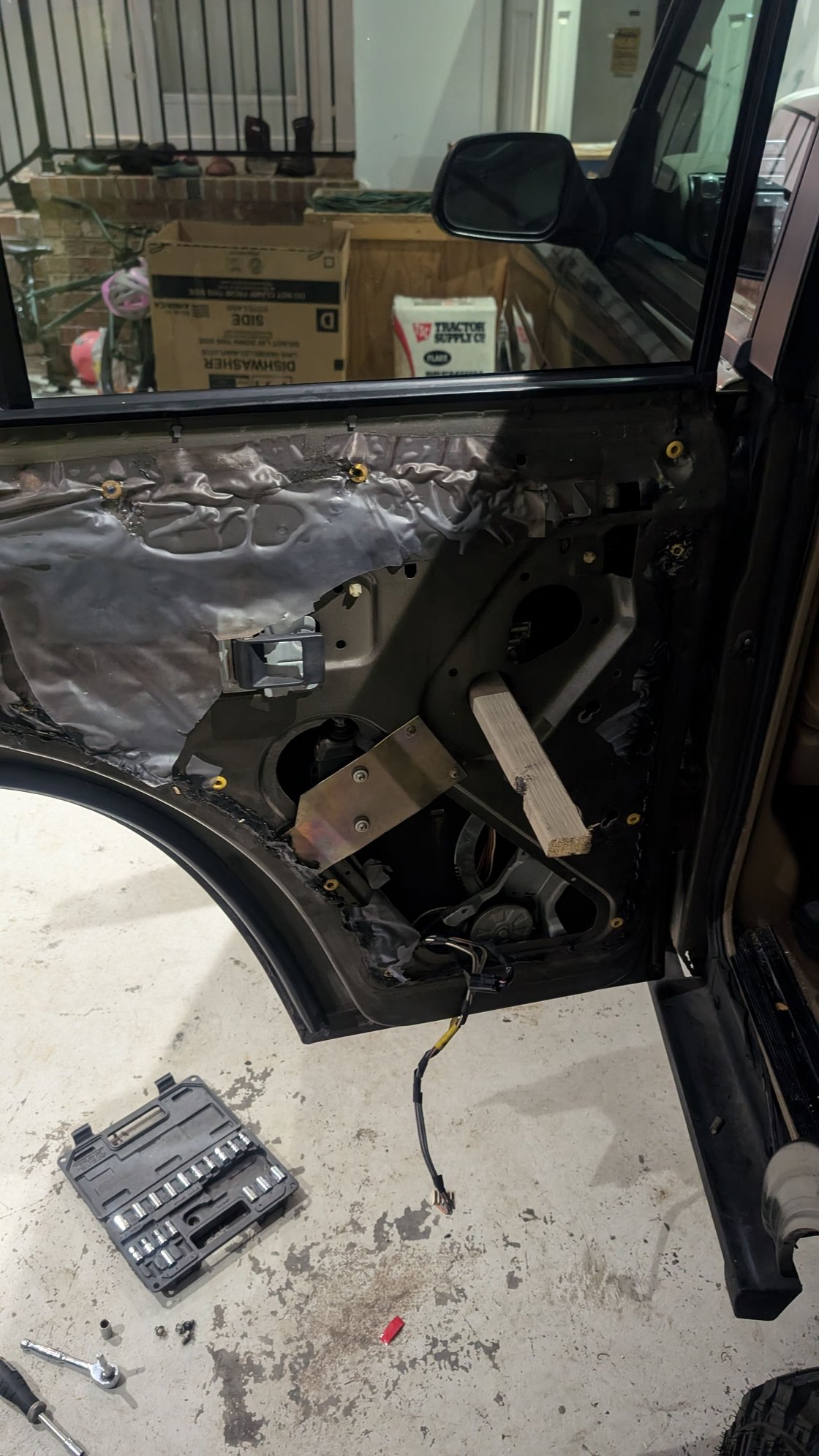

With the rain we've been having the last few days and the fact the Disco is parked in the garage as opposed to the barn lately I decided to dig into a couple minor issues this truck had when we bought it back.
First problem was the passenger front window would always go up but was really finicky to get it to go down. Believe it or not, there was a small spider smashed in the contacts! 😆
A good clean and she's good as new!
Second issue was the drivers rear door...which actually has 2 faults.
The first being the window didn't work at all from either switch, and the second being the door locks under power but doesn't completely unlock.
The lock is a simple adjustment issue but the window motor is fried. Pulled the motor out and took it apart and one of the carbon brushes is about gone. I ordered a new motor.
For what reason I don't know, I only took 1 picture, which is very unlike me. I usually take way too many and have to dig through them to find one I want to post.
