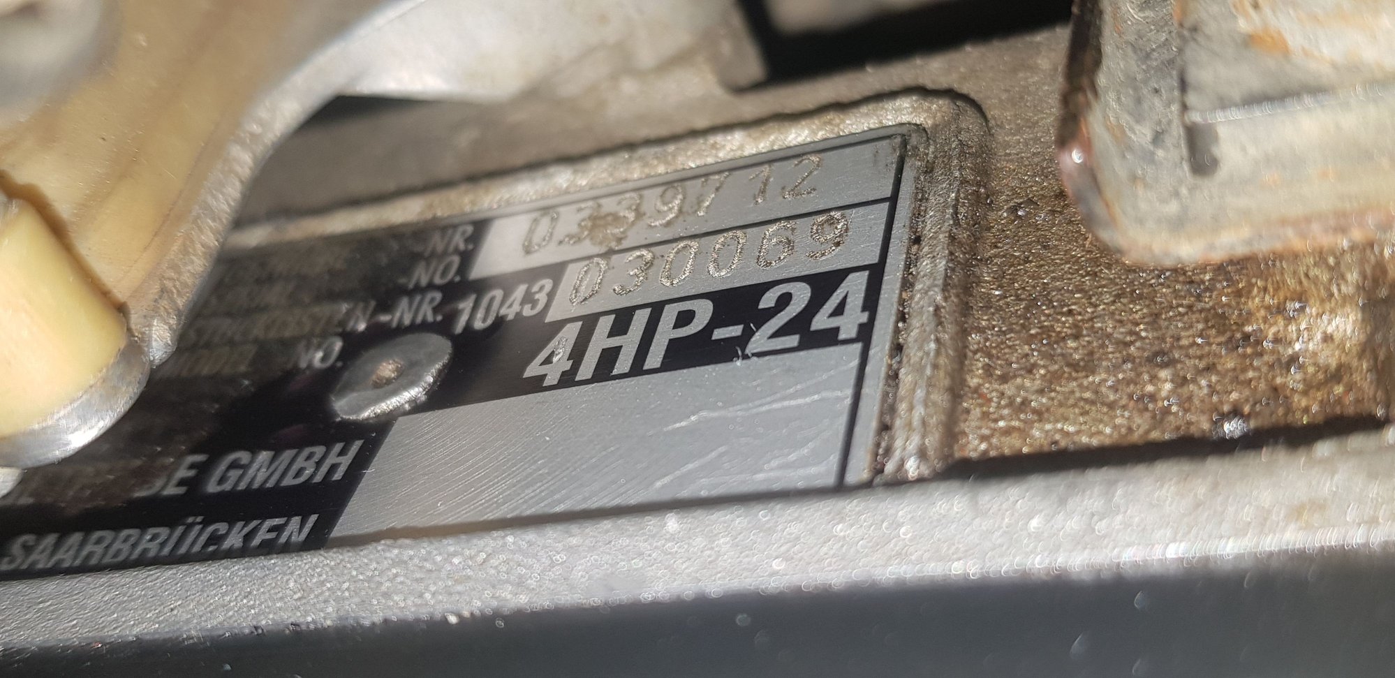

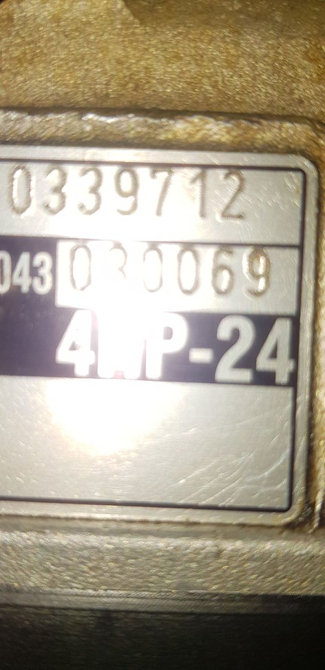

So I located the serial number on the transmission and sent Ashcroft the info. Unfortunately they do not stock this US specification transmission. My only option would be to ship my unit to their shop in England. So I went back to Amco Transmissions and they pretty much dont want anything to do with the ZF transmission. As mentioned before I did speak with Amco over the phone a month ago and they said these ZF transmissions are notorious for problems. They said they would not be able to give me any rough ballpark estimate until they pull the unit and disassemble it. The charge to tear it apart is only $100 but my concern was if they came back and said "to rebuild your transmission it will cost $4,000". So speaking to them in person assured me they are not the shop for the job. I did however find a transmission shop in Derry NH that is more than willing to do the job. They quoted me $1,400 for the labor to pull the transmission, rebuild and reinstall. But that does not include cost of parts and fluids. They went on to say they there are a couple different clutch kits available. A stock version, a performance kit and a high end kit for trucks that take a lot of abuse offroad. I'm leaning towards the stock kit. The shop went on to explain that they cant quote me on the kits yet until they shop around but that they would keep me in the loop about all my options. The rebuild would take them about a week. So I'm probably going to take this route.

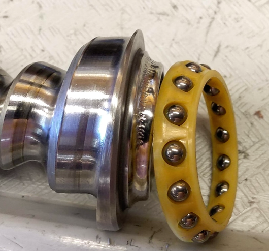

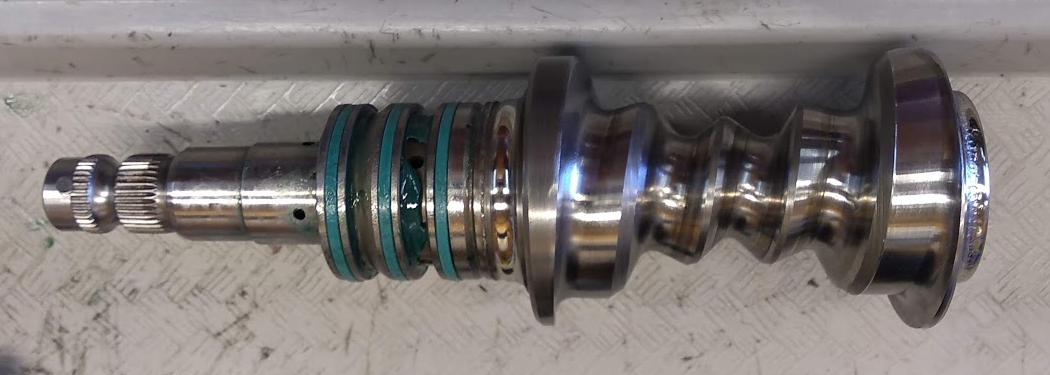

I also recieved my 2nd power steering gearbox from the power steering shop I've been dealing with. They sent me all the pics. The first gearbox they rebuilt for me was problematic because the green teflon seals included in the rebuild kit did not fit in place. They were too big so the shop had to improvise. So when I got the gearbox back from them and installed it I've had the constant whining noise. I contacted them and explained all the steps I took and the symptoms and they immediately explained what they believed to be the cause and offered to perform a second rebuild. I was not in a position to take my truck out of commission for the time it would take to ship out the box so I shipped them my spare gearbox. They rebuilt it but they found some corrosion on the inside that they warned me will result in premature wear of the seal. They gave me some options but I decided to have them continue the rebuild of the unit and send it back. Unfortunately due to the corrosion wear on the inside of the unit they wont be able to warrenty the box however.

That transmission shop that keeps bad talking a ZF Transmission must be talking about some other model. The HP22/HP24 is damn near bullet proof as far as 4spd Automatics go!! I’d still take my chances with a low mileage OEM used unit vs a unit a tech tore into and didn’t have a clue wth he was doing.

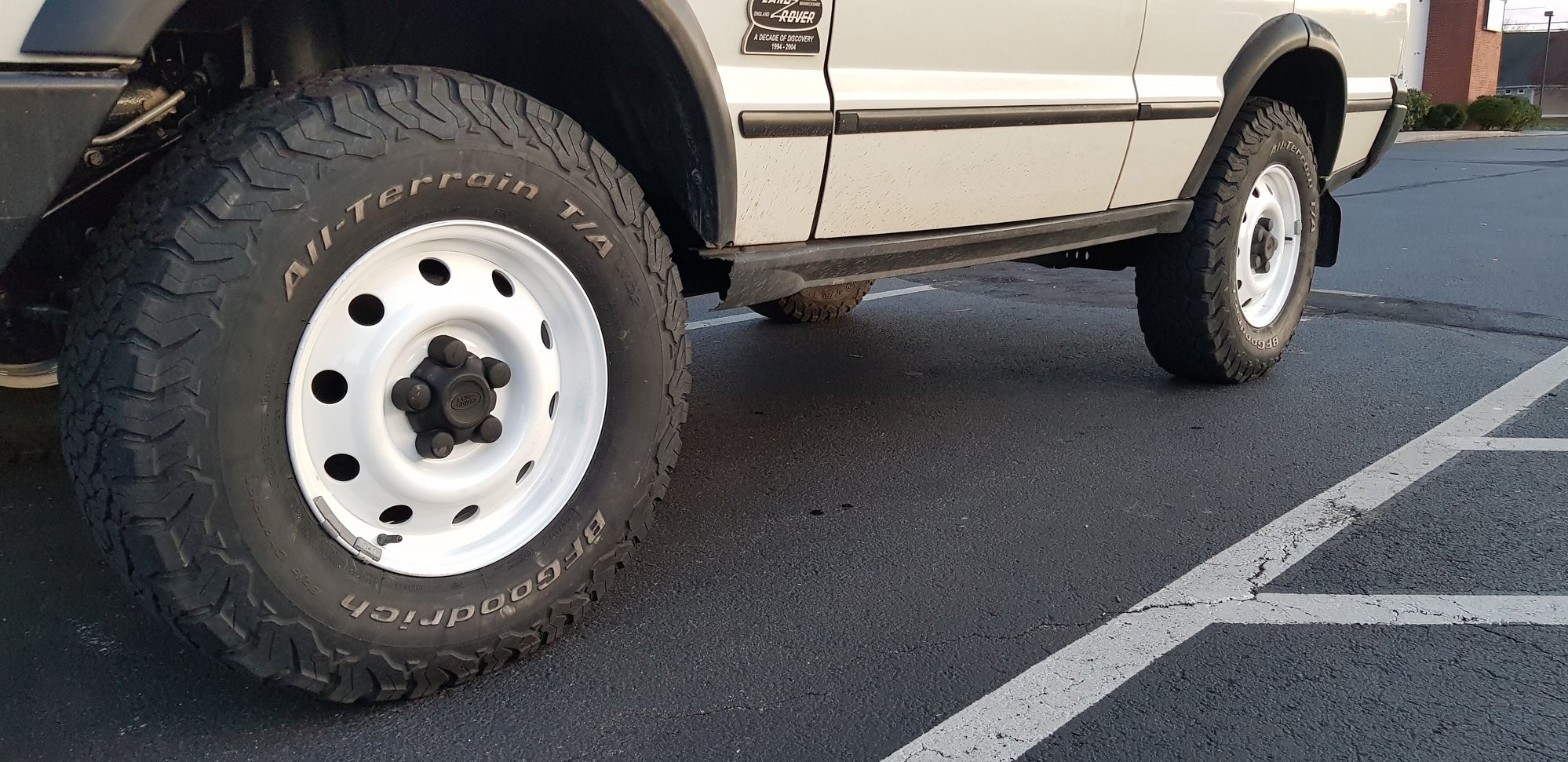

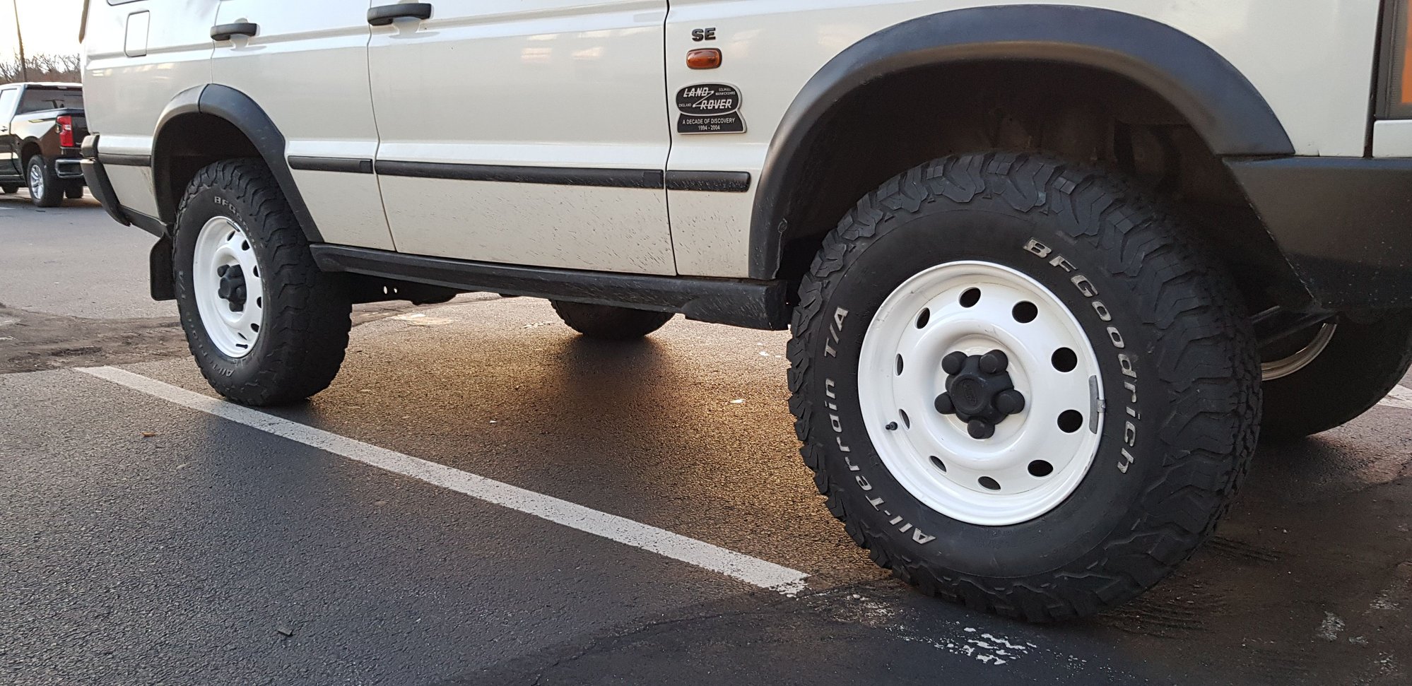

The transmission oil pump seal failed awhile back and since the transmission needed to be pulled in order to access and replace the oil pump seal, I opted for a full rebuild of the transmission. I asked the shop to first inspect the transmission in its entirety then decide on a rebuild kit best suited. I explained my desire to keep this truck running for indefinitely. The conclusion was that a master rebuild kit was needed and some of the sprags needed to be replaced as they were really worn. I requested that they replace the oil pump and the torque converter. They also needed to replace one of the mounts on the transfer case. Took the shop about 2.5 weeks to complete the job. Total charge was $2,385. $1,400 for labor and $985 for parts and fluids. After the transmission was rebuilt I brought my truck back to Town Fair Tire to have the rubbish Terrafirma steel wheels pulled and replaced with the Genuine LR steelies.
