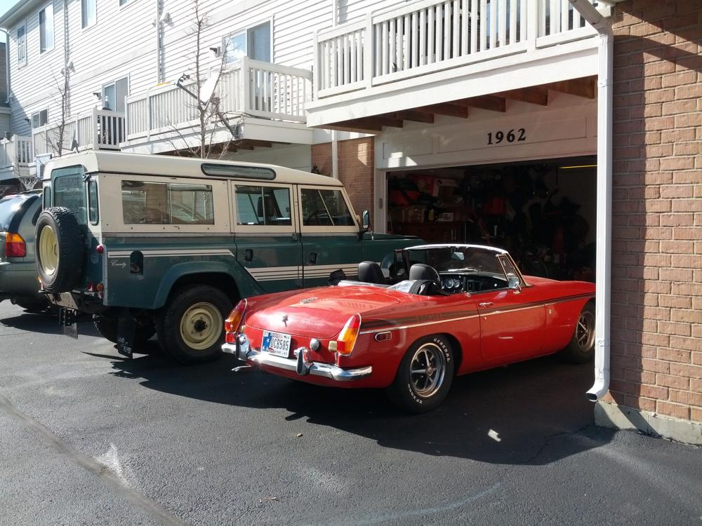

So finally got the driveshaft installed today. Did a few little jobs here and there and finally after 8 years I drove the MGB today. I forgot how much fun that little go cart is lol. I had the top down, and my wife thought I was crazy. It was 45 degrees and sunny I didn't see the problem.
It was funny seeing it next to the 110 in the driveway...
