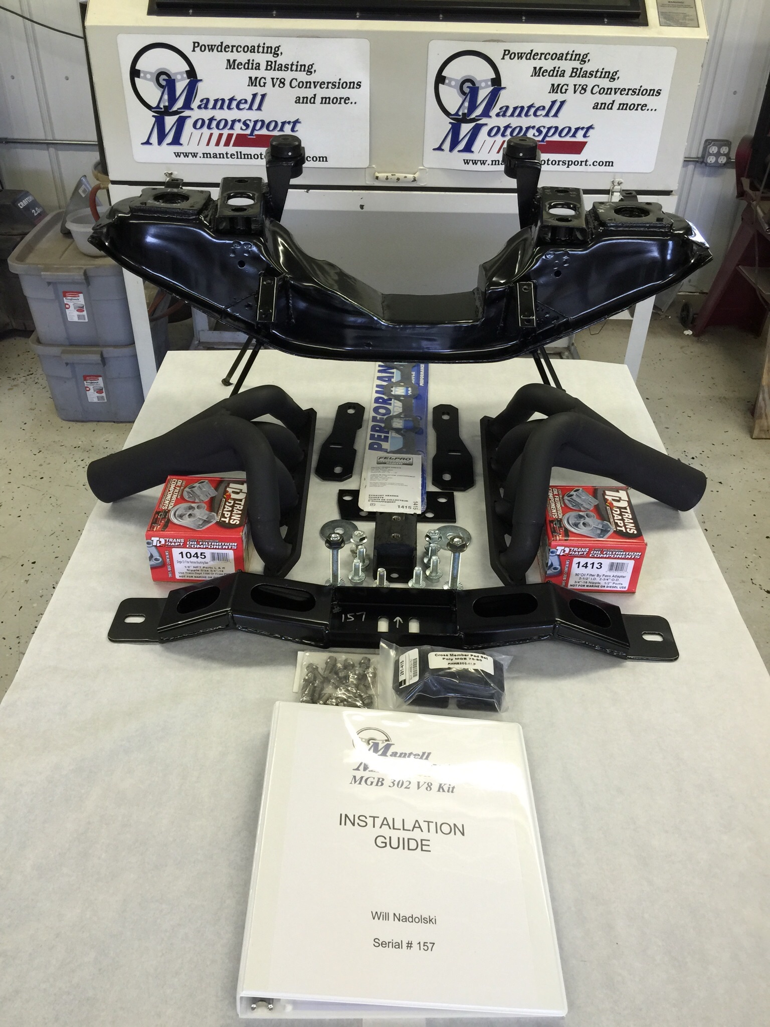

Well today was very productive I am on my way back now from Mantell motorsport with a shiny new 302 installation kit in the back my truck really excited to get started on it and a big thank you to Pete Mantell for keeping the shop open to let me come down and pick it up and a T-shirt.
Pete was also kind enough to give me a tour the shop and show me all the cool rides you had out there. Then he was even kinder and took me for a ride in his 347 stroker MGB

That is a very nice kit! Seeing that the tough stuff (engineered) is laid out the rest should be fun. Your gonna have one fast little scooter......
