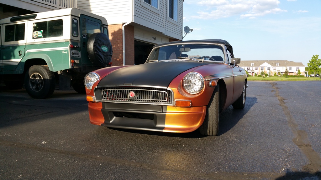

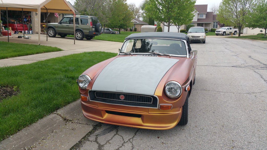

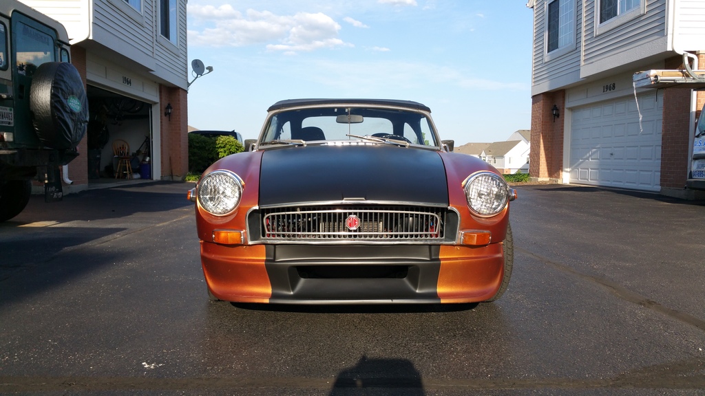

Yesterday I spent the day chasing my tail on the vibration. I inspected the front wheel bearings nothing wrong there, found worn brake pads so I did a quick brake job and kept hunting. Couldn't find any reason for the vibration, so for now I'm living with it.
So today I got a few free hours with nice weather so it was time to correct the primer gray hood. I didn't have enough leftover dip to do a color match. So I did some thinking and decided to take it from this....
To this....
Better pics will come tomorrow with a little luck. Another plus of this project is I got to try out my new spray system that I will be using on the 110. It was a drastic improvement over the old set up. It should produce some really great results on the 110 project.

Great idea that looks good .

I remember an RRC that kinda looked the same way.........
Man, the sun really makes that dip pop! Huge change from overcast.

Oh and thanks for the compliments She looks great in the sun, to bad it was overcast and raining all day today.
