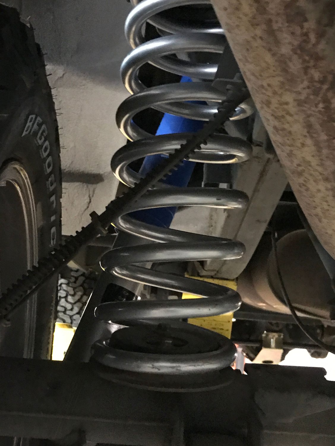

A couple updates. Painted the wheels and, got the 2 inch HD suspension, and steering damper on. Oh, and new rear bumper. Progress.
New Terrafirma HD
Rear Diff Guard
Painted Wheels
Steering Damper

Unless my eyes are F'd up, it looks like this Passenger Rear spring is on upside down. "Flat" goes on the top(like the other side).

Nope, your eyes are fine...saw it too...and thought what the heck. Plus those brake lines look like they are about to snap. Hopefully, it isn't going anywhere soon.

Ugh. Good catch, guys. I'll take a closer look. Thanks!

It looks like the shop installed the passenger front spring upside down too. Have a look at the video (start about 10:35) this is really a basic install.
And I know the suspension is hanging off a lift, but The Deputy is right get longer brake hoses.

Thanks! I sent a note to the shop with pictures. I also asked that we go ahead with longer brake lines. Where should I pick those brake lines up? Ideally braided ones. Might as wlll do it right :-) Maybe Atlantic British where I got the suspension kit?
