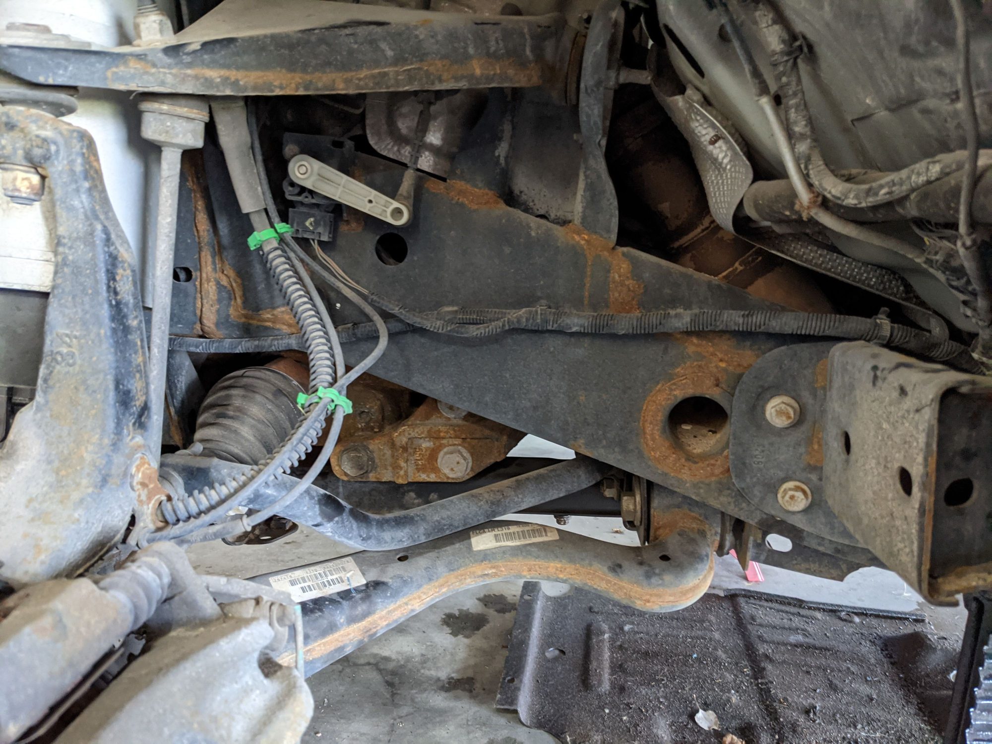

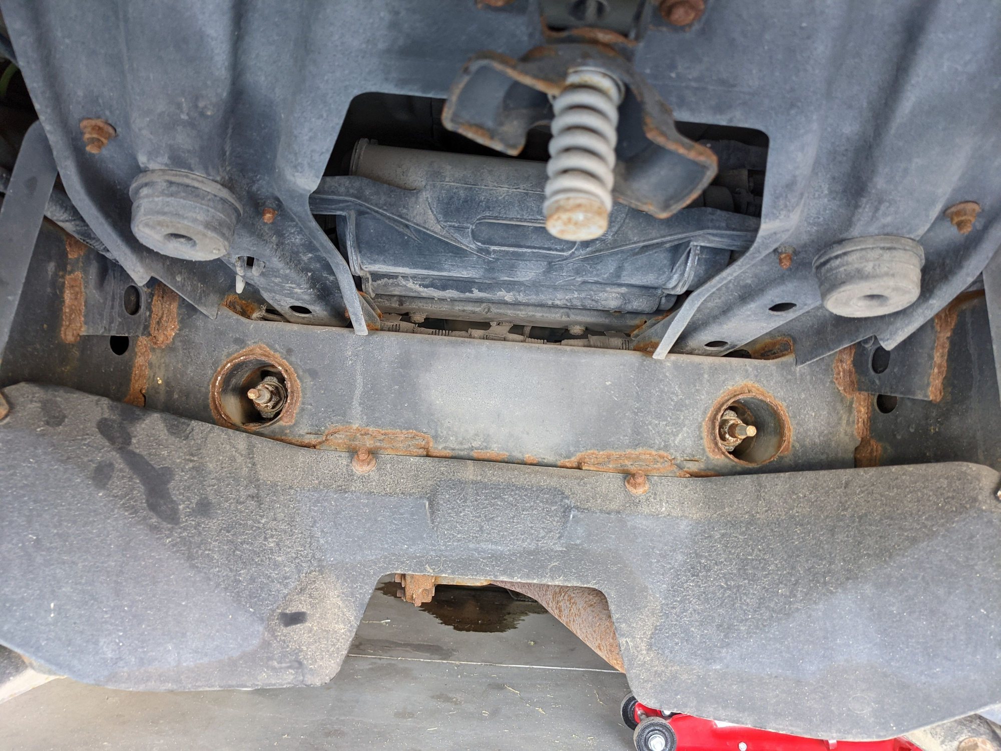

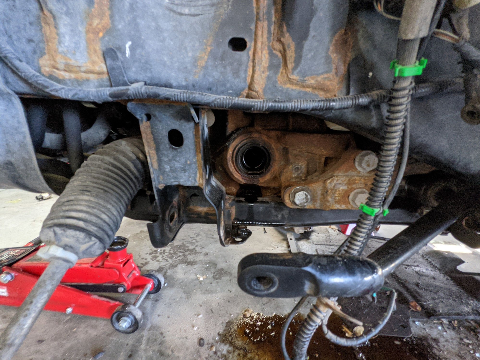

I have found more rust than I initially anticipated now that I have the LR3 on jack stands and have removed those awful aftermarket wheels. Here are some pictures, not including the front diff housing, which is the most rusted part of the entire vehicle.
This coming weekend I intend to do the following:
  1. Check the condition of the ball joints and tie rods.
  2. Remove the brake rotors, calipers, lower control arms, and possibly wheel hubs.
  3. Disconnect CV axles, front driveshaft, and drop the front diff.
  4. Figure out how I want to correct the rust issue.

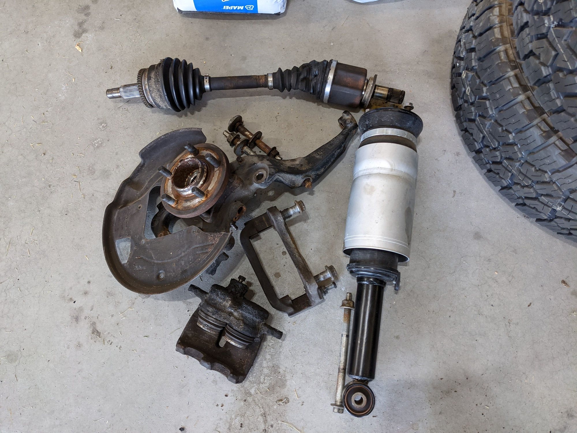

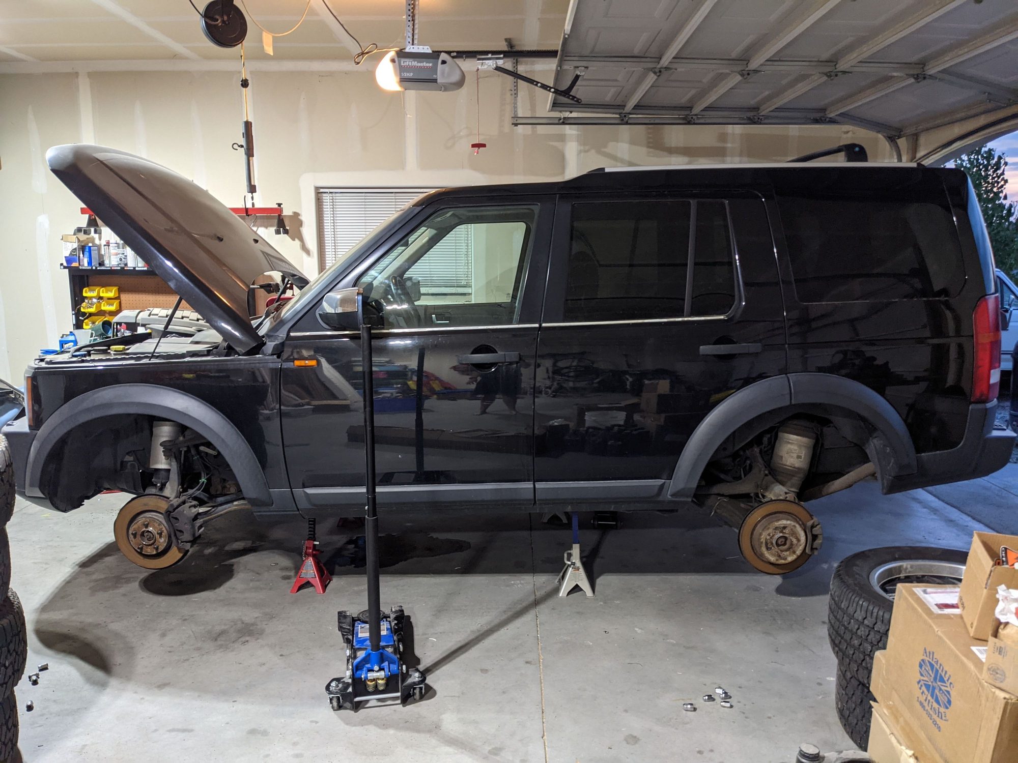

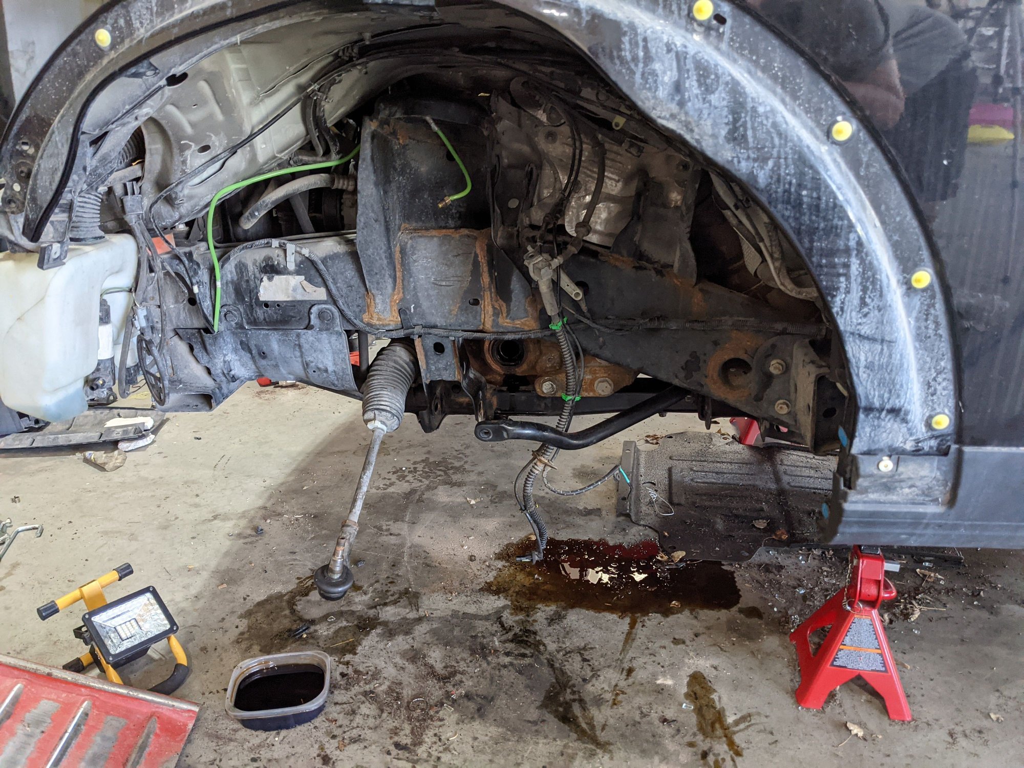

I was hoping to make more progress today than I did, but the lawn needed mowing and I wanted to spend some time with my kids. I got the control arms and axles out from both sides on the front, and made a huge mess doing it. I think the first corner (front driver's side) took the longest due to figuring out the best way to remove the ball joints and knuckle. I also made the mistake of removing the wheels prior to loosening the axle nuts. I had no idea those suckers were torqued so tight. I ended up putting the wheel back on so I could use a service ramp to chock it and stop the hub from spinning. Then I slipped a 36" cheater bar over my breaker bar to finally pop the nut off. It made a sound like a .22 rifle when it finally moved.
I wish I would have been able to drop the front diff today, but it's alright. I'll do it tomorrow. Here are some pics from today's work.
Just removing stuff for cleaning and in preparation for rust conversion and painting.
Pulled off everything but the tie rods.
The front diff is uniformly rusted, which is why I want to remove and resurface it.
These are the parts I'm cleaning up and keeping. The wheel hubs need cleaning, but the bearings are good, as are the CV axles. New upper and lower control arms, rotors, and pads incoming.

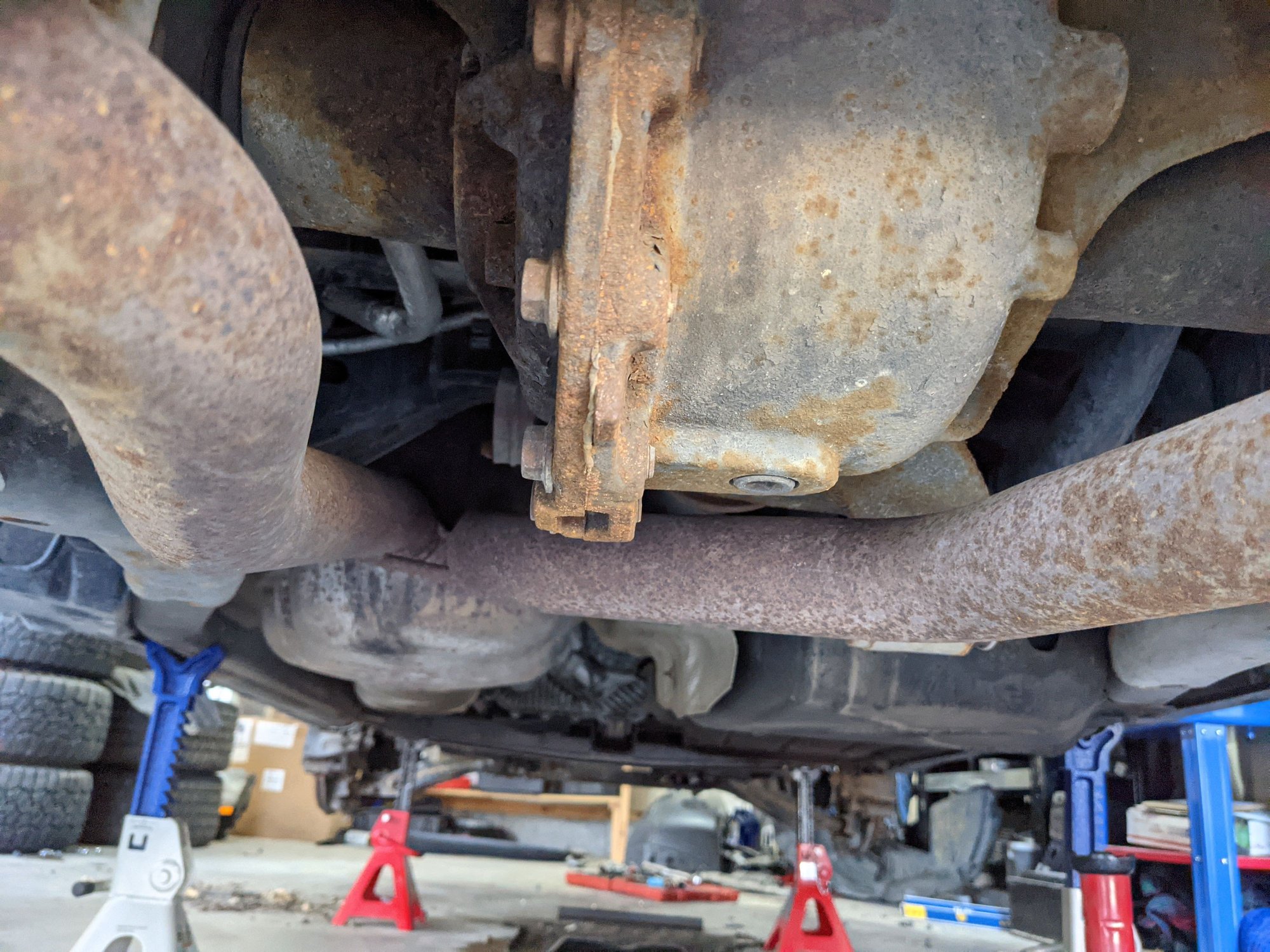

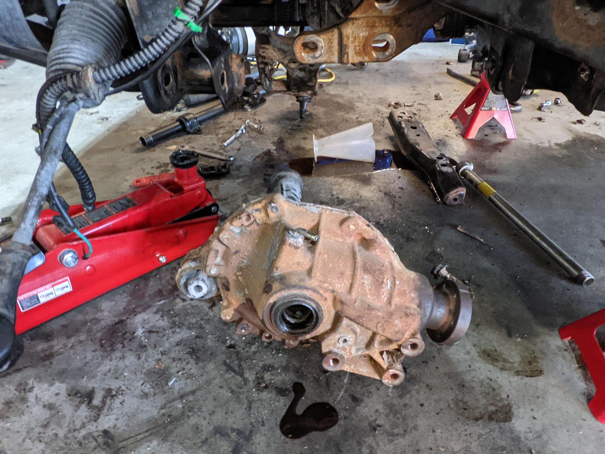

I took Sunday off and dropped the front diff today after work. It took about two hours longer than it should have because I couldn't figure out how to get an 18mm wrench on the driver's side upper sway bushing nut and turn it. I didn't have a shorty socket in that size, so I wasted a ton of time fiddling with both the nut itself and trying to work around it to unbolt the front driveshaft.
The stupid pills I evidently took this morning finally wore off and I undid the three big bolts at the rear of the diff mount and jacked the diff up enough to create clearance and allow me to pull the mount away on the bushing the millimeter I needed to slip a socket over the nut and get it off. After that undoing the E10 driveshaft bolts was easy, as was dropping the diff. Here it is in all its rusty, crusty glory.
Next step is to clean up all bolts, nuts, and washers to see which to reuse and which to replace. I need to figure out the pitch on some of the bigger (M12+) ones so I can pick up a tap and die to fit them. My set only goes up to M10.
Then it's on to tape off stuff, wire brush, rust convert, paint, and Cosmoline spray the frame as best I can. I'm debating whether to drop the exhaust from the cats back for better coverage. But then I'd be tempted to take it to a muffler shop and cut off the big turtle shell resonator.
