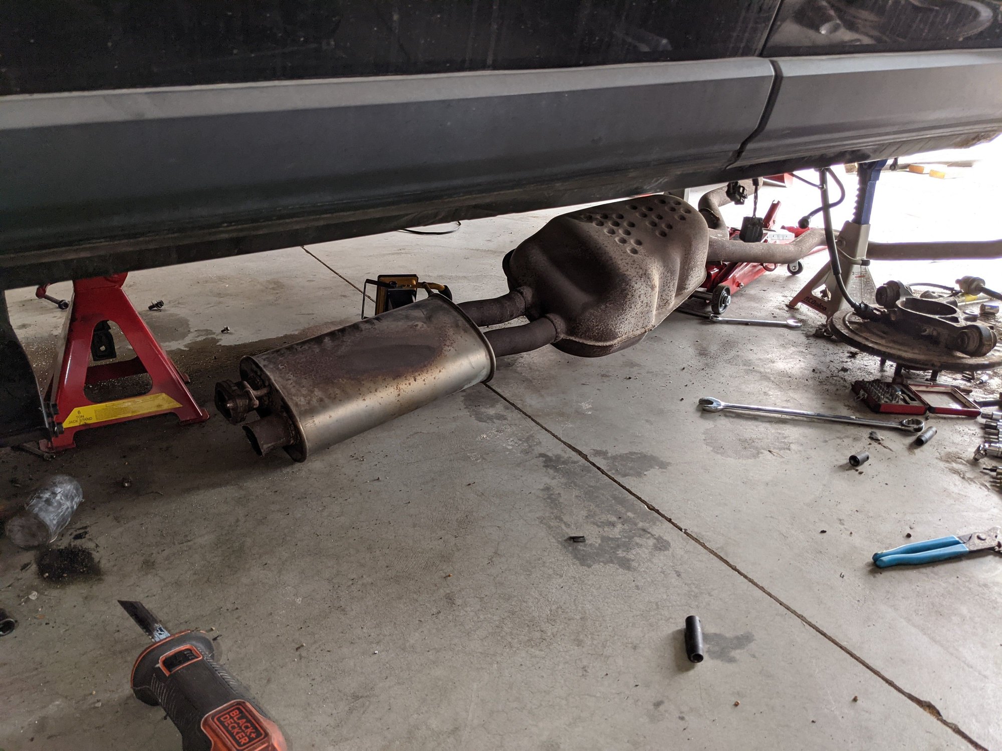

The going is slow. I need to drop the rear diff, but the exhaust is in the way. I tried to unbolt it just before the muffler, but the nuts on the flange and the band of the butt joint clamp were corroded to the point of being fused together. Nothing the sawzall couldn't fix.
I really hate rust. The mild corrosion on my LR3 is making the dismantling process go so much slower than I initially expected. Lemons to lemonade, though. I'll just use this newest setback to install an x pipe where I cut off the exhaust, then reattach the muffler behind it, deleting the big "turtle shell" resonator at the same time. I intend to use clamps instead of welding it on. The primary determining factor behind that decision is that I don't own a welder and don't know how to weld (yet!), but secondary to that is the restriction of access to components in the rear drivetrain caused by the exhaust. I want to be able to remove it in sections.
Checking my spreadsheet, I am now over the $5600 mark for this project. I'm hoping to make back $500 or so by selling the ugly 20" wheels and tires I bought with the vehicle. I'll also sell my F-150 when the LR3 is right and reliable. That will hopefully net me another $2000, so this rig should still end up being a bargain for its capability and utility. Even if I don't sell those things, I figure I'll come in about $6000 when it's all said and done, but then I'll have a 2006 LR3 V8 with 155k miles that is rust repaired with new control arms, links, bushings, brakes, freshly serviced transmission, t-case, diffs, center support bearing, cleaned fuel system, and fresh coolant and oil. That's pretty good, IMO.
